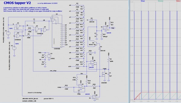

Subject description: 3 chip Lunetta metronome without microcontroller
in times of 50cent 8 pin microcontrollers this circuit comes really 40 years too late. But hey, if you try to repair a defective ATTINY tapper in 10 years, you will be in deep sh*t with your present win10 toolchain Wink
This circuit works well in simulation. I designed it just for fun, but would like to hear about if someone will build it.
how it works:
the circuit has a digital ramp generator - CD4040 with R2R DAC clocked by start/stop oscillator U4,5 - and an analog ramp generator around C2.
Both oscillators are controlled by state flip flop U1,3. 2 momentary push switches TAP1,2 are used to tap in tempo.
1st state starts with hitting TAP1 :
DAC voltage restarts @ 0V and, by count-on/off control from comparator U6, then tracks the analog ramp.
BTW: ramp voltage does not rise linear (RC charge), so because DAC voltage tracks ramp, it is also nonlinear. This has no effect on tap tempo !
2nd state begins by hitting TAP2 :
4040 clock is stopped and DAC voltage freezes. This, now constant, voltage will be used as upper threshold for the analog ramp generator :
C2 is reset, whenever ramp voltage reaches the stored DAC voltage. Thus all consecutive ramps will have the exact shape (within 1 DAC step)
and timing as the first ramp between TAP1 and TAP2 time.

I haven't really studied the circuit yet but that R2R is unfeasible in practise. Resistors simply won't be accurate enough
(or they get very expensive). You might get to 6 bits or even 8 but I doubt you'll be able to get much more than that.
You could use a precision DAC if you can find a suitable one.

... that R2R is unfeasible in practise...
I would agree if this would be a "linear DAC" application like audio DAC or precision voltage generation.
But in this app. DAC linearity is not so important, because the DAC is in a feedback loop with the comparator. Probably 0.1% 0805 resistors (15 cent/pcs.) are already an overkill, some DMM selected 1% Rs will do the job. But a resolution of 11 bit is required if we want a 30..250BPM range with 1BPM resolution :
between 250 and 251 BPM there is a difference of about 1ms. 30BPM equals 2s which is about 2**11 * 1ms.
Ah I see what you mean, yeah than it is a bit less important. Although I don't understand the circuit 100% yet (might have to do with M1)
I do get the gist of it. Nice idea to do it this way. I have thought about a tap circuit before but hadn't thought about doing it somewhat analog.
edit: actually I might get it now. I was looking at U7 as being an integrator (because of C3) producing the ramp voltage but it isn't is it ?

.. I was looking at U7 as being an integrator (because of C3) producing the ramp voltage but it isn't is it ?
U7 is only a comparator( with a small capacitive hysteresis). It compares the frozen ramp peak value from the measurement cycle ( time between last TAP1 and TAP2) with the analog ramp (C2 charged by R3). when this old peak value is reached again, C2 is discharged by M1. cycles with same timing follow, until a new DAC value is produced by a fresh TAP1,TAP2 cycle.
A digital solution, e.g. with 2 counters and magnitude comparators is possible, but not with 3 chips

I don't think I've seen a capacitor being used to add hysteresis before.
Counters and magnitude comparators was indeed the direction I was thinking.
For the resistors I wonder if it is worth while to use arrays of 1 value and either use 150K with 2 in parallel for 75K (probably easiest)
or 75K and 2 in series for 150K. I guess with this amount of resistors you might as well get the values seperate.
I bet you have Wink all saw core VCOs use this to generate a constant width reset pulse (to make sure C discharge is complete)
re. resistor pairs: 150k+75k or 200k+100k are standard E24 values.
