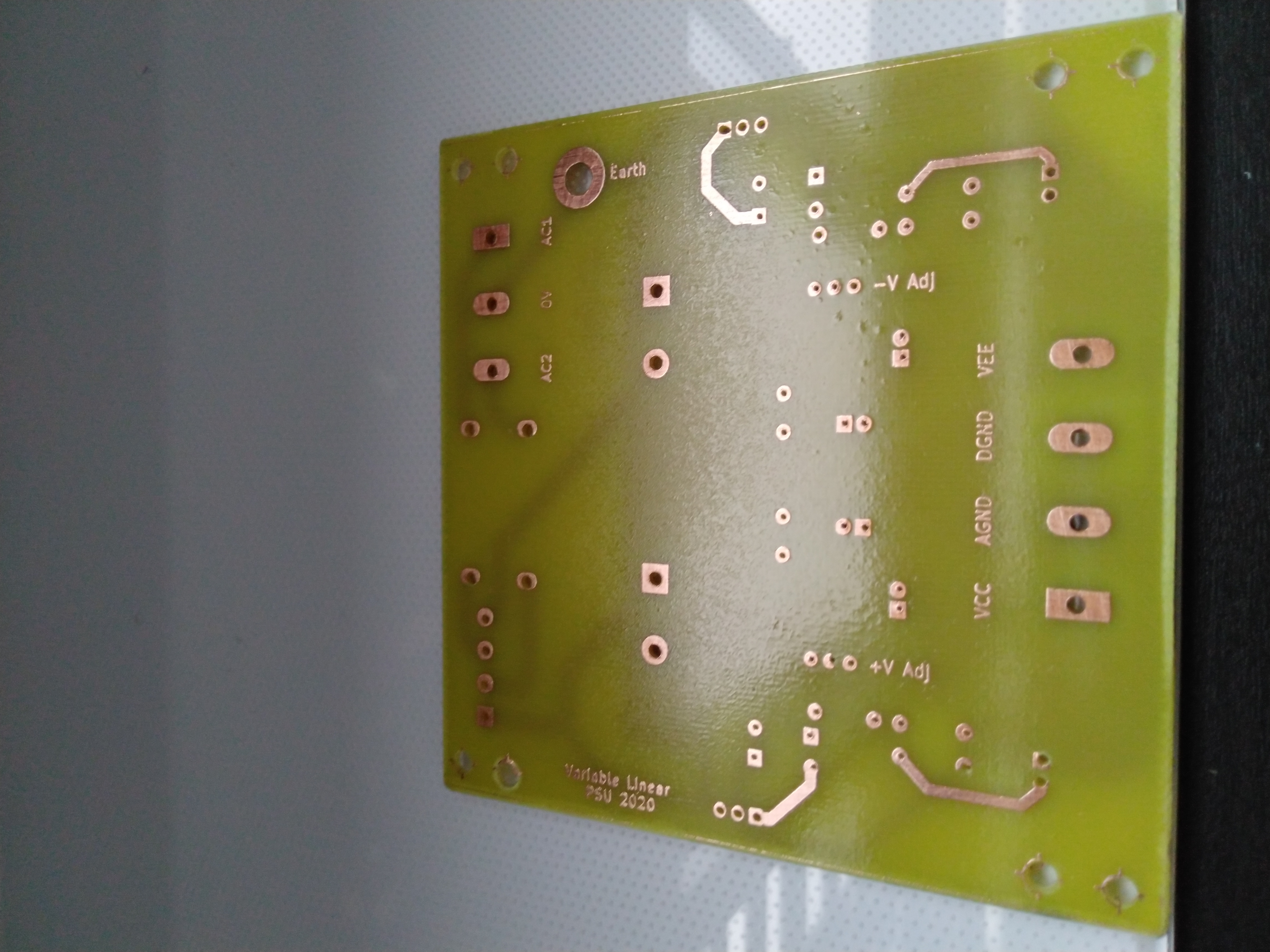

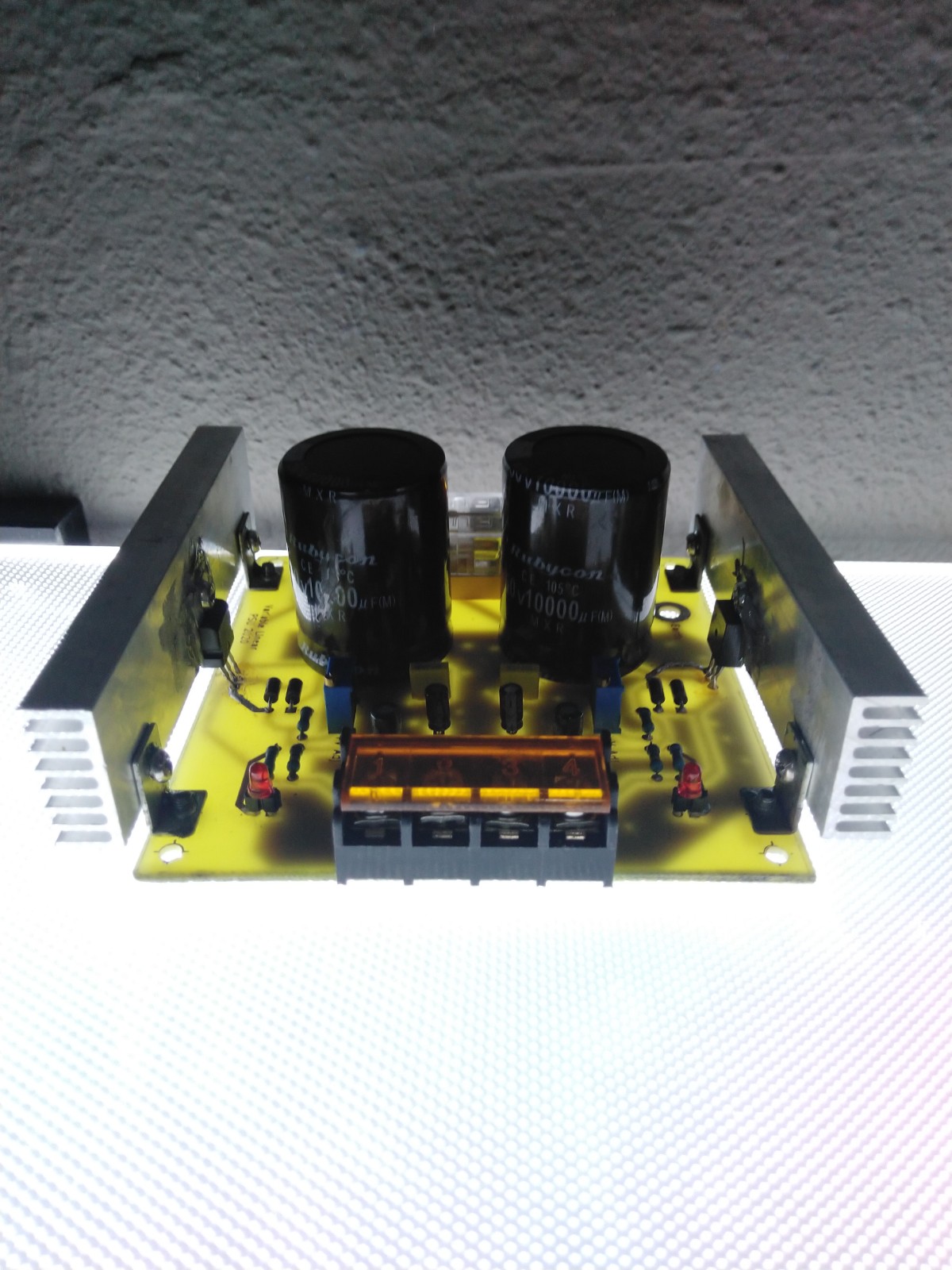

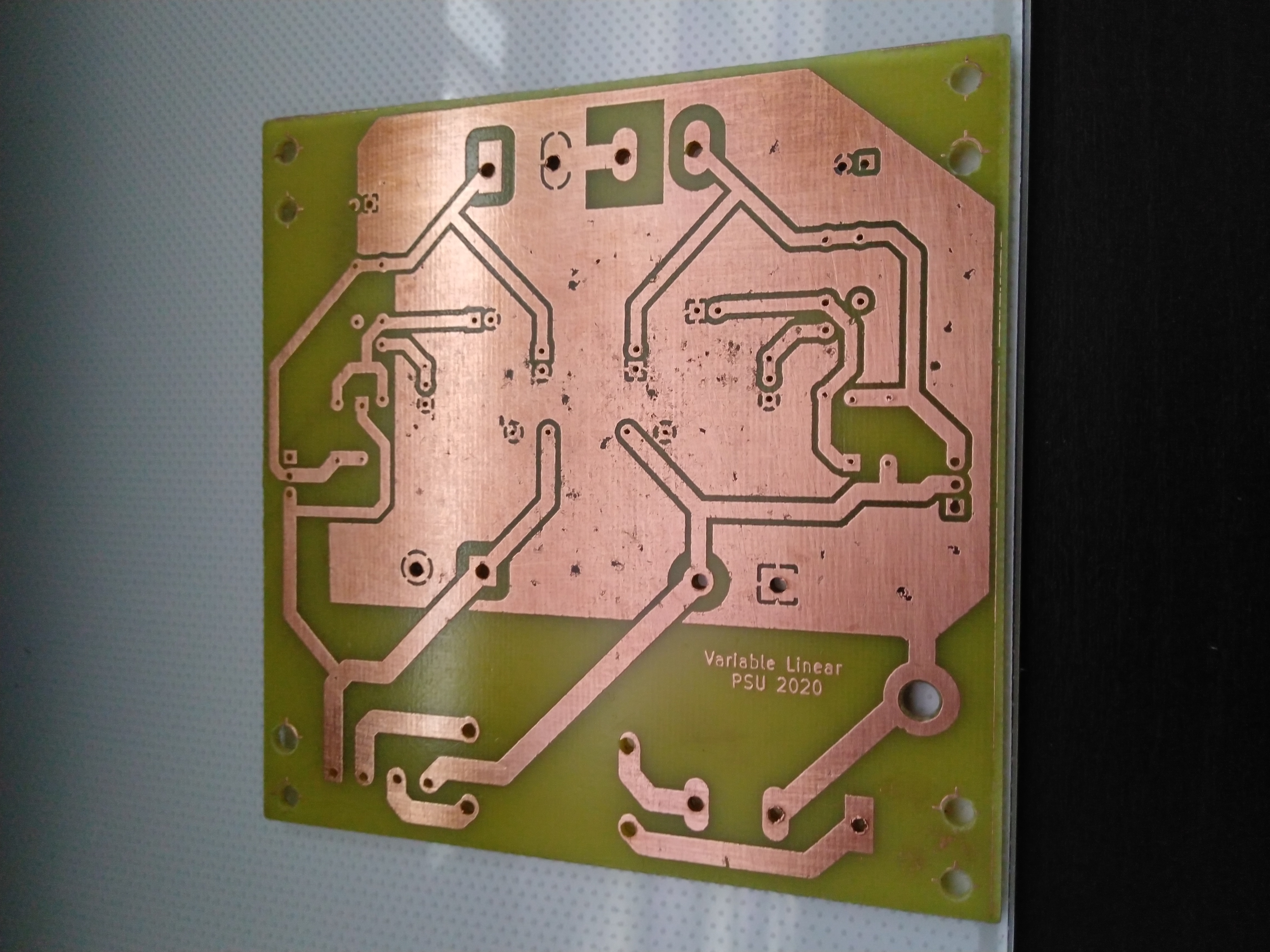

I recently built a power supply based on the MFOS adjustable PSU.
After designing and etching the board, i am experiencing voltage drop of a whopping 600mV (12.4V to 11.8V) under load.The load is a 20 Ohm 10W cement power resistor which drew about 500mA.
I fucked up initially by testing without heatsinks and then to be safe i replaced both regulators and tested with heatsinks installed. The heatsinks were salvaged from broken KRK monitors, which are hefty and dissipated the heat well enough.
The transformer is rated at 36VA CT 15-0-15V.
Input voltage is about 20-21V which ensures there is enough headroom.
So what issues could be causing this significant loss in voltage?

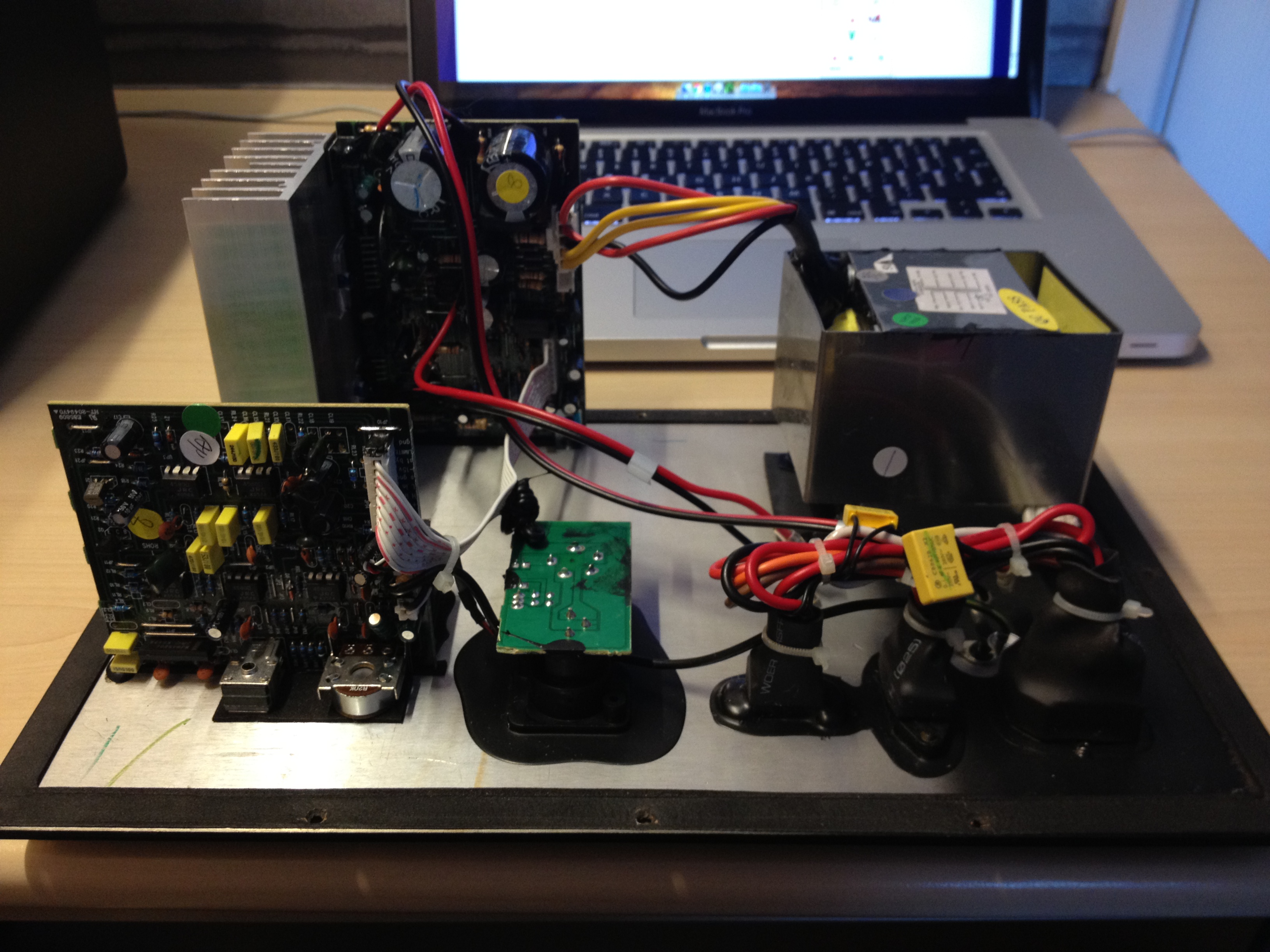

PostPosted: Sun May 31, 2020 7:05 pm    Post subject: Reply with quote  Mark this post and the followings unread
Gingoism wrote:
Hi Phobos, yes on the faulty PSU board the input voltage did drop to about 3-4V, so it hovered around 17-18V. With that said the breadboard circuit is relatively stable up to about 890mA but as you can see under a 1A load i lose about 800mv and input voltage drops from 20V to 17V is that normal for a LM317/337 regulator? I know they can handle up to 1.5A correct?
as for heatsinks i tried 2 different ones. see attached pics
heatsink from krk monitor is about 110cm(L)x60(W)x60(H)
the size of the mosfet heatsink is 42mm(L)×35mm(W)×25.4mm(H)

Posts: 5898
PostPosted: Tue Jun 02, 2020 6:56 am    Post subject: Reply with quote  Mark this post and the followings unread
just checked the schematic (was that here all along, did I check it before ?!) where did you get the idea of putting a diode between the
output and the adjust input ? There should be a resistor there (240 ohms) or is that only missing in the schematic ?
as for heatsinks as long as you can still touch it without burning your fingers it's ok. If you touch it with a wet finger and it sizzles it's getting too hot.
(note: they can get VERY hot).
Breadboards are probably not the best way to test a supply under load. You need solid connections and also wire gauge can make a difference.

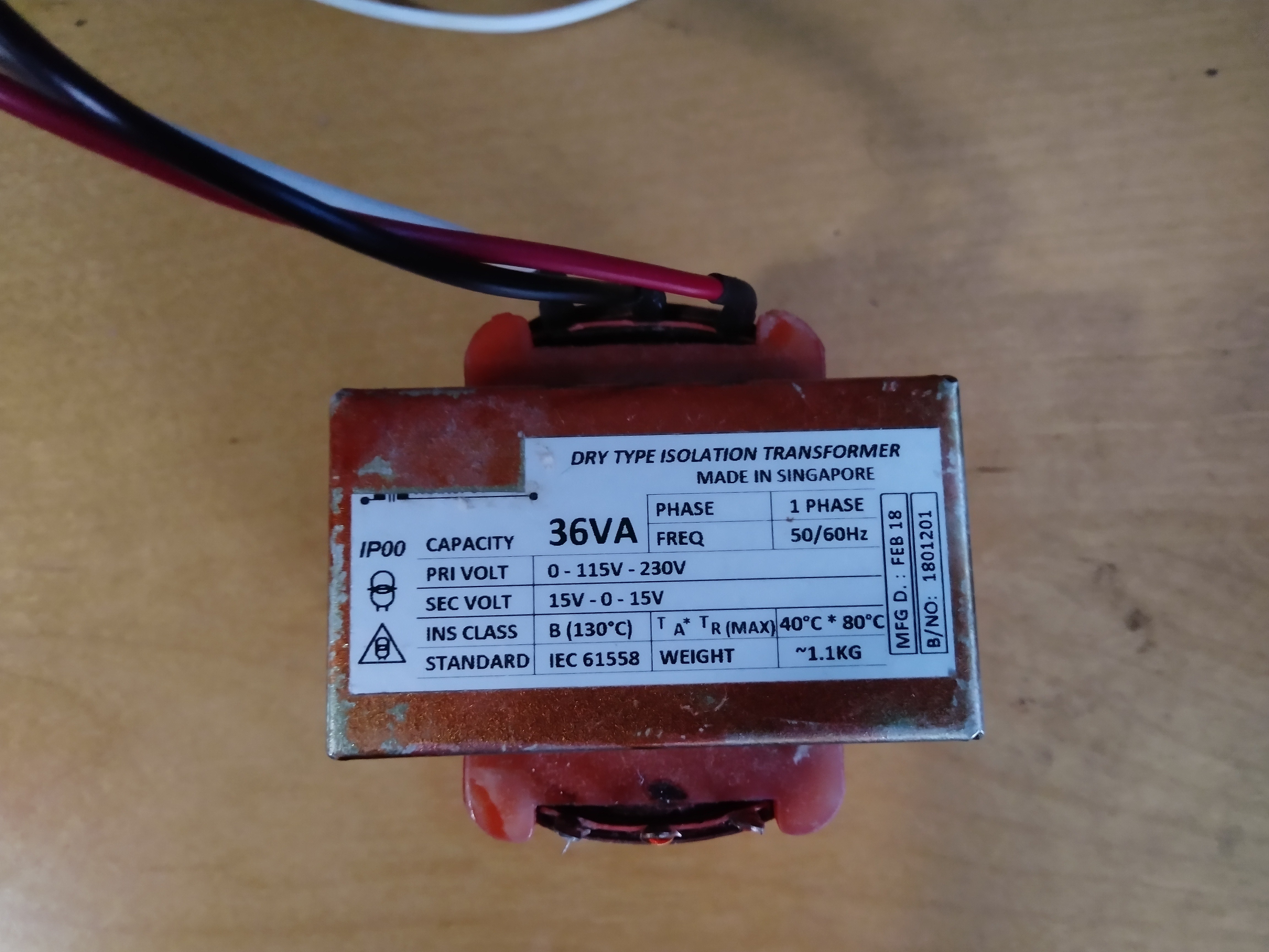

PostPosted: Tue Jun 02, 2020 6:17 pm    Post subject: Reply with quote  Mark this post and the followings unread
gabbagabi wrote:
by just fishing in the dark, i would risk to consider that may transformer is not "strong" enough
Hi gabba,
That was my initial thought then i tried a a different transformer from that pictured below. this one was 40VA and i got similar results..

you are right phobos, the schematic above is wrong and was edited after the 1st iteration.
the circuit is basically from the datasheet
i simulated the circuit in spice and i was stumped by the results..the circuit performed as expected until i changed the load to 10 ohms and below, the voltage dropped from 12.5V to 10V and the load current flat lined at about 1A and remained the same even when i increased the input voltage to 40V...so im not sure what to make of this. has anyone made a lm3XX PSU with an excess of 1.5A?

gabbagabi
Joined: Nov 29, 2008
Posts: 652
Location: Berlin by n8
PostPosted: Wed Jun 03, 2020 1:25 am    Post subject: Reply with quote  Mark this post and the followings unread
ok i was thinking this:
10 Ohm mean 1,5Amp
your transformer is rated 2x15VA 36W
from my experience that means each side of the transformer is rated 18W.
that means because of RMS and 0,707, you could write the rating as 2x (21,21V @18W)
if you draw now 1,5A out of one --> u are well beyond the power rating
in my opinion u are reaching the theoretical limits if u draw 0,85A Shocked

PostPosted: Wed Jun 03, 2020 3:55 am    Post subject: Reply with quote  Mark this post and the followings unread
yes gabba that makes sense in theory and also in practice...
explains why it was stable up to the point when the load current was around 0.8-0.9A.
Which now i think is pushing it too much and probably would perform much better with full load at 0.6-0.7A.

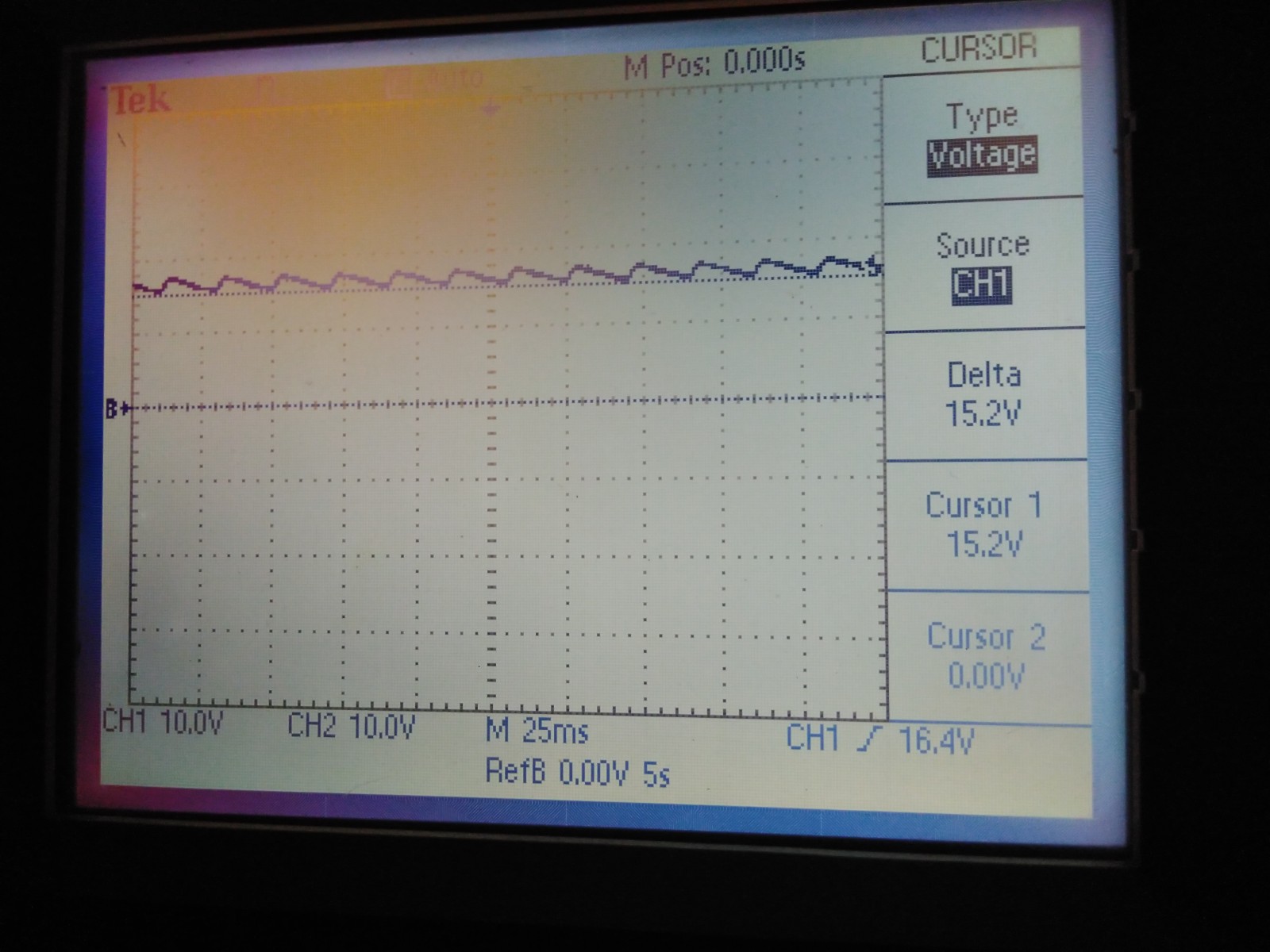

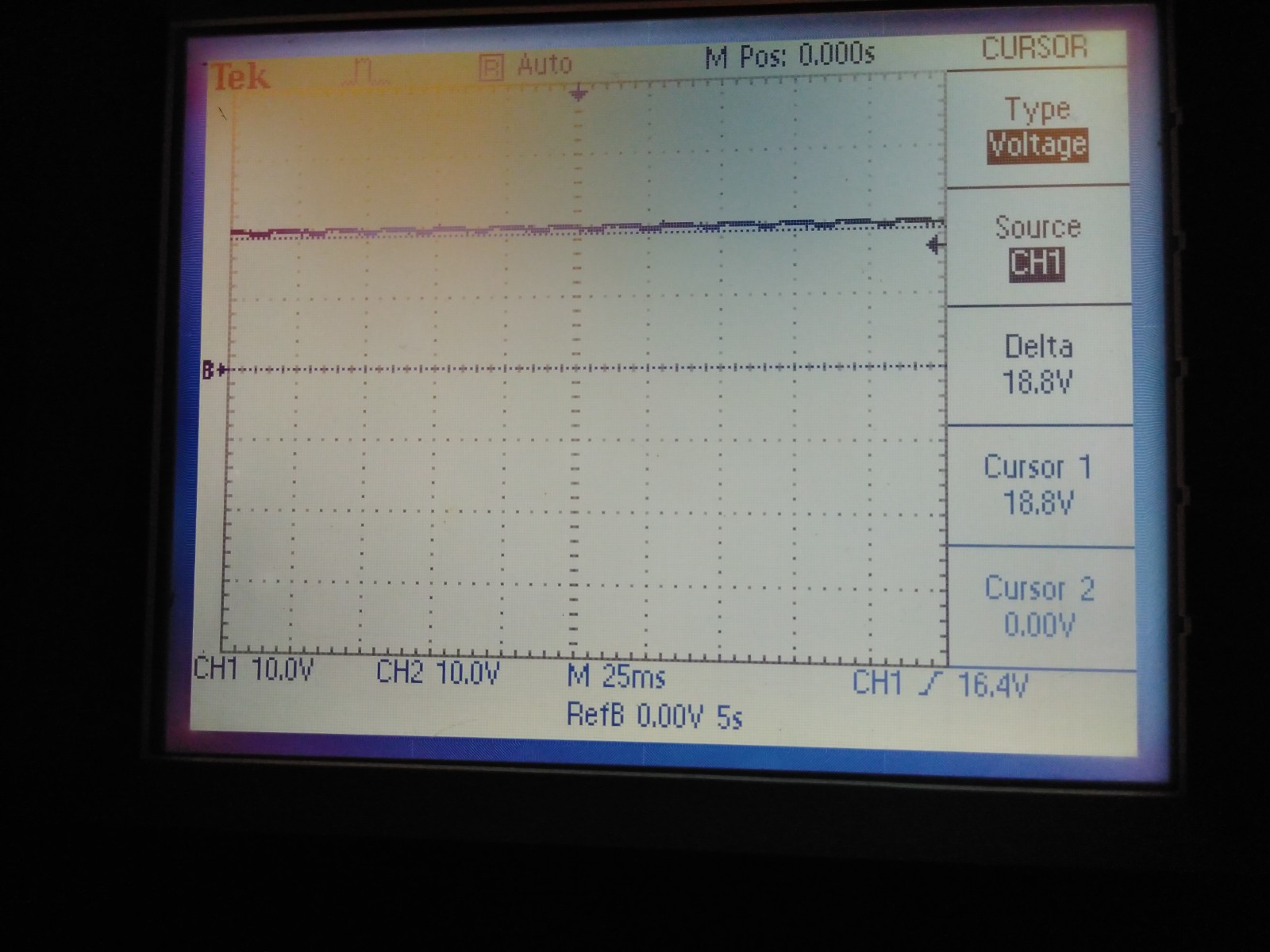

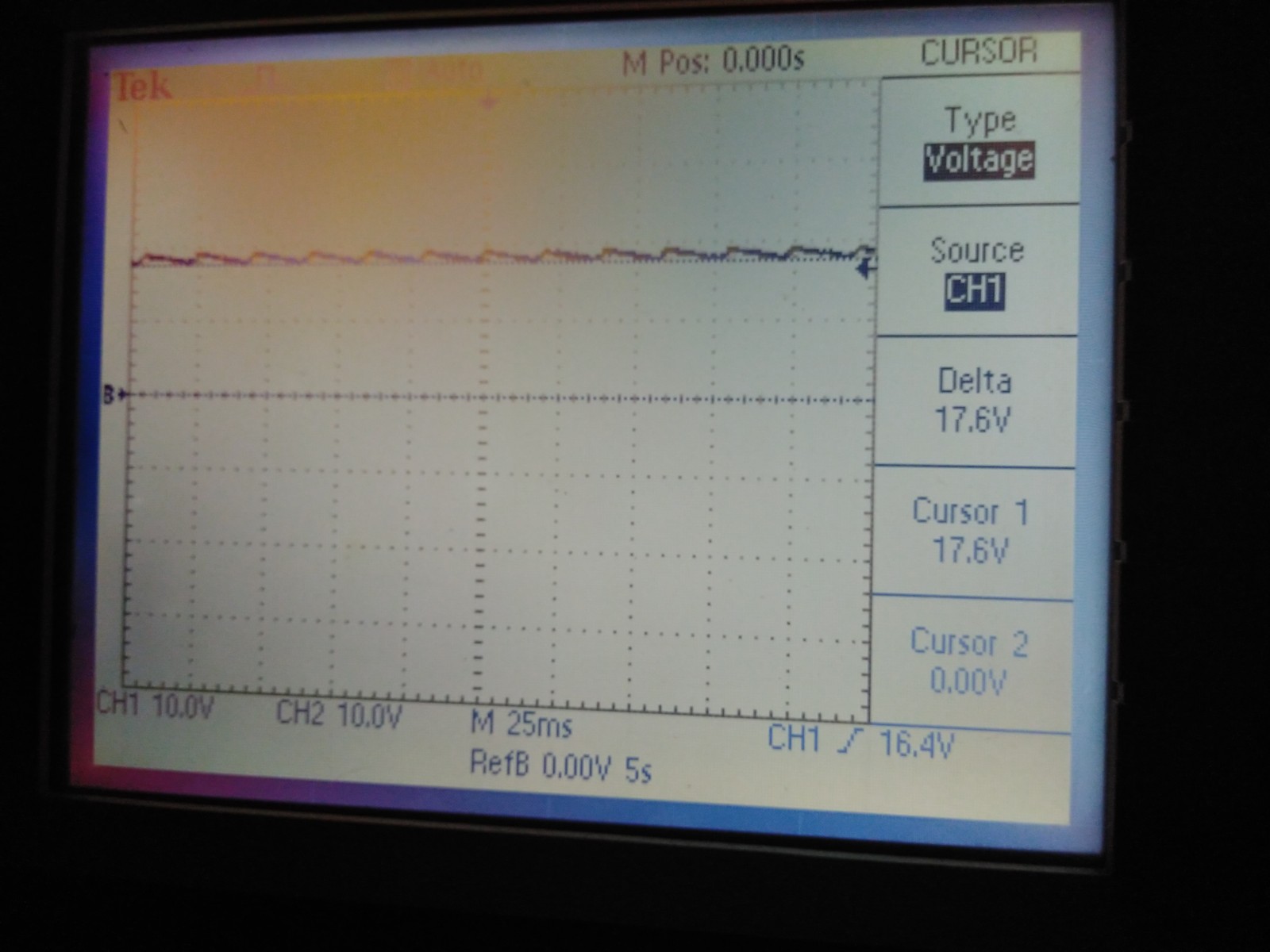

PostPosted: Tue Jun 23, 2020 6:37 pm    Post subject: Reply with quote  Mark this post and the followings unread
Took a while to get my stuff in order, but finally did some tests and here are the results:
Vin@Reg= 21.69V @ no load
Vout@Reg= 12.00V
Vin@Reg= 18.8V @ 0.285A
Vout@Reg= 11.95V
Vin@Reg= 17.6V @ 0.550A
Vout@Reg= 11.9V
Vin@Reg= 15.2V @ 1A
Vout@Reg= 11.80V
attached pics from the scope, the post rectifier cap voltage is quite noisy. I believe 10,000uF is big enough?

PostPosted: Tue Jun 23, 2020 7:10 pm    Post subject: Reply with quote  Mark this post and the followings unread
That is definitely more droop than the datasheet specifies, so unless it's damaged, it wouldn't be the LM3xx IC at fault.
PSUs need to transfer rather large amounts of current. To do that efficiently, all of the connections must be very low resistance. It would take only one marginal connection giving a little too much resistance to cause voltage droop. Problems in the Vadj part of the circuit could cause it to inaccurately follow the output and make inaccurate adjustments to the output. If not already done, I'd consider re-flowing all of the solder connections.
Dunno, pretty weird, so I'd suspect something weird.

I looked again at the scope traces. What I noticed is that it seems that under little to no load, there's no in-your-face ripple, but as you increased the load current, there began to appear more and more of a sort of sawtooth. It looks like it might be 50 Hz. I would look also at the regulator's input voltage with a scope, it may be coming within the dropout voltage. What that would mean is a transformer that just can't supply the current needed.
The circuit boards look well made.

Gingoism
Joined: Feb 01, 2017
Posts: 23
Location: Singapore
PostPosted: Tue Jun 23, 2020 7:59 pm    Post subject: Reply with quote  Mark this post and the followings unread
i am thinking the same with regards to the transformer, also it began "whirring" audibly at 1A Shocked .
ok will look at getting a higher rated transformer in the meantime.
