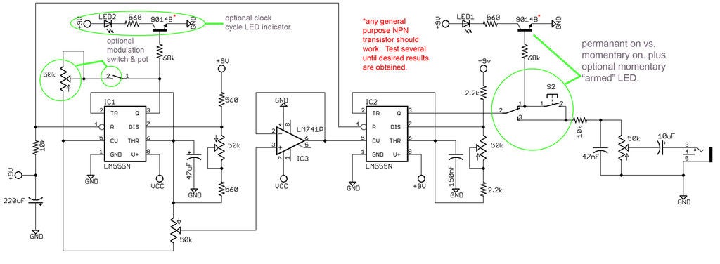

I'm wondering about something else. I recently built a dub sired based on the attached schematic. The first 555 is just a triangle wave generator that feeds the CV of the second. What I'm not sure about is the purpose of the op-amp stage in between.
If the circuit idea you provided works out--and generates an adjustable saw/triangle wave form, would it require a similar op-amp stage? I'm not certain why it is included. Without anything in the feedback loop, it should have 0-gain, shouldn't it? It's a buffer of some kind?
Yes, if you look at the schematic of the internals of the LM555 you will see that pin 5 is a considerable load to a potmeter of 50k and the buffer is there to take off the load from this potmeter.
Maybe you can substitute the LM555 for a cmos ICM7555 of which the data sheet doesn’t say what the value of the resistors are at the control voltage input just that it’s “very high”.

I’ve found a datasheet from Intersil HERE, where the value is given of the 3 resistors at the control voltage input, being about 100k typical so a total of 33.3k which is better but not high enough to remove the opamp buffer.
