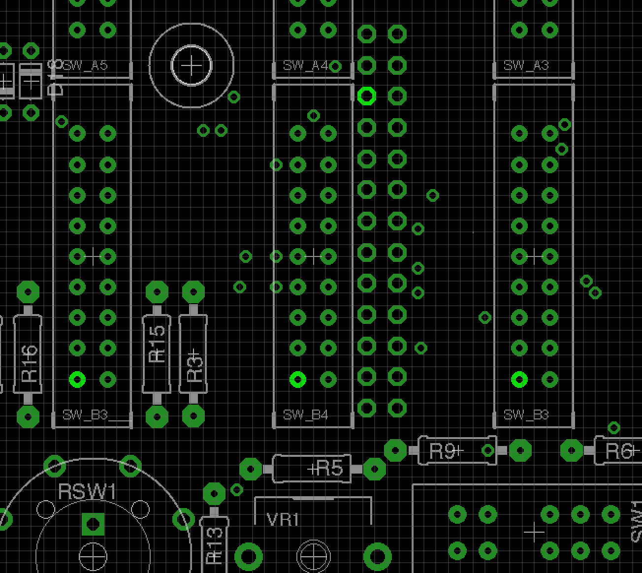

| hautlle
 Joined: May 23, 2011
 Posts: 11
 Location: KS
|  Posted: Sun Jun 07, 2020 8:31 am    Post subject: |    |
| Wonderful job on this module Ryk.  Your instructions are very clear and easy to understand and the panel is beautiful.
 After getting it all assembled and doing the calibration procedure I started the hardware test mode per the manual.  Everything on my module is working except the second step gate length switch.  I've checked the joints on the switch itself, along with the headers between modules and the ICs on the main board but have had zero luck since last night getting any response from that switch.
 Could you offer any insight as to where I might check next as I'm not seeing any obvious bad joints or shorts on either of the boards

|  Posted: Mon Jun 08, 2020 5:30 am    Post subject: |    |
|  	  | hautlle wrote: |  	  | Wonderful job on this module Ryk.  Your instructions are very clear and easy to understand and the panel is beautiful.
 Hello
 Thanks for buying the kit.
 Sorry to hear you have a problem with Stage 2.
 Is it just the Gate Mode for Stage 2.
 For the gate switch problem, can you check the polarity of D21.
 This diode supplies the swithc with 5V.
 If the diode looks ok, please try measuring the DC voltage [to gnd ] on D21.
 When Stage 2 is selected [ using NTX/PRV blue buttons ] you should see
 4.9-5V on both ends of this diode.
 Regards
 ryk

 Sorry, I didn't use the correct terminology.  The switch that gets no response is the Stage 2 Stage Count Control switch.  The Gate Mode switch behaves as expected.
| Back to top |  |

|  	  | hautlle wrote: |  	  | Sorry, I didn't use the correct terminology.  The switch that gets no response is the Stage 2 Stage Count Control switch.  The Gate Mode switch behaves as expected.
 Hello
 No worries.
 The diode to look at is D22, please check as previously described.
 If the readings are 4.9-5v then please check carefully the soldering of
 SW-A6 [ the Stage 2 Count control ]. Especially the bottom right corner pin
 when the board is flipped over.
 Sorry I havent had time to grab a pcb photo.
 ryk

 I am only getting 4.55v out of D22.
| Back to top |  |
| ryktnk
 Joined: Apr 24, 2008
 Posts: 285
 Location: london
|  Posted: Tue Jun 09, 2020 2:26 am    Post subject: |    |
|  	  | hautlle wrote: |  	  |  	  | ryktnk wrote: |  	  |  	  | hautlle wrote: |  	  | Sorry, I didn't use the correct terminology.  The switch that gets no response is the Stage 2 Stage Count Control switch.  The Gate Mode switch behaves as expected.
 Hello
 No worries.
 ryk
 Hello
 That is fine [ the diode has quite a  voltage drop ]
 The problem would now appear to be with the switch A6, please check carefully the pin soldering.
 ryk

 After removing most of the solder with a sucker and re-soldering the switch I still had the same issue.
 After inspecting all parts of the switch for a while I noticed there was a tiny spot of something splattered on the track inside the switch.  I gently removed it with a toothpick and all is working now
 Thanks for your time and the wonderful module Ryk. I look forward to exploring the M185[/img]

| Hey guys,
 Just finished my build, and it fires up for the test as it should, but it only seems to be 5 stages.
 LEDs pingpong left to right 4 times, but only 5 LEDs.
 Max stage switch also only lights 5 LEDs.
 EDIT:
 When running a normal sequence, it appears to be running through all 8 stages, but no LED indication on 6, 7, and 8.
 Any help would be appreciated.

|  	  | Still Sound wrote: |  	  | Hey guys,
 EDIT:
 If you are having problems with some LEDs not lighting, it is a good idea to measure voltage on the LED drivers on the Main PCB.
 Boot up the sequencer normally, turn off the clock, and use the NXT PRV blue buttons to select a stage.
 Then measure the voltage between Pin 16, and the relevant pin on the LED Driver IC. [ see list below ]
 Use the red probe on Pin16, and the black probe for the LED driver Pins.
 You should see 1.8v on a correctly functioning pin that is active for that stage.
 Here are the Pins to measure voltages on.
 IC5 RED LEDs
 Stage 1 - Pin 5
 Stage 2 - Pin 6
 Stage 3 - Pin 7
 Stage 4 - Pin 8
 Stage 5 - Pin 9
 Stage 6 - Pin 10
 Stage 7 - Pin 11
 Stage 8 - Pin 12
 IC6 GREEN LEDs
 Stage 1 - Pin 5
 Stage 2 - Pin 6
 Stage 3 - Pin 7
 Stage 4 - Pin 8
 Stage 5 - Pin 9
 Stage 6 - Pin 10
 Stage 7 - Pin 11
 Stage 8 - Pin 12
 If all these volatges seem ok, then perform the same voltage tests, but
 this time measuring the voltage on the LED directly on the PCB.
 Red probe centre leg.
 Green LED black probe on LHS leg
 Red LED black probe on RHS leg.
 Again if correct the voltage should be apprx 1.8v
 If you are not seeing these voltage on the LEDs, there is most likely
 a problem with the pin header soldering.
 ryk

| Hi Ryk, continuity is fine through to the pin of the processor, which only outputs about .1V
  Well, at least it's in a socket.
 Robert
| Back to top |  |
| ryktnk
 Posts: 285
 Location: london
|  Posted: Fri Jun 12, 2020 11:34 am    Post subject: |    |
|  	  | nativeVS wrote: |  	  | Hi Ryk, continuity is fine through to the pin of the processor, which only outputs about .1V
 Robert
 Hello
 Can you turn on the sequencer.
 Stop the clock.
 Select a stage with the NXT PRV buttons, and measure the voltage on the pin from the previous post, whilst adjusting the Gate Mode switch.
 PS this is voltage that is sent to the processor for Gate Modes.
 When you were using calibration test mode, did the Pots and Stage Count switches test ok.
 ryk
