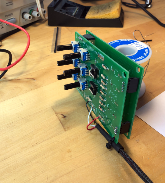

PostPosted: Mon Apr 06, 2020 10:02 am    Post subject: OK it's built--issue with audio "Bleed" Reply with quote  Mark this post and the followings unread
Gang:
I have built the filter using custom PCBs. I used "tall trimmers" and "skiff" construction, and it's all working.
For this v2 I am using a 2nd board to set CV bias, which IMO really helps control the filter's sweep.
Problem: on both versions of this I am having the same issue, what I call "audio bleed". Some of the initial unfiltered signal, very audible, is turning up at output.
I have enclosed a sound clip. You can hear the "ring" of the bleed pretty clearly after the filter has closed.
Anyone know how to stop this? I have checked my work a few times, can't find a mistake. My analog design skills aren't good enough to know where this bleed is coming from, but some of the unfiltered signal is obviously making it from input to output.
I can't remember if the initial paia filter had this issue, but perhaps it did.
(You can circumvent this by gating the filter output, using a 2nd filter in series, LP works or just adjusting VCA envelope to close before the filter. But overall I'd like to solve this somehow.)
BTW: I changed R9 to 27K; input audio resistance to 3M for one input and 1.5M for the other. R12 was change to 68K. I am using +/- 15V. the size of LED doesn't for me make that much of a difference. Besides that, it's an exact copy of GASBOSS's linear current design, with an additional couple of op amps downstream from CV in to set the CV bias relative to ground.
One way or the other, I am going to work on this more and then will post more details on blog incoluding a lot more sound clips.
Thanks in advance for any help....
Here is the unit, yes, no ICs, these were removed for testing a few things. The build uses 3x TL072

gasboss775
Joined: Jan 02, 2016
Posts: 217
Location: Scotland
PostPosted: Thu Apr 16, 2020 4:31 pm    Post subject: Reply with quote  Mark this post and the followings unread
@cslammy:
Nice to see such a professional looking implementation of this circuit, probably better than the PiAI original!
It's been awhile since I worked on this but I seem to recall that it wasn't possible to completely shut off the signal with this filter as the cut off range couldn't go that low. You could experiment with different capacitors in the branch of the circuit connected to the controlling LED but you would probably sacrifice some of the higher end of the cut off span.
Gordon.

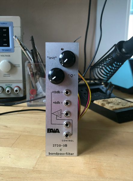

PostPosted: Mon Jun 15, 2020 6:29 am    Post subject: Filters done Reply with quote  Mark this post and the followings unread
OK--done w/ this I think, I've finished my build of Gasboss's 2720 mods, also I went back to orig paia schematics and built one of those that works on +/-15V.
blog post about gasboss' design and orig PAIA filter repop: https://audiodiwhy.blogspot.com/2020/06/paia-2720-3b-filters.html
Website: https://www.charlielamm.com/gear/vcf/forums.html#2720
Sound clip: https://soundcloud.com/cslamm/2720bandpass-final

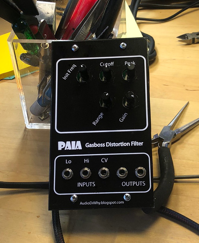

 Filesize:  1.75 MB
 Viewed:  438 Time(s)
 Filesize:  799.39 KB
 Viewed:  422 Time(s)
