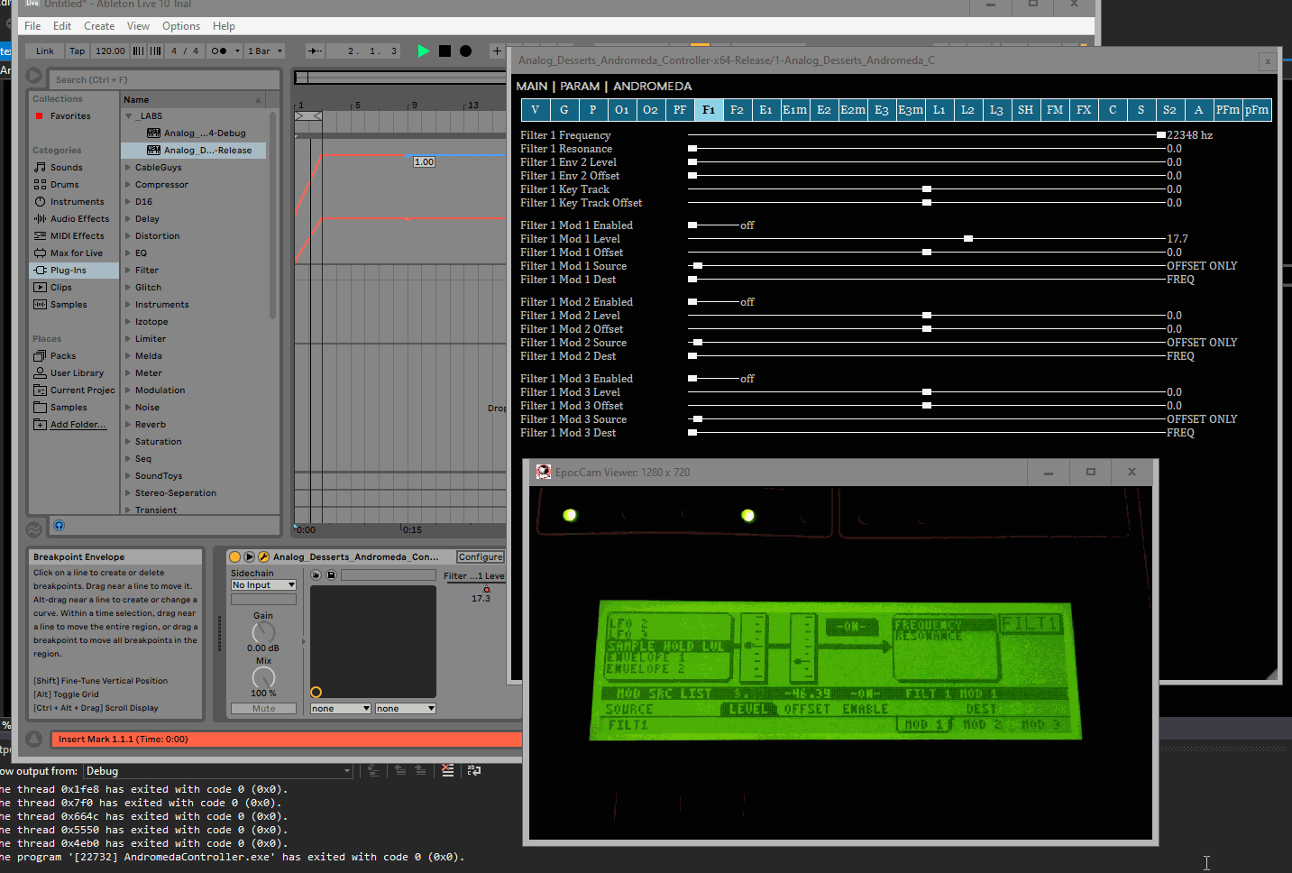

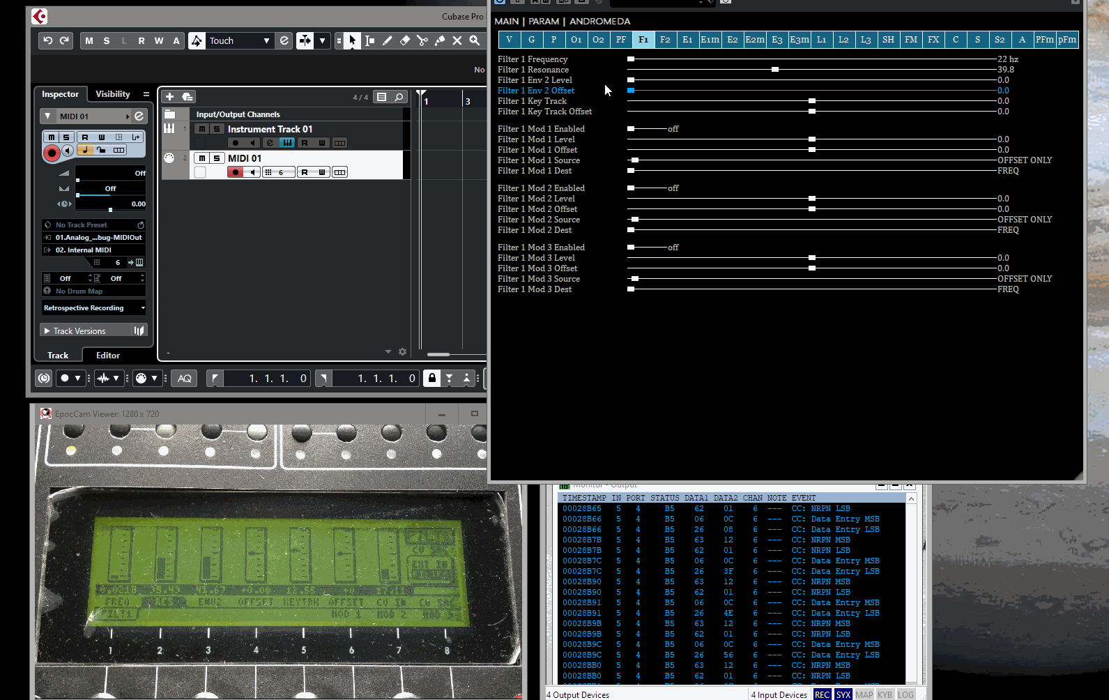

BIG NEWS. I report back some AWESOME development progress. I added (but not-yet released) the MIDI CC NRPN algorithm to my Andromeda A6 VST.
I successfully used my Andromeda VST in Ableton Live 10.1, and Cubase 10.5. The parameters are now automate-able as a VST within Ableton Live 10.1, Cubase, and every(?) DAW now! See screenshots for proof!
( Previously, I reported I got MIDI CC NRPN control working in Ableton Live (9), but discovered it was buggy because Ableton Live 9 was trying to be too smart, and was filtering out 2 of the 4 MIDI CC NRPN messages needed to control Andromeda value changes.
God bless a gentleman named Marcus -- who emailed me yesterday, and let me know that Ableton Live 10.1 no longer filters out duplicate MIDI CC NRPN messages (which the Andromeda needed). So I tried the VST in Live 10, AND OMGOMGOMGOGMOGMOMG IT WORKED. My, and others dreams have been renewed. See attached GIF!
I'm quite a busy and scatterbrained person, juggling an insane amount of hobbies and projects at once --- so I hope to prioritize this and release this soon. I will need to go through every parameter one by one --- making sure every parameters works correctly in NRPN mode in Ableton Live 10, and Cubase, and adjust accordingly!

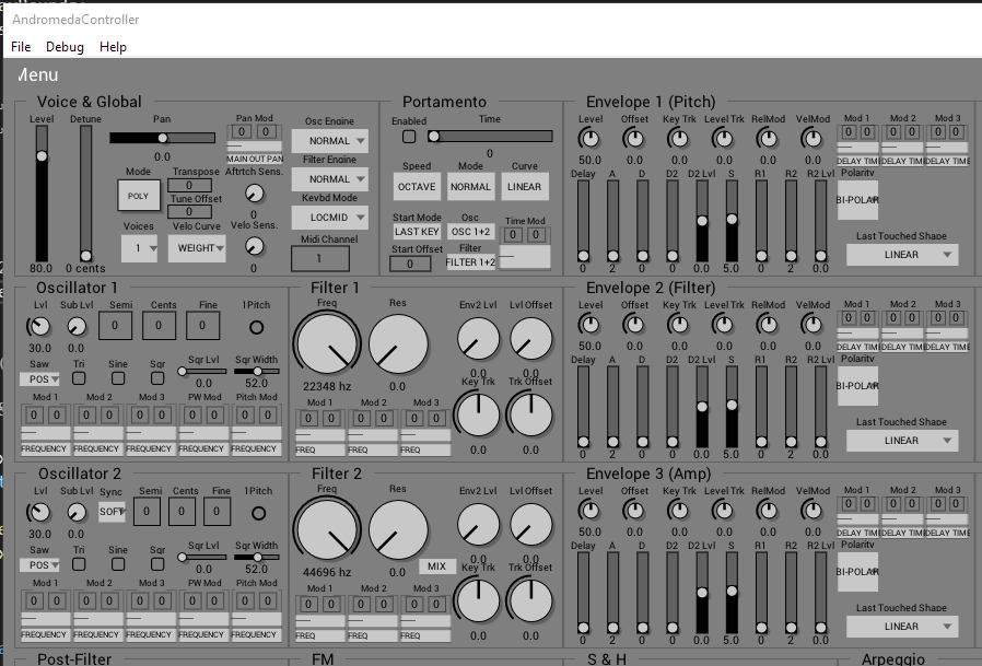

Awwwwwwwwwww yeah, look whats in progress: Started working on like the 4th re-write at this point. Because I'm pretty sure I got most of the Andromeda parameters automated at this point -- except the FX pages -- I started re-writing it from the ground up, so everythings laid on infront of you on one screeen. Finally Smile This is how I had everything originally (before offering it to the public, but I lost that versions source code). Feels good. This is the rough layout. Re-skinning it will be easy. I can give it the same background and knobs as the andromeda, or whatever.,
