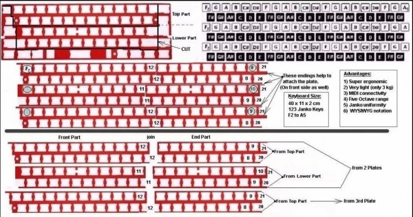

For years I used to play the piano accordion and now that I own the Yamaha Tyros 3, I missed the convenience of playing the accordion bass section, for it's so much easier than manually playing the chords. That's why I thought to connect an old accordion bass section to MIDI and
just successfully finished wiring up my 120-button (with single contacts) Farfisa accordion bass section to MIDI.
Result: It's amazingly compact! The single contact makes ea. button even lighter to press than a regular, mechanical accordion bass!
On a mechanical bass each button has to open 3 to 4 air flaps and with additional spring contacts the buttons are getting pretty hard to press.
Jeez, that was a crazy job! It took my 3 weeks to get it right. It looks pretty messy, but it works and sound truly great. I'm excited about the result!
The thing I like most on it is that it offers me (accordion player) the chance to combine manual and Yamaha styles accompaniment.
Now I am able to manually enrich and vary the bass +chords and so, make it the great sounding Yamaha styles automatic accompaniment sound "far less automatic".
Since I was unable to attach the project details, I uploaded them here: https://app.box.com/s/994hzfqhsnjksguqa22t
My last challenge is to recreate that typical accordion "bellow shake", which at the same time controls volume and tremolo variations, like on an accordion. That creates emotional presents! The foot pedal delivers not quite the same.
I did some testing and discovered that connecting a cable to the 10K potentiometer in my Yamaha's MFC10 Midi-Foot controller allows me to operate this foot controller's circuitry via an LDR on the 120-button box.
My initial idea was to place the whole bass section onto soft springs, but then I discovered that every time I change to another chord position, my hand won't press the box and the volume will decrease considerably.
So, I thought of rather tilting the unit slightly forward, which stays in either lower or higher Vol position. This makes it equally easy to create tremolo, bellow shake and Vol changes.

Since many accordion players might have difficulties to construct my project, it might be a good idea for someone to manufacture and sell it for under $600.
Hence, my next and probably last Tyros project will be constructing the 4-row (removable) JANKO Kbd layout on top of the Tyros' zebra piano Kbd.
Result: That will enable me to play all major and minor scales, without having to put up with many years of practicing the irregular zebra piano Kbd.
To promote and perpetuate the irregular zebra Kbd is only OK for music teacher's profits and helps professional musicians to discriminate themselves from hobby musicians. Their motto is: "Why make it easy, when it can be made complicated!"
I am rather interested in simplicity! Thanks to my bit of practice in playing the accordion, I gained some basic insight into music theory, which enables me to simplify the lot, incl. the music notation.
The end result will be: having created the easiest and fastest method to learn and play modern Synths!!

PostPosted: Wed Oct 28, 2020 7:22 am    Post subject: My finished DIY Janko Midi accordion Reply with quote  Mark this post and the followings unread
It was always my ambition to create an easy to learn and play accordion style musical instrument, but it took me ages to get my act together. Finally, step by step I built the DIY components for it:
1) I converted a 120-button accordion bass to Midi.
2) From 3 PC plates I created a 6x6 JANKO keyboard
3) I created a WYSIWYG notation for it (similar to Klavar notation).
It can't get any easier (!!) and to make it sound like a real accordion I got myself the latest XXL MASTER ACCORDION from V3 sound modules, pairing it with an equally excellent MidiToolEx software and voilà, now I'm enjoying the sound of 206 top accordions at a fraction of Roland Midi accordion's costs.
In case anyone of you would like to have some more details, please feel free to contact me.
To accelerate the notation conversion I would need to find a programmer for it.
