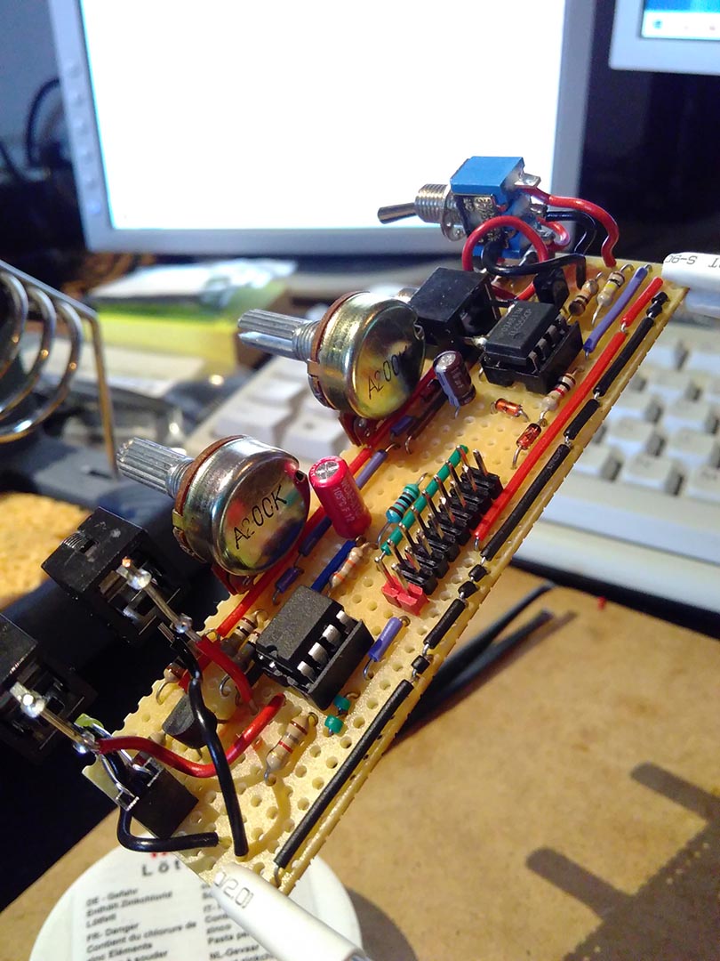

Hi!
New to the forum, and modular. And synths in general. And anything related to electronics. Bear with me.
I'm trying to implement the Moon Base Xplorer AD/AR envelope generator by PHOBoS. I'm building according to this revision (minus the LED stuff).
So far I've built it on breadboard, and it seems to be working, but there are a couple of things that worry me, and it would be great if someone could help me clear them out!
First, when I use a multimeter to read the output - in AR mode - I read a spike of around 17 volts when applying the gate signal. Is that bad? Should it be able to go that high? I'm only applying 12 volts to the circuit. The spike is only there for a fraction of a second and then it drops to 10 volts as expected. I've tried the output with my VCA (FSS VAC1 P.O.C.A) and it seems to be fine. In AD mode I read no higher levels than 10 volts.
Second, when switching from AR mode to AD mode the output is triggered once. When switching back to AR mode, nothing happens, but everytime I go to AD mode it triggers the output. I managed to remedy this by switching the 10K resistor going between the the 1nF cap and the transistor base to a 39K resistor, but I don't understand why that worked and if its bad in any way.
I should probably mention that I'm using a NE555P timer instead of the CMOS one. I've ordered the CMOS timer and plan to use that instead.
Ok, hope that made sense. Maybe I'm worrying too much, but hey, this is new and scary Smile
That's really odd. It would be possible to create a higher voltage but I don't see how that could be happening here, especially not with the zenerdiode and the opamps
which should both limit the output voltage. Do you also measure that voltage spike before the opamps, so across the zener ?
I just tested this and though it doesn't happen all the time for me it does indeed trigger sometimes. Hadn't noticed this before Rolling Eyes
I have an idea what might be happening and if correct it could be solved with an extra diode. Maybe a bit hard to explain where to put it
so I'll see if I can locate the schematic and make an updated version. Thanks for informing me about that.
In this circuit it does indeed make a difference because of the resistor connected to the CV input which sets the treshold level in combination with the
internal resistors of the 555. For the CMOS version these have a much higher value. The CMOS version is also less noisy on the power when switching.

Ok, so I've been at this for a couple of evenings now, diving into documentation on the 555 timer and trying different caps and so on and nothing. Because I was an idiot and didn't test my crappy multimeter properly.
When nothing worked I finally pulled myself together and actually measured the gate signal coming into the module, and sure enough the spike was there too! So my next incorrect assumption was that something was wrong with my sequencer and that it was causing the spike. So i tried to apply 12 volts straight from a power supply to the gate input of the AD/AR and same thing there. In short - no matter what I measure with my multimeter I get the spike (I measured my laptop charger and it read 29 volts only to immediately drop to the correct 19). I guess I havn't used the multimeter that much and never reflected on it before. It was just easy to assume that the source of the problem was the mess of components and wires on a breadboard and not the tool I bought from an electronics company. So, yeah. I suck (but not as much as my multimeter (or are they supposed to work like this? (I'm definitively saving up for an oscilloscope))).
Sorry for putting you through all of that, and for ever doubting your circuit! Gonna try and solder it together as soon as I get some free time again. But nice catch with the Ben Eater 555 timer video! If I hadn't been an idiot, that would surely have been the solution Smile It was an interesting lesson nonetheless.
One final question though - do you have the specs for the last transistor and resistor connected to the LED? I very much feel I need the blinky light.

Ok, a month later and I'm done! Switched out the 500K pots for 200K log pots I had laying about, which I felt gave better control when setting short time spans, the trade-off being shorter maximum time spans. Other than that it's according to your original schematic. Works a charm!
Since I don't have a good way of making panels I used one of the placeholder panels that came with my case. Didn't bother to try and cut it. Instead I think I'll just try and fill the width of the panel with DIY modules, so expect more confusing threads like this one from me in the future Very Happy
I still want to look into the triggering thing to see what exactly is happening there though it's not much of a problem in use.
I'll keep a lookout for any update on that on the forum, though I'd say that at least in my case it's a non-issue.
Anyway, THANK YOU SO MUCH for all your help (and patience)!

PostPosted: Wed Dec 02, 2020 10:37 am    Post subject: Reply with quote  Mark this post and the followings unread
oh that looks great! both stripboard and panel Very Happy
I love the insulation on those tiny jumpers love
great idea using the red part on the power headers, why did I never think of that ?!
glad I could help, I hope you'll have a lot of fun with it.

Well that's a super tidy perfboard build Cool excellent work

Thanks so much! I like paying attention to details (and those tiny bits of insulation could mean the difference between life and death Laughing )
Thank you! Only took four iterations in VeeCAD and about 6 hours to put together Rolling Eyes
