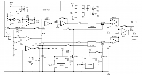

I'm sure that this question should have been asked elsewhere, but I've searched and can't find anything relevant. The question is:
"Has anyone ever successfully built John Simonton's two-note ribbon controller circuit, shown at http://www.paia.com/ProdArticles/dual-ribbon-howto.htm?"
The reason I ask, naturally, is that I have spent the last week laying the circuit out on stripboard and everything works except for the follow-and-hold circuitry. The 'hi' note generator derivation circuitry works fine as does the trigger generator. If isolated, the follow-and-hold circuits work fine. If I unplug the 4066 chip, I can set and hold both ribbon voltages using wire bridges; however, when the chip is in place, both high and low outputs drop to zero as soon as the finger is removed and the gate signal switches off. Same when the 'hold' switches are used (I've used ordinary toggles for hold rather than the touch plate approach).
I've tried two 4066 chips and a 4016 - same results every time. Oh, and I'm using a Spectrasymbol linear sensor for the ribbon.
My tests indicate that the control voltages for the 4066 switches are way out - the control inputs are biassed slightly negative of zero to ensure a clean trigger and when the gate operates, the voltage at the control inputs only rises to about 1 V. However, the switches open fine - it's just that they leak as soon as the gate signal disappears.
All suggestions gratefully received! scratch scratch scratch

Okay, update - slight impedance issue overcome. The voltages controlling the switch control inputs on the 4066 are actually operating between -0.7 V (off state) and +5.8 V (on state), which, although short of VDD, should be okay for switching states.
The only remaining explanation is one of timing - I guess the 'Lo' and 'Hi' voltages are dropping faster on releasing the ribbon than the 4066 can isolate the follow-and-hold circuitry, so next task is to examine the capacitor values more critically.

I looked at this several years ago and never got it to work. I took a deeper look at this just the other day. A quick circuit analysis suggests that the Track/Hold cannot possibly work correctly.
The T/H is operated by the "Trigger proc." section, ie the circuitry around IC3C. IC3C fires the Hold function when pin 10 goes below zero volts. This happens when the (smoothed) input signal goes below 0.24 volts. This is the voltage that is held. Always. Capacitor C2 discharges slowly through R24 when the finger contact is removed, so what you hear is a slow sweep down to the pitch corresponding to 0.24 V.
I wrote PAIA the other day to see if they could explain what's going on, but the guy there has no experience with the circuit and does not have a working version to look at. He didn't seem to understand the analysis I gave above.
I've scratched my head to see if the problem could be explained by some small error on the schematic, but so far I have come up blank.

PostPosted: Mon Nov 16, 2020 4:13 pm    Post subject: PAia ribbon controller
Subject description: i do think i got it to work

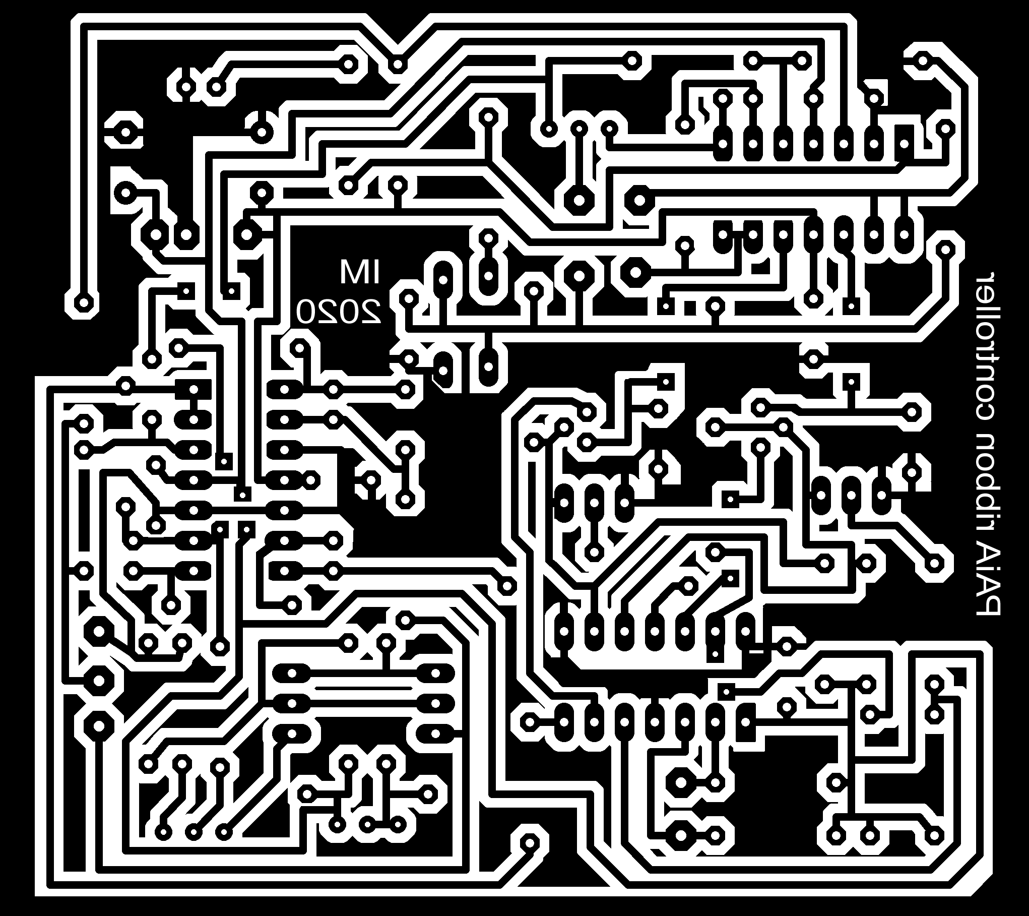

Hi i have been tweaked it for a long time and i got it to work now
(sample/hold) anyway. I made a Pcb in Eagle if someone want to
have the Pcb-layout and componet placement as well.
The outputs generates up to 5.5 volt and the "hold" function is up
to 1 min before is start to drop to much. You can change the cap
470n if longer "hold" is needed i think Smile And there is a lot of jumpers

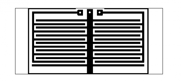

i dont do doubble sided Pcb:s Confused i made a simple touch pad to try out.
