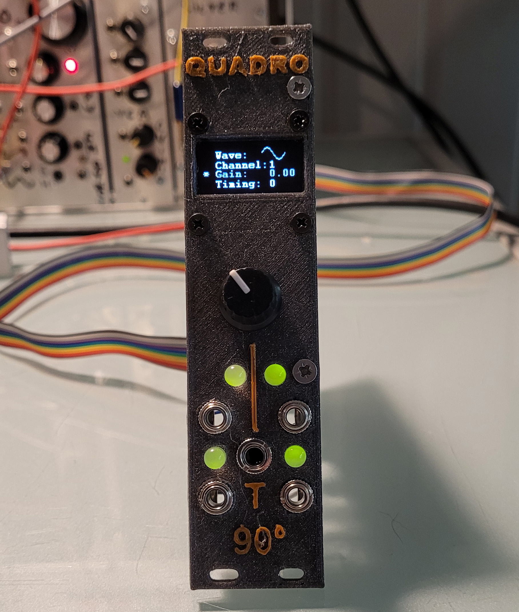

What You see here is the output signal of two of the four outputs of a quadrature LFO, four outputs all 90 degrees shifted and the idea is that you can choose 4 different wave forms for each output. I am playing with the idea to construct each wave form out of four parts of the four wave form types, e.g. you can have one output a clean sine wave, while the next consists of for different parts of wave forms, so you can have the first quarter a sine shape, the next quarter a saw part etc.
But that would take some extra programming... but I’m playing with the idea.
The four leds are red/green leds, so when an output is more positive than 2.5 volt it will light up green, lower as 2.5 volt it will light up red.(starting very dim to more brightness)
