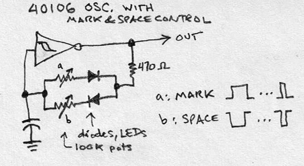

Re your Ω GENERATOR... since the 40106 generates a square wave, i.e. 2 states, the "vactrol" would only go between 2 different values, albeit imperfectly depending on the rate of the oscillator, and the slowness/response of the LED & LDR.
To add a little more variation, there are a couple of simple mods to make the 40106 produce triangle waves. One is with a capacitor, and another with an opamp.
You mentioned wanting to control the duty cycle (A.K.A. mark & space) of the 40106, but failing. I'm not sure what you did, but here's a schematic of one I've built many times... it's my drawing of a circuit I can't remember where I got it from.
There's another 40106 oscillator with adjustable duty-cycle at Beavis Audio's CMOS synth page (which has a couple of other good & useful circuits)...

ooh.nice thanks ....
i'm gonna try that circuit with the two diodes!
