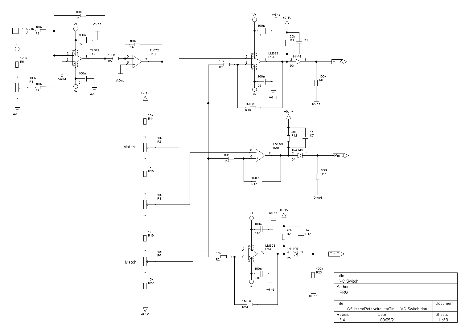

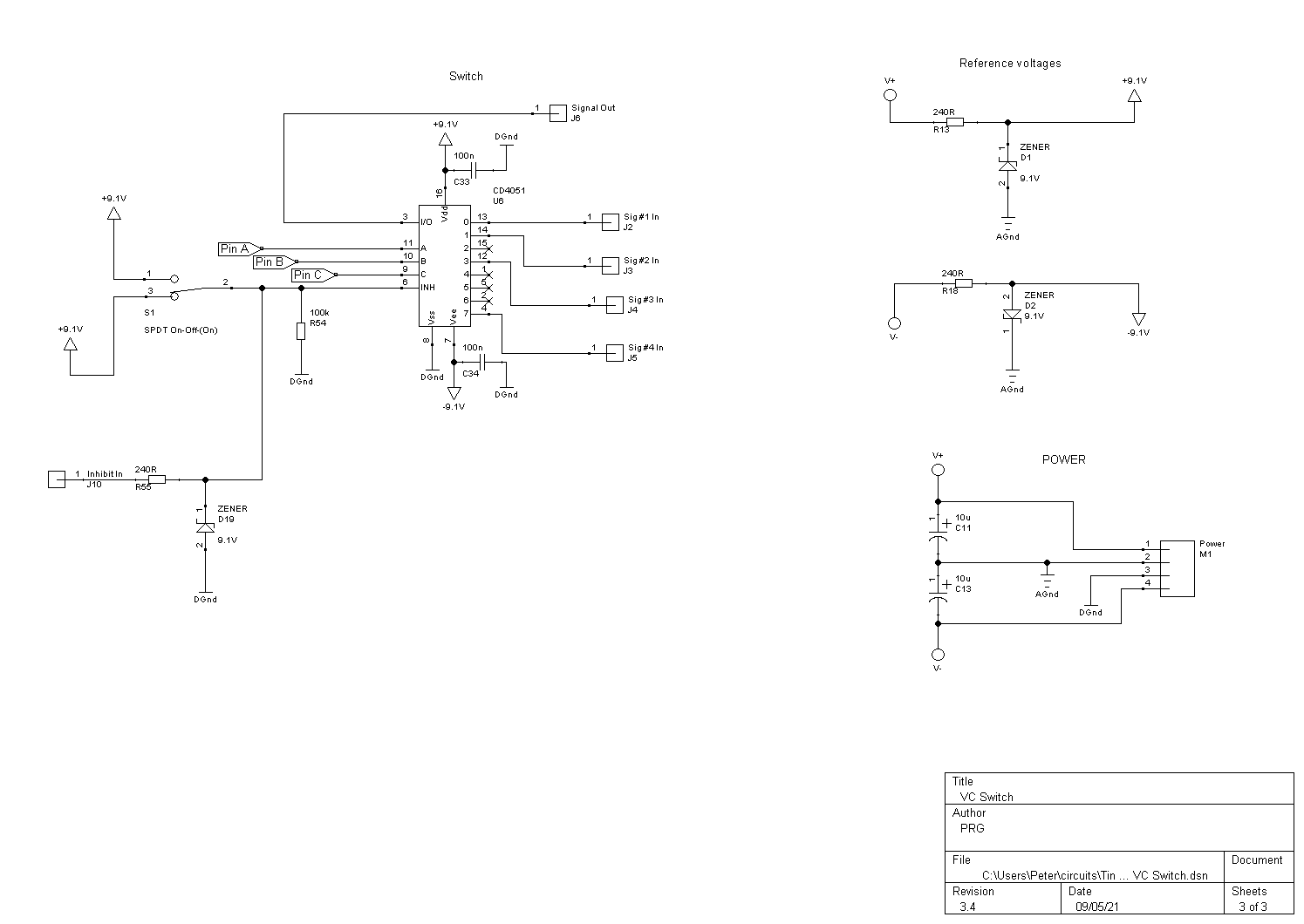

Thanks PHOBos. The 4051 (which I happen to have in my box) looks promising. I reckon I can make a 1:4 channel switch from it, controlled by three simple comparators (using real comparators rather than opamps will also have the advantage that I can use the pull-up resistor they need to set the output Hi to a suitable value for the 4051.)
The plan is roughly: 0-10V control voltage input -> three comparators set at say 2.5V, 5V and 7.5V thresholds. Block negative portions. Positive Hi of 9V from each into A,B C inputs of the 4051 respectively: so below 2.5V the 'digital control' is 000 = channel 0; 2.5V-5V = 001 (ch 1); 5V-7.5V = 011 (ch 3), above 7.5V = 111 (ch 7).
Signal being passed will be either +/-5V audio or +/-5V CV. Not sure whether some error correction for voltage loss in the switch will be needed (that is will 3.000V In translate to 3.000V out?)

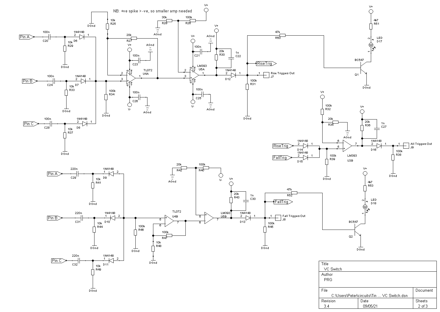

Here are the schematics for anyone who is interested. In essence a control voltage (which could be random, or an LFO or anything else in the +/-5V or 0-10V range) is applied to three comparators, the step points of which are determined by three pots, roughly in the +4 to +1V; +1 to -1V and -1V to -4V ranges). These control the logic pins of the 4051, thus offering logic of 000, 001, 011, and 111, which connect channels 0, 1 ,3 and 7 respectively to the common I/O. Any signal appearing on these is thus passed in turn through the 4051.
Also available (and the thing that actually was the trickiest to do) are triggers on both rise and fall at each comparator trip point. With a saw CV, you thus get three intermediate triggers for each rising section of the wave. With a triangle input, you also get three triggers on the falling section. (All the triggers are actually generated with a sawtooth, but the three falling ones will happen in very rapid succession so are best not used).
With four different static voltages applied to each signal input, and a sawtooth control, the result is a step sequencer. With a triangle control, the sequence steps up and then down. A square will alternate between two CVs. Of course, any signal can be applied - four different audio signals for example. The switch could also be run in 1 to 4 mode if you wanted.
I've yet to build this out, so while it appears to work, I haven't really tried the functions out.
Any comments welcome
Peter

Posts: 5950
PostPosted: Sun May 09, 2021 1:26 pm    Post subject: Reply with quote  Mark this post and the followings unread
looks good to me Very Happy
The -/+ 9.1V is a bit close to the max voltage, actually slightly above it but it'll probably do.
Maybe some overvoltage protection on the in/out of the mux could be added aswell.

PostPosted: Mon May 10, 2021 5:14 am    Post subject: Reply with quote  Mark this post and the followings unread
Thanks Phobos. I had a look at datasheets for 4051's and found that while National Semi does indeed specify an 18V max for the power supply, Texas Instruments (which I happen to be using) states 20V max. I guess the solution would be to use 8.2V zeners throughout, giving 16.4V power supply (the difference between Vee and Vdd).
My system runs on +/-12V, so very few signals exceed 10V, which I can probably get away with (the max allowed signal is Vee+0.6V). But for anyone running on +/-15V, or using a 4051 with an 18V limit, overvoltage protection on the signal channels would likely be prudent. Back to back zeners to ground (with a small series resistor) of the same value or one lower than whatever was used for the power supply on each channel would be my thought. Any signal hotter than 16Vpp (such as +/-10V audio), is going to need additional circuitry - say an inverting op-amp on each input to halve the voltage, then another on the output to double it back up. Which would mean the module couldn't be bi-directional.
Posts: 5950
PostPosted: Mon May 10, 2021 10:16 am    Post subject: Reply with quote  Mark this post and the followings unread
for switching voltages outside of the supply range there is another clever trick which makes use of the virtual GND potential of an opamp.
Ken Stone made use of it in his Analog Switch Matrix: http://www.synthpanel.com/modules/cgs55_asm.html

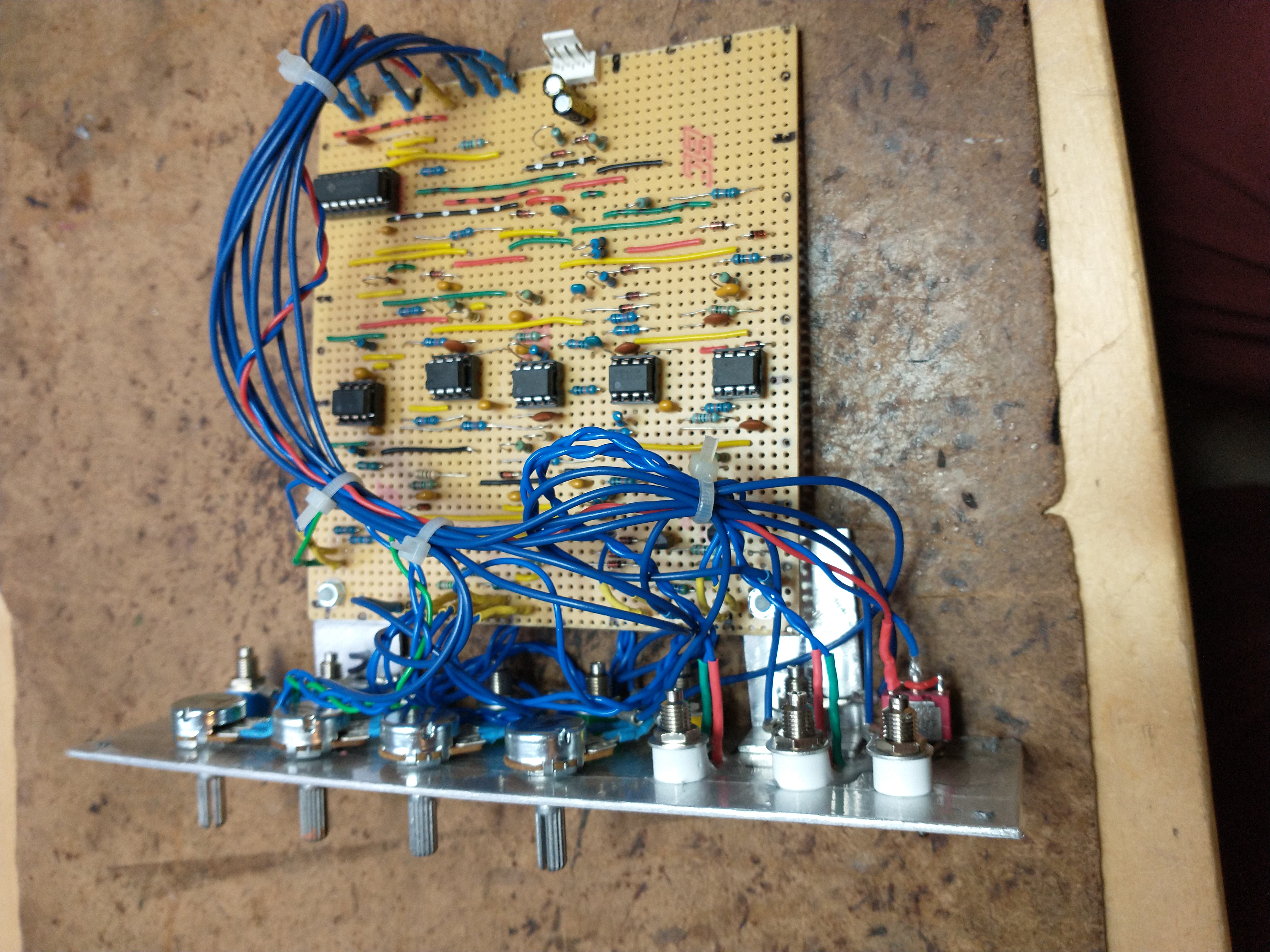

PostPosted: Sat Jun 19, 2021 12:44 pm    Post subject: Reply with quote  Mark this post and the followings unread
So I finally built this module, and it works fine. Here are a couple of pics of the build, and also a couple of sound samples. Nothing special.
#1 has 4CVs as the inputs (two fixed voltages, and two the CV outputs from a sequencer, one fifth apart), with a saw LFO as the control for the switch, and the CV's driving the V/Oct of a VCO.
