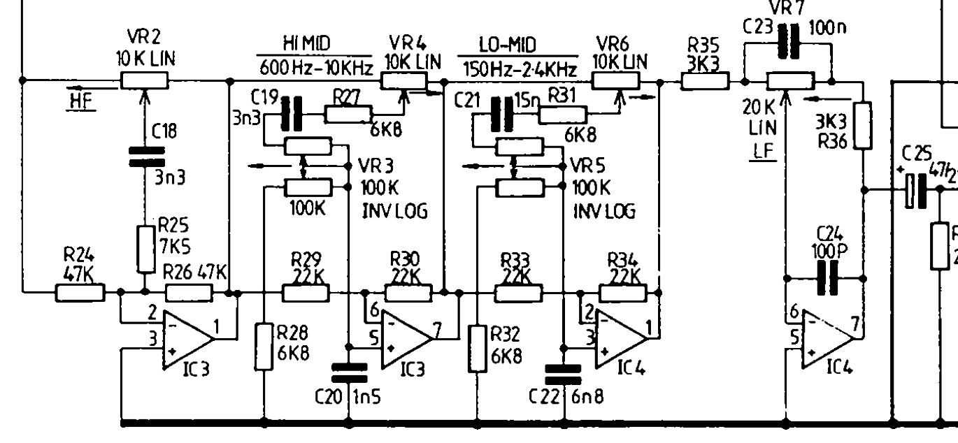

I read there are three relative weak spots for thst TASCAM mixer.
1. EQs are too sharp
2. Crosstalk
3. Noise
The first may be improved by different resistors. If you gave the skills, look at the schematic, figure out what kind of EQ cuicuit it is, find an online calculator fir that circuit, then substitute resistors for less resonance.
The second is not easy to say.
The third, I would replace all the NJR4565 dual opamps with (sockets and) less noisy chips. Start in the ouput stage. It seems a 5332 would substitute OK. Thus would also change distortion and clarity.
Regarding re-capping, It is a good thing to do. But it wont give much effect while these middling op-amps are in use.
For cost, it is vital to shop around: you may find thst, say, buying 30 or 50 chips in bulk can be much cheaper than buying 10 from the wrong place.
Yes, Cabirio on gearspace helped me with this, and I actually spent this winter implementing it, while also reorganizing the whole "studio".

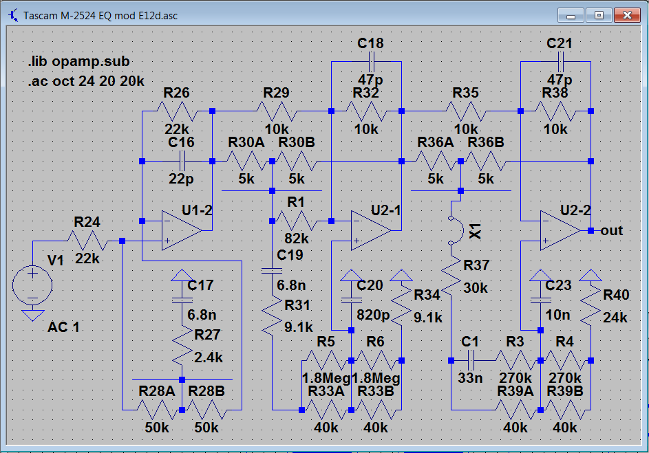

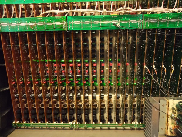

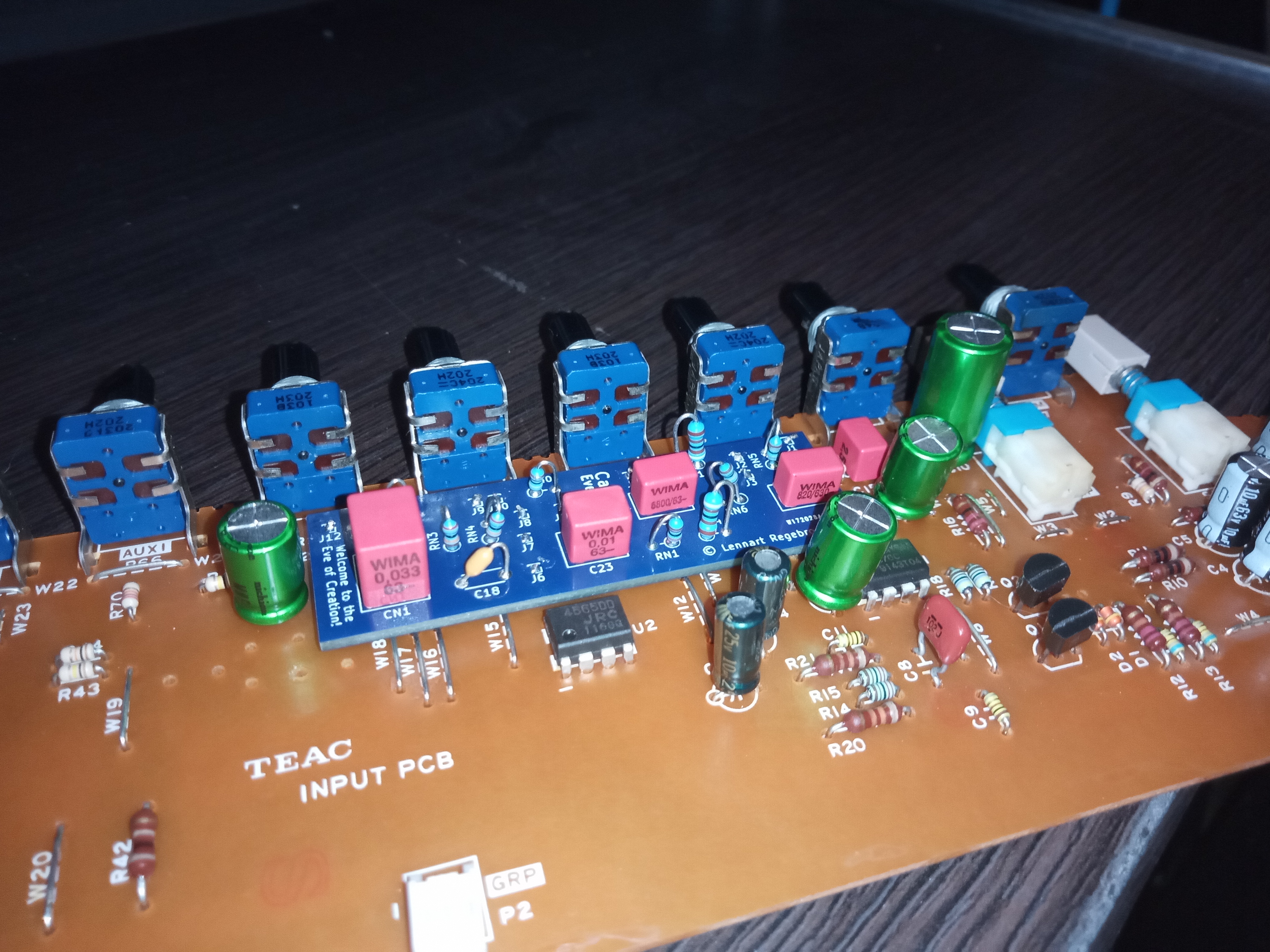

So, final update and conclusion.
Was it worth it? For me, yes. For others? No. Because for me the cost was just a bunch of new caps, resistors, and a few small circuit boards I made. And most of the caps you can skip, the recapping made no difference.
Was it worth all the WORK though? From a commercial perspective, absolutely not, this probably took at least a 100 hours of work. But I enjoyed it, and I learned a lot.
Was the end result better? Oh heck yeah. I find the new EQ (designed by Cabirio on gearspace to have curves a more like a Neve) a lot more musical and easy to use.

The circuit board.

PostPosted: Thu May 06, 2021 10:54 am    Post subject: Reply with quote  Mark this post and the followings unread
I'll attach the final schematic. The full thread is here:
https://gearspace.com/board/geekzone/1328083-could-i-improve-eq-my-mixer.html
