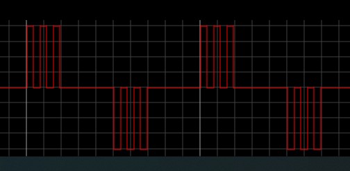

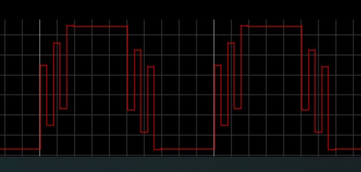

The first image is the original waveform with the second stage added at full gain and delay. The rest of the images just add another stage to the previous image with full gain and delay. The difference between odd and even numbers of stages is interesting.
p.s. these images are in reverse order. oops!

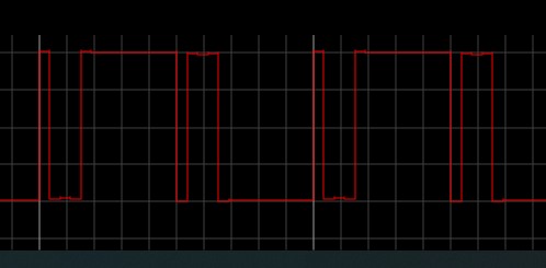

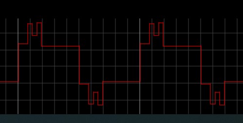

Here are some more waveform images which are just me mucking about with the gain and number of stages. I left the delay at maximum on each stage so it is easier to see what is going on.
