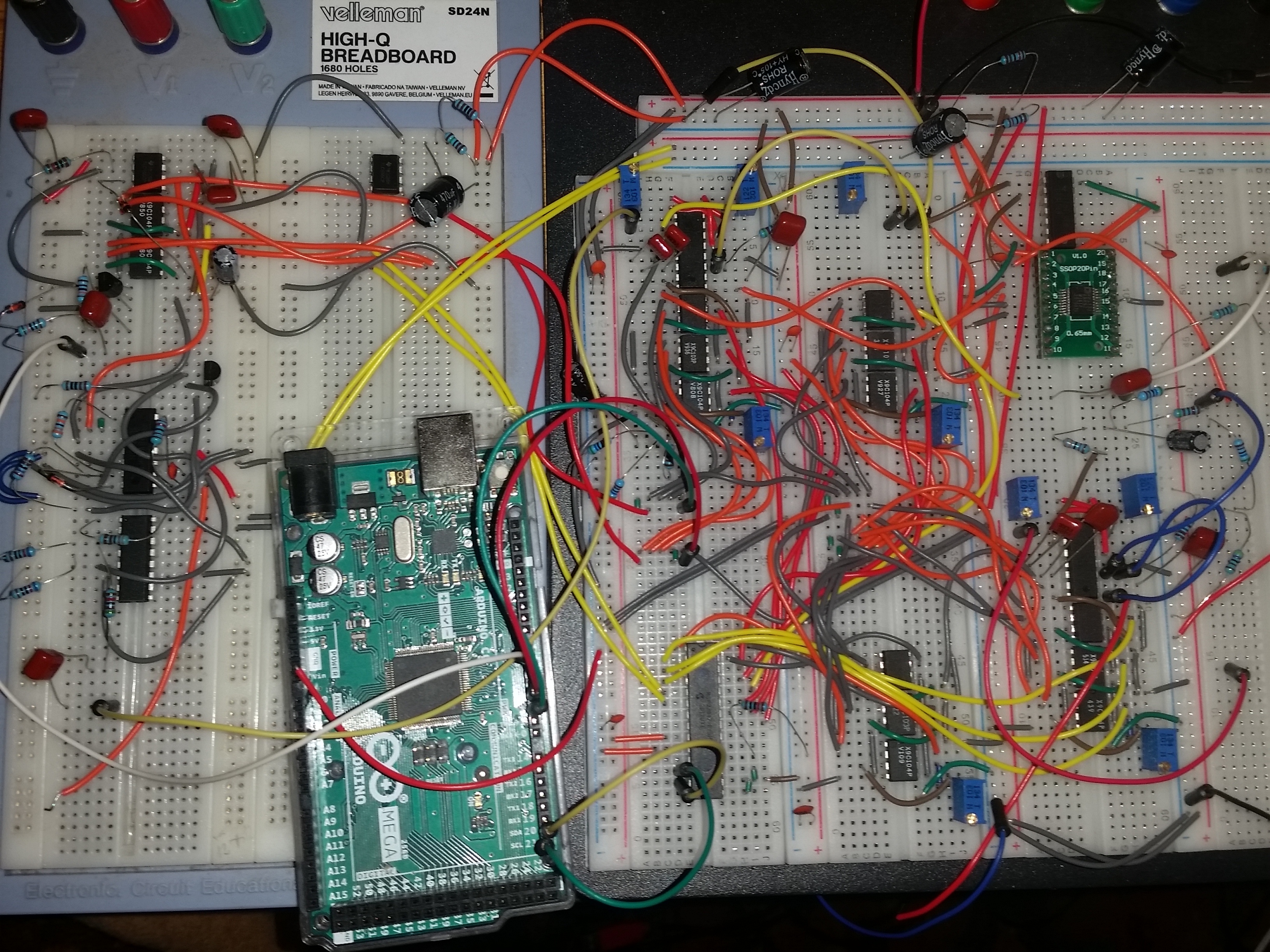

Hi, I am currently designing a double VCO XR-2206 based synth.
It works pretty well.
Instead of controlling the osc. frequency by CV,
i decided to use discrete R levels for pins 7 and 8, implemented by
X9C102, X9C103 and X9C014 digital pots and a trimmer pot, for each subosc.
I would go to the route of using a digital pot everywhere for control, trimmer pots aside.
The switching times on full range of the X9Cxxx pots is on the order of less than 100ns per step
so it does not seem audible when switched as fast as possible by the Arduino.
The other advantage is saving the pots configuration in case of power failure (each pot as a non-volatile memory, but with a duty life of only 100 000 cycles per bit of memory (each pot has 7bits)
Other than that an Arduino would require controlling DACs to output many CV, which would be more costly, I think.
The absolute tolerance of these digital pots is advertised to 7V DC, and a few mA (4 mA I think)
in terms of current, the ltspice simulations do not show any large currents flowing.
this setup is duplicated for the second XR-2206 chip.
The digital pots are controlled by a MCP23017 demultiplexer, itself controlled by an arduino mega.
Then I implemented hardsync.
In the current setup both XR-2206 chips are self-keyed to obtain a triangle/saw output.
The master VCO sync (0V to Vdd square wave) signals follow the high going SAW/TRI output of the first subvco (with a level of Vdd) and the low going SAW/TRI output of the second subvco (with a level of GND since I use a single rail psu)
in order to retrigger the slave VCO, I need to supply an inverted sync signal orginating from the slave VCO to the keying output.
Supplying this inverted signal is done through a SPDT switch (ADG333A) controlled by the master VCO sync signal, either supplying the non inverted slave sync signal or the inverted slave sync signal (passed through a schmitt trigger inverter (CD40106B))
As of today, the master VCO is not retriggered by noteon MIDI signal, As well, there is no audio routing and switch between self-sync, external sync (sub-osc select), hard sync for both VCO chips. Only hardsync of self-synced master vco to self-synced slave vco on the prototype breadboard.
Although the EDA project is more advanced on the EasyEDA page.
For the results, the sound is analog sounding, and the SNR on the breadboard is 24dB, so it is quite noisy but this is due to not really careful construction.

Attachments to the project
Breadboard project with Dual VCO, 555 envelope and LM13700 VCA
 Filesize:  2.87 MB
 Viewed:  477 Time(s)

A quick update.
Now that MIDI is working, I put the synth to test in order to check that the digital pots were working ok.
The potential problem with them is that they do not give feedback on the values they are set in digitally. and I provide a wiper change value, not a wiper position value. State has to be maintained by the Arduino.
However, they can be setup to remember their state at power off.
So it was critical that they do not miss a change of values or the whole thing would get out of control fast.
For now, I ran a midi pattern loop for 1 hour and it did not flinch.
Another note on the XR-2206, The datasheet indicates that the frequency of oscillation is 1/RC, From my tests, it does not seem to provide good results. so I had to sample all notes from C3 to C7 and run a curve fitting in python to get a polynomial equation for each sub oscillator. It works better.
That would make the XR-2206 worthy for a general note based synth and not only for fx.

I finally managed to dynamically autotune the self-keyed oscillator. (for pw modes / saw modes)
The trick was to tune the suboscillator with the highest frequency component first using the calculated ideal value for this component frequency,
and the suboscillator with the lowest frequency component; comparing the total measured frequency to the fundamental goal frequency, while maintaining the computing of the dynamic potentiometer step size on the basis of the derivative of the hertz to R function, times the difference between the ideal component frequency and the measured component frequency.
This is basically a trivial gradient descent algorithm, where an approximation of the function is known and so its derivative.
The downside of this method is that the duty cycle obtained may be quite off from the ideal goal.
Also,
I used a patched pulseInLong Arduino function using the Timer2_counter library that has a 0.5 usec resolution instead of the standard 4usec resolution for micros()
https://www.electricrcaircraftguy.com/2014/02/Timer2Counter-more-precise-Arduino-micros-function.html
Also, I used a zero-cross method frequency counting in the helper python script using the sound card and compared it to the PulseInLong results.
The small deviation was curve-fitted and added to the Arduino code to improve measuring accuracy.
Now worst case scenario is 2 cents deviation in pwm mode
with a mean of 0.5 cent !
Will say victory however after testing various pw settings (now used 0.75)

A little follow-up on the PWM by LFO using XR-2206 self keying.
As I said earlier last year, I made the decision to use a DAC for fine frequency control (using a DAC offset) with a superimposed DAC wavetable to modulate frequency of both sub-oscillators in a PWM by LFO control mode.
A wise choice. It works flawlessly.
A DAC is almost mandatory because the LFO waveform to obtain a PWM is not of the "a*sin(2pi*f*t + phi)" but, to keep it simple, it's the inverse.
"1/sin(2*pi*f*t + phi)"
An analog LFO to PWM would require a log/antilog opamp setup, and any deviation from the required LFO voltage would induce spurious pitch change superimposed on the PWM.
The only downside for now is when the DAC output is constrained to 0, 3V to be secure, the PWM range is quite underwhelming. (total +/- 225 Hz around center duty cycle) which give low depth at high frequencies.
I'll probably push the voltage range a bit, and measure the timing pin current so it stays safe to push the frequency tuning range by the DAC.
Another solution again would be to lower the DAC output impedance, but at the expense of fine tuning precision using a fixed DAC offset. The goal being to be under 2 cents. Using this constraint, the minimum impedance was determined to be 33kOhms for 12 bits DACs.
16 bits DACs would be perfect, but bulkier and relatively expensive for a low-cost synth.
Other than that, only 2 x 100KOhms digipots are now required, and a sequential lookup table setting from 0 to 199 (using 2 x 100 steps) is mapped to the coarse frequency for each subosc and stored in flash.
fine frequency tuning is obtained by adding a DAC voltage offset.
DAC control over fine frequency tuning is really linear. the best is to output the DAC steps to frequency shift map using the arduino to a log file and use a python script to compute the linear regression and get the precise voltage to frequency gain.
Lesson learned, there is no use in measuring the capacitor and resistance to determine the voltage to frequency gain in VCO mode, even more so since my measuring equipment is not under 0.5% precision. I tried this approach first and could not get PWM without pitch deviation artifacts.
The empirical determination of the frequency gain that makes autotune deprecated because tuning is adequate at once.
There are no unknowns or lack of precision either in the coarse tuning step and the fine tuning step.
Finally, I ported the code to an Arduino Due and think of using FreeRTOS to schedule the multiple DAC in real time to limit any lags from another task or event.
As always, check github.com/rodv92/synth1 for code updates, and the documentation / project manifest.

The two XR-2206 IC version of the synth is now controlled by an Arduino Due.
computes faster, and has plenty of SRAM that was going low on the Arduino Mega 2560.
Also, added a Winbond Flash 32 mbits module to store data. The Due also has two 12 bit DACs that may prove handy.
I was thinking of using a realtime OS like FreeRTOS but the quanta of time is quite long. I primarily intended to use it for updating the DAC values while doing other tasks but I may have to write a custom scheduler, or use a dedicated MCU for DAC management.
Also used a JFET (J112) driven by an op-amp differentiator (using one of the SYM pins of the XR-2206 as input voltage and the other the AD enveloppe voltage generated by the 555 AD enveloppe) to provide sine to triangle waveshapping on one of the XR-2206 chips.
But I have Not enough space anymore to expand the project without it being unmaintanable.
Now I guess is time to write it all down and finally prepare a PCB.
What you can hear is the result of the two OSC mixed, one is one octave above the first, and I used midi controls through the sample to alter the mix between the two oscillators. Wave shapping on OSC1 (lower octave) is driven by the VCA AD Enveloppe.
The characteristic glide you can hear comes probably from the capacitors on the DAC lines
The pulse width is set at 0.25 for boths OSCs
Also the DAC to provide fine tune is a 4in1 MCP4728 module, previously a MCP4725.

PostPosted: Thu Aug 19, 2021 2:59 am    Post subject: follow-up Reply with quote  Mark this post and the followings unread
On the setup, I noticed frequency instability (quite frank) caused by the use of Digital Potentiometers. This happens even at rest when there are no signals on the INC, UD pins.
When disconnecting the DigiPot line and putting a resistor the frequency is stable.
Inspecting the digipot line on the scope showed heavy broadband noise from 30 to 1 Mhz or more, with peaks at 66.5 Khz (from the I2C bus coupling onto the supply) and at 240 Khz.
Putting a filtering capacitor on a current line does not help and jams the output audio signal, neither decoupling on the power pin of each digipot.
However, choking the digipot line closest to the timing pin of the XR-2206 (I used inductors at hand, 2.2mH) solved the problem entirely.
I was worried that it could induce non linearity on the frequency response, or even resonances, but it didn't, The only thing resulting is a slight downward offset in frequency tuning. That was corrected by recalibrating (storing the coarse frequencies for each digipot step into flash) for proper tuning.
Then, computing the actual voltage to frequency gain of the DACs got a lot easier without all that frequency instability.
The result is (at least) a one step tuning without any need for frequency measure and feedback. and PWM without any pitch bend artifacts.
