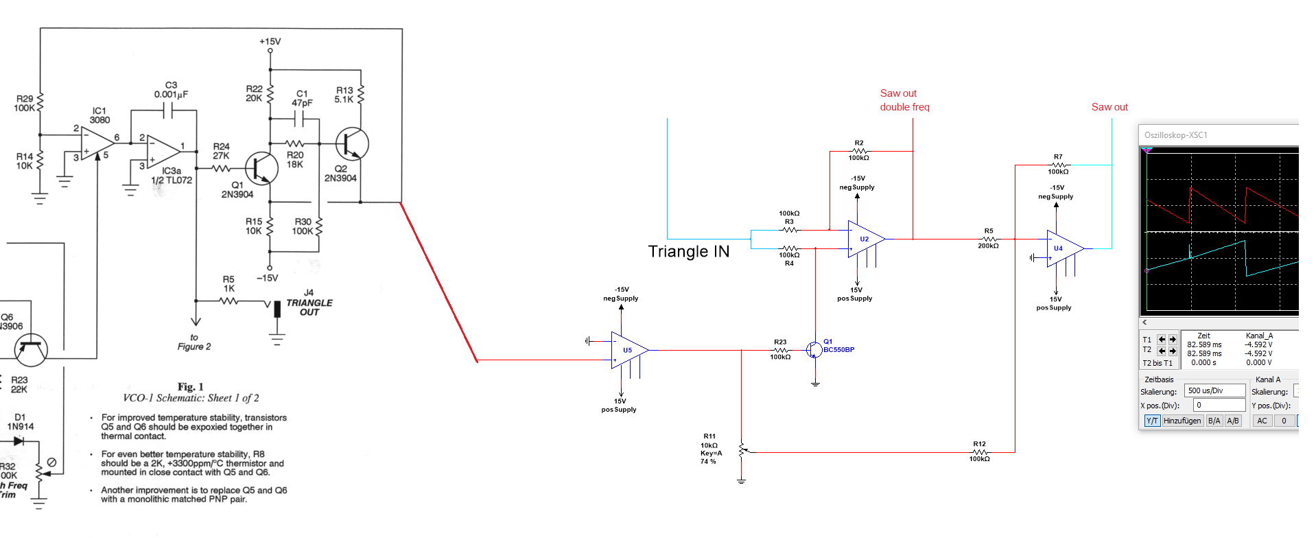

Hi there,
I have 2 of Thomas Henry's VCO-1 in my modular and I am very happy with those guys. The only thing missing is a sawtooth output. Is it possible to improve this circuit by adding sawtooth out?

totaly unexpected i got access to a real computer,
not that fcking phone,
so i was able to draw something

I was not around for a while and haven't seen your reply. Now I am back and thank you so much for the schematic. I will add this improvement.
Another question is that:
The tempco on the original schematic is 3500ppm. I haven't got one but few 3300ppms. Will they also work? Can I use 3300ppm?

PostPosted: Fri Nov 19, 2021 11:06 am    Post subject: Reply with quote  Mark this post and the followings unread
Thanks. Actually, I realized that the schematics says it is 3300ppm. But on the website it is written as 3500ppm. Maybe a typo ... I used the 3300 and it works great. Now it is time to add the saw converter you drew.
