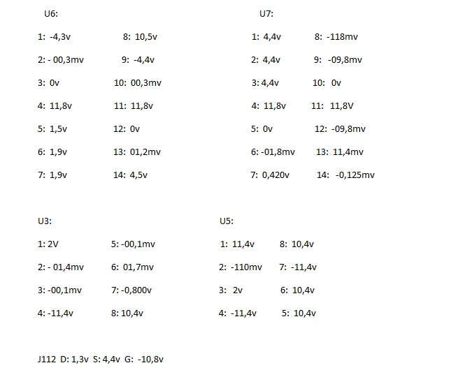

How do i measure this? Sorry I'm an amateur!
Here I still have some values ​​from my ICs:

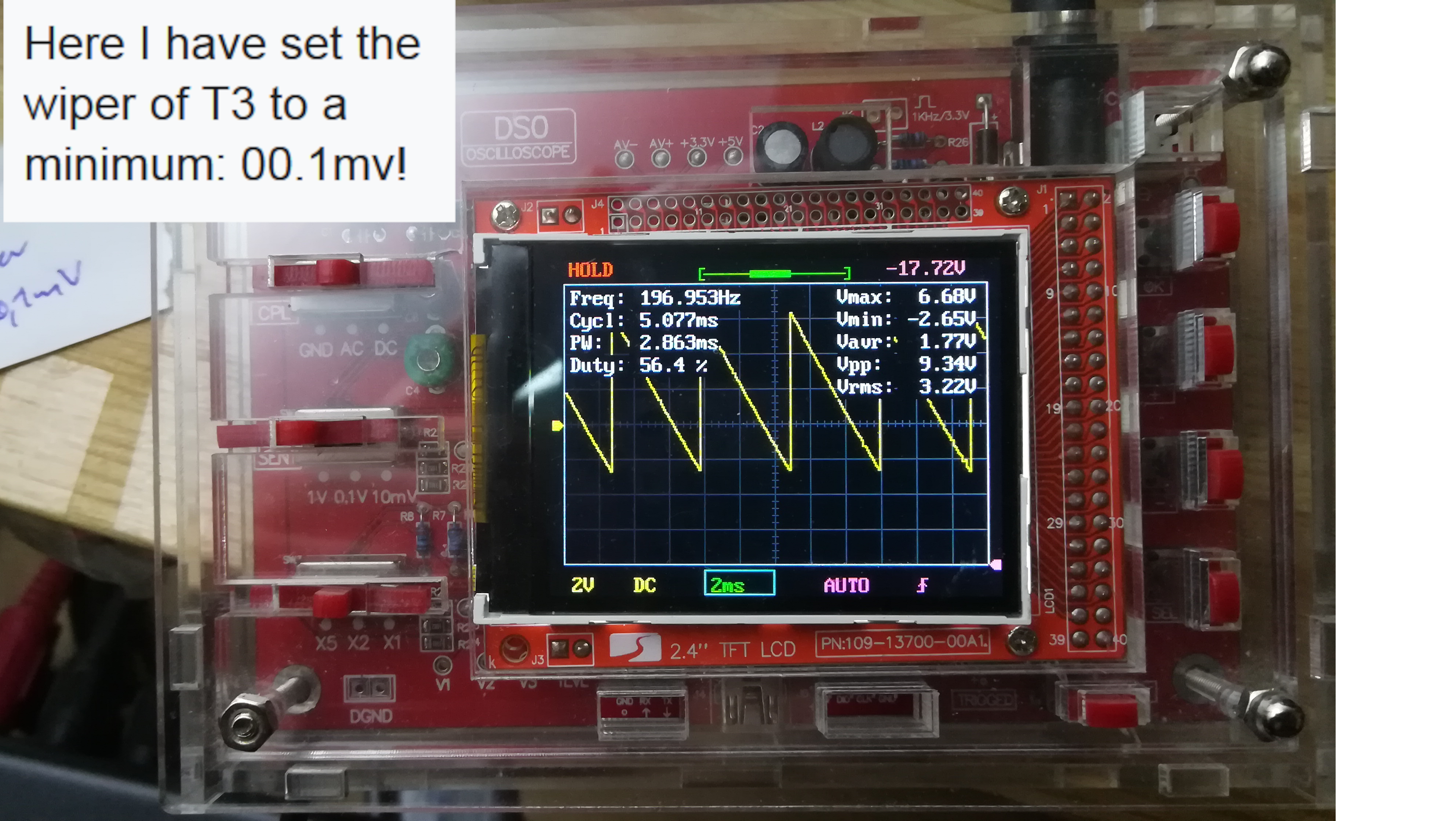

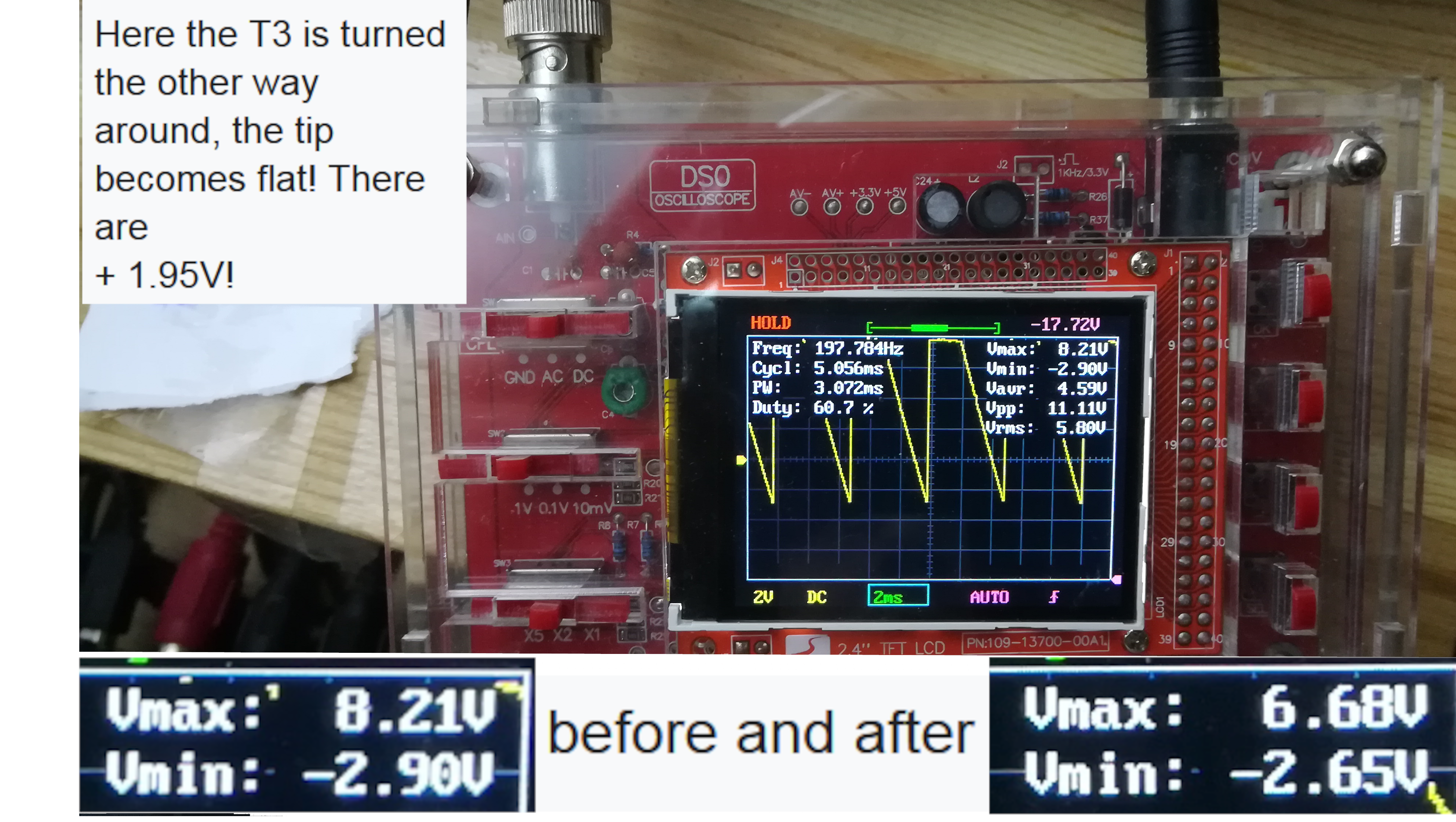

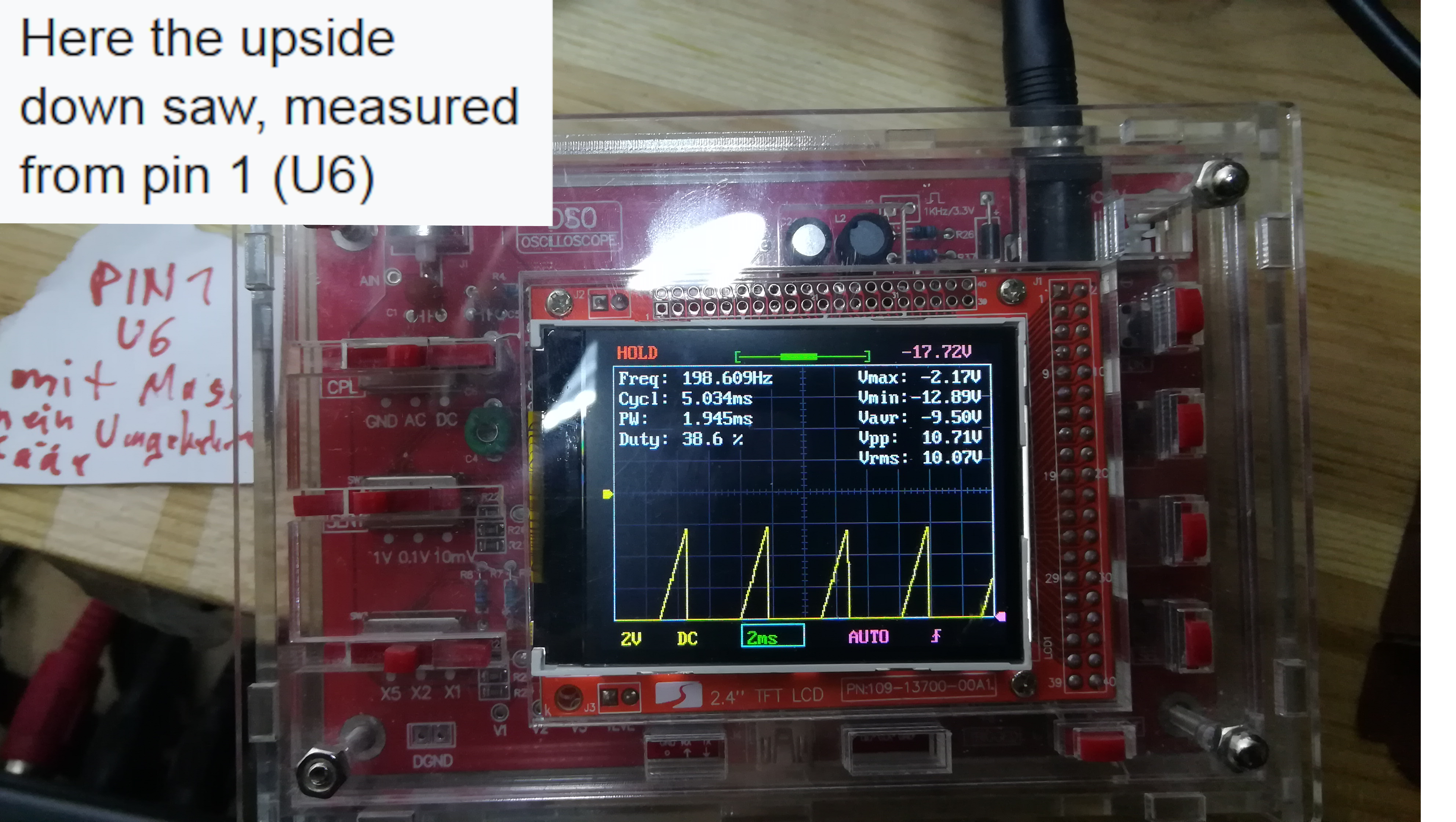

PostPosted: Tue Nov 30, 2021 4:58 am    Post subject: vco Reply with quote  Mark this post and the followings unread
Send you pictures here in the hope that you will recognize my difficulty! My trimmers as well as R23 and R50 are socketed with me can simply take it out for test purposes!

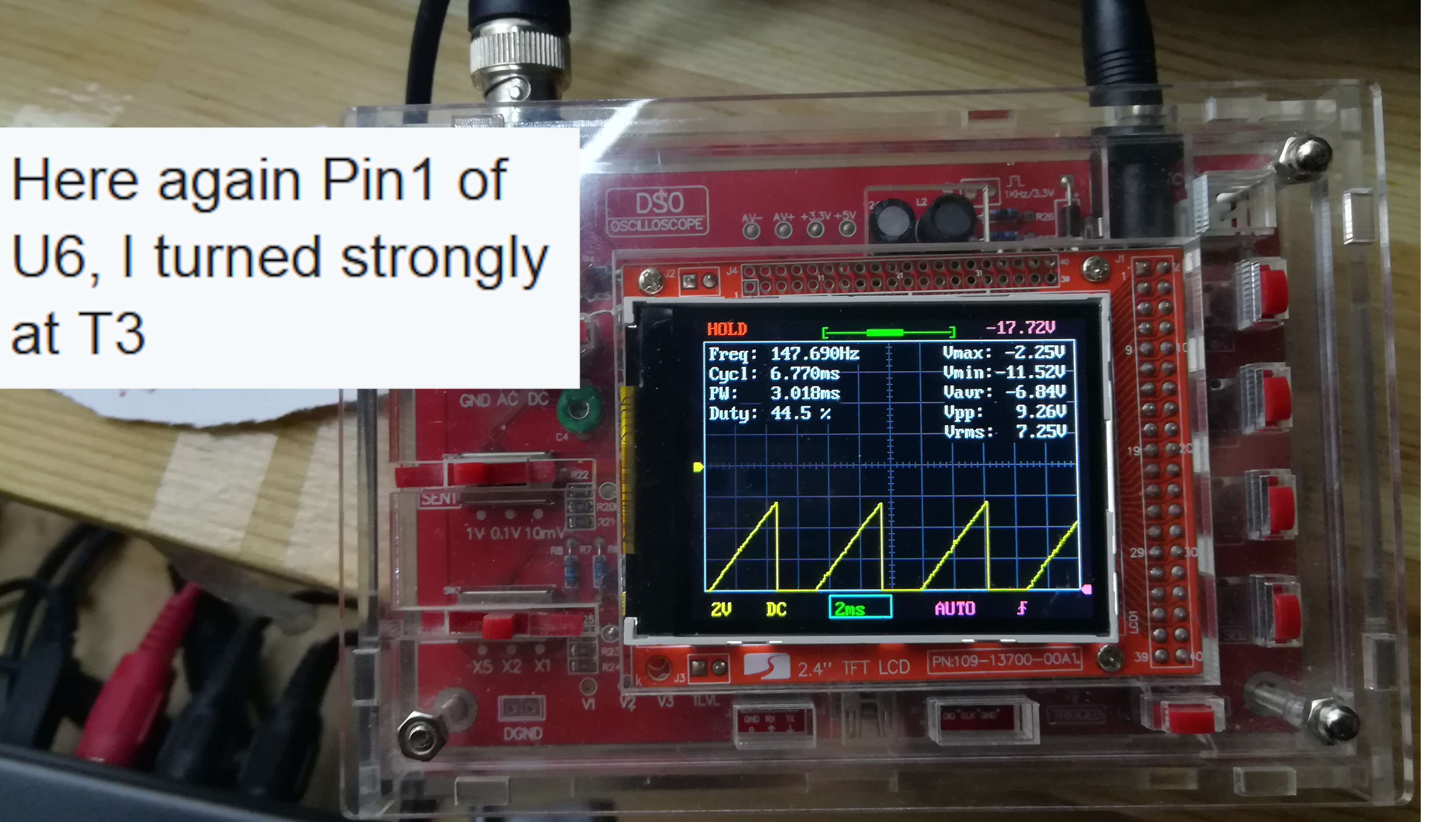

 Filesize:  6.89 MB
 Viewed:  241 Time(s)
 Filesize:  7.24 MB
 Viewed:  267 Time(s)

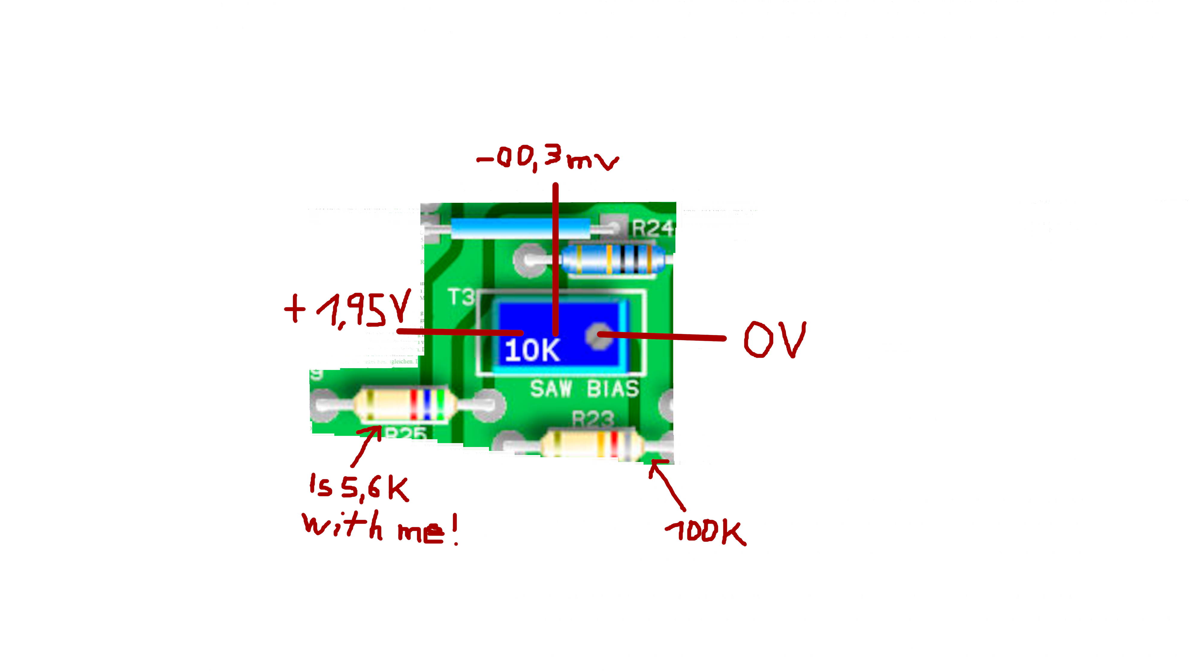

I think something is wrong with the wiper, it's only -00.3mv, it seems to be suspiciously little, I will measure the value of the r25 again (unsolder one leg). I could also try 82K (R23) as yusynth suggested, or What do you think ?
Posts: 1438
PostPosted: Tue Nov 30, 2021 11:34 am    Post subject: Re: vco Reply with quote  Mark this post and the followings unread
Yes, the wiper should vary from 0v to around -7 volts.

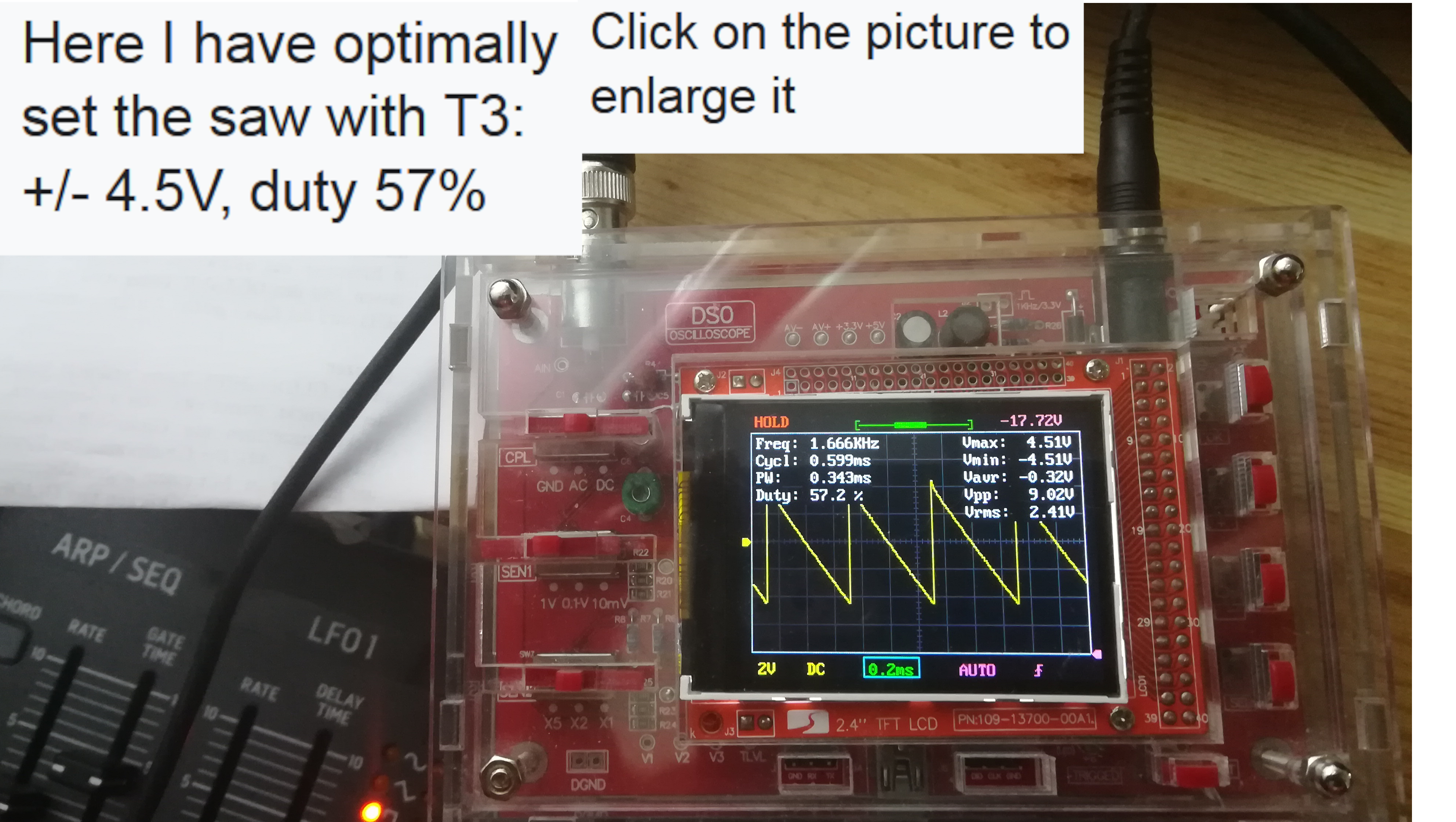

With your help I concentrated on the T3 and now noticed that the right side of R25 (5.6K) was short-circuited to the left side of the T3! Thanks for that ! I get a balanced saw, unfortunately the saw is broken again if I set the triangle well. There was a possibility for me to make all waves (Saw, Trianle, Sinus) look and sound good, but there were no 5v +/- in the waveforms, Sinus for example: 2v to 6.8v (total: 9v) I have with Sinus 1V too much? If so, could you possibly give me a hint where I could adjust a resistor?
Sorry that I write so much and annoy you
Posts: 1438
PostPosted: Wed Dec 01, 2021 6:53 am    Post subject: Reply with quote  Mark this post and the followings unread
Good work! Suggest you adjust to to get a good sawtooth then see if you can get a good sine and triangle by adjusting T4.

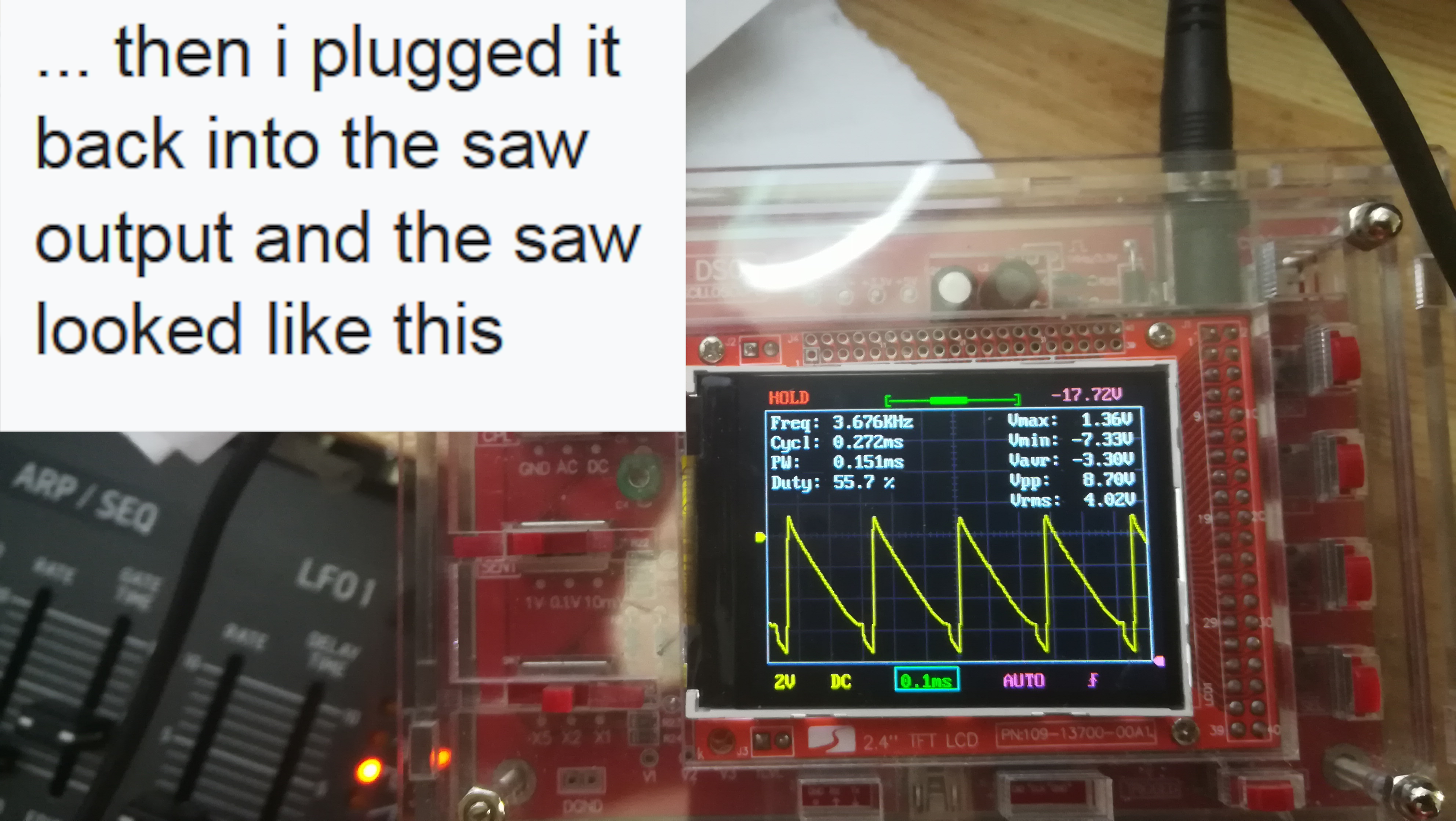

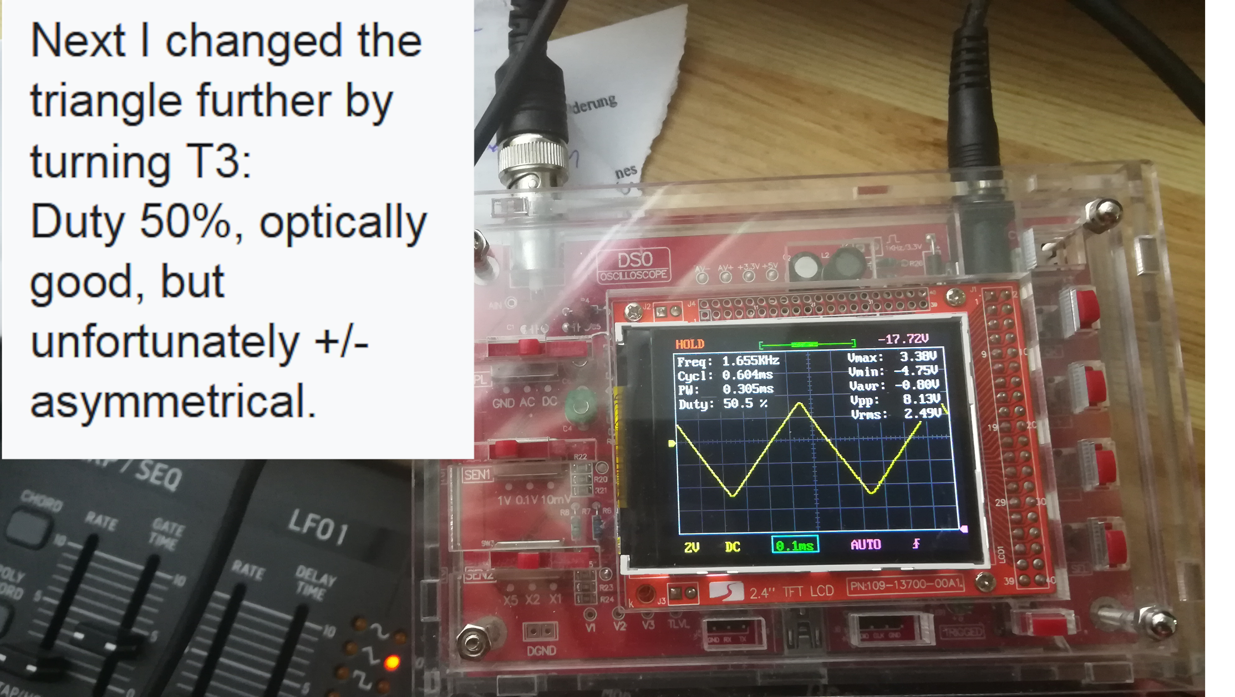

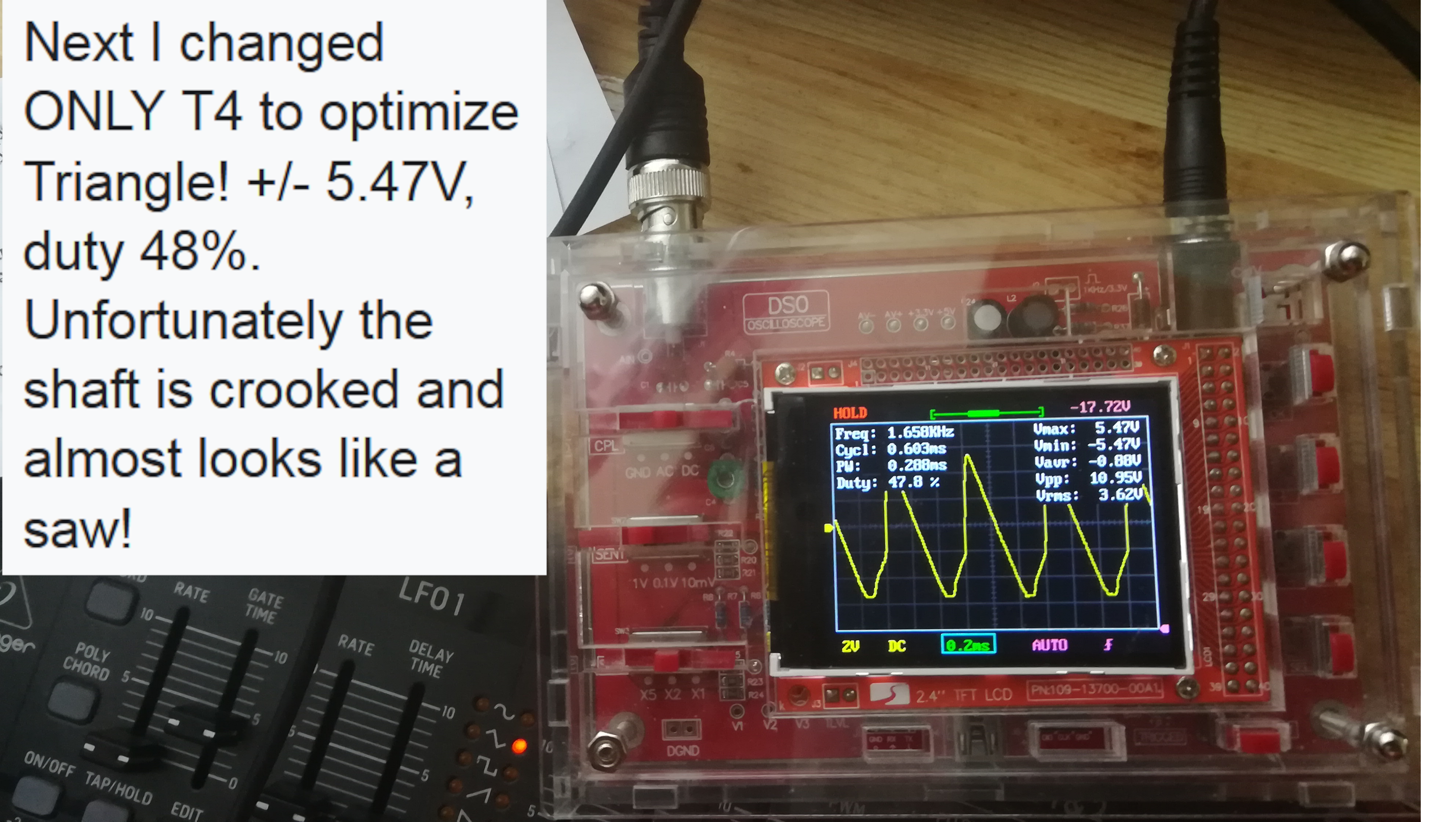

PostPosted: Thu Dec 02, 2021 7:02 am    Post subject: vco Reply with quote  Mark this post and the followings unread
Thank you for your feedback and for your patience!
I work with 12v (Eurorack module)!
I'll send you photos again here, should show how I checked / worked: and what results came out of it:
No short circuits on R4, R44, R29, R31!
U7 Pin1: 4.4V
Maybe you have another idea?
This vco is a
Affair of the heart, it sounds great!
 Filesize:  6.4 MB
 Viewed:  158 Time(s)
 Filesize:  6.58 MB
 Viewed:  168 Time(s)

PostPosted: Sun Dec 05, 2021 11:25 am    Post subject: vco Reply with quote  Mark this post and the followings unread
Hi there,
Thank you for your feedback signal !
I went through the IC again here News:
U6:
Pin1: + 0.95v 2: + 10mv 3: 0v 4: + 11.8mv 5: + 1v 6: + 1.9v 7: + 1.9v
Pin8: -2v 9: + 0.9v 10: -00.1mv 11: -11.9v 12: 0v 13: + 01.1mv 14: -0.9v
U7:
Pin1: + 4.4v 2: + 4.4v 3: + 4.4v 4: + 11.8v 5: 0v 6: -00.5mv 7: + 1.8v
Pin8: -0.51v 9: -0.3mv 10: 0v 11: -11.9v 12: -50mvv 13: -53mv 14: -0.58v
U5:
1: -11,4v 2:-108mv 3:+2v 4:-11,4v
5:+10,4v 6:+10,4v 7:-11,3v 8:+10,4v
... I think it should be ok!? That I, among other things, the 10.4v from the LM311 should also be ok, I remember it, even old forums report on the vco.
No component gets hot, not even the voltage regulator!

PostPosted: Sun Dec 05, 2021 2:12 pm    Post subject: Reply with quote  Mark this post and the followings unread
Well, I've not built this, so can't comment from experience, but given your problem seems to be that your waveform is not symmetrical about 0V, I was looking for any DC asymmetry. If the voltage output from the 78L12 is 10.4V too, then that might be OK.
Another possible issue is the voltage at pin 3 of U7 -according to the schematic, this (and therefore the voltage at pin 1) is meant to be +5V +/-2% ie between 4.9V and 5.1V, but your readings are +4.4V. The fact that Yves made that note suggests the value is quite critical. (Though I am not sure the calculations there are quite right. With R49 and R50 forming a 1/3 voltage divider, Vcc would have to be 15V to yield a 5V output, but the regulator only produces about 14.2V, which would produce 4.7V at pin 1.)
Still if you only have Vcc =10.4V, and are using 68k and 50k, you would expect just 4.4V (as you do), which may be too low. I'd suggest you try changing R50 to 60k or even a bit less, getting the output of U7 as close to 5V as you can. Actually setting R49 and R50 to the same value would yield 5.2V, which might be fine?
