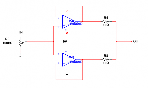

First of all the LM386 is not an opamp though it is usually drawn in the same way so keep that in mind. The LM358/LM324 is often used because it is
easily obtainable, cheap and most importantly it works well on a single supply since its output can practically go down to 0V. It's not the best opamp
for audio but for most purposes it will suffice.
If you have an output directly from a CMOS chip and everything is working on 5V you don't need any voltage amplification but buffering can be useful,
it depends on what you want to drive with it. If you want to connect it directly to a speaker you'll need to be able to drive a low impedance with a bit of
current which an LM386 is good at. A line input on the other hand should have a pretty high impedance (>10K) and also doesn't require much voltage,
5V would actually be too high. So you can just connect a potentiometer to the output of a CMOS chip and then connect it directly to a line input.
If you add a resistor between the CMOS output and the level pot it will limit the maximum voltage and at the same time protect the CMOS output
against any shorts. You could add an AC coupling capacitor after the pot but line inputs should already have those. If you want to connect it to another
circuit you will have to look at how things are biased and you may or may not need AC coupling.
If your signal comes from a resistor network (like an R2R) then it's better to buffer this first with an opamp configured as a voltage follower. You could also
use a transistor but that doesn't work so well if the voltage level is very low and you need some precision. You can also add a buffer after the level pot
which has the advantage that the output impedance stays constant and because it's also pretty low it is capable of driving more without causing a voltage drop.

PostPosted: Sat Jan 08, 2022 10:57 am    Post subject: Reply with quote  Mark this post and the followings unread
if i read headphone and stuff like that , i think of buffer
i had some luck with this circuit, in reality ive used a quad opamp
simple enough to try it?
 Filesize:  16.95 KB
 Viewed:  325 Time(s)
