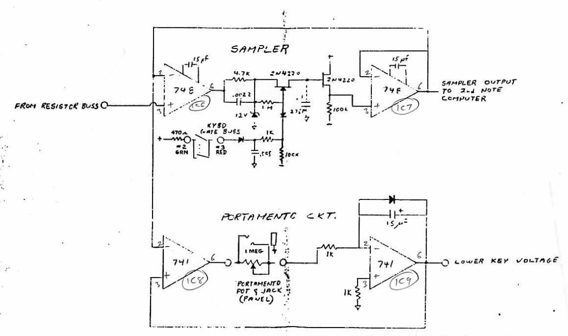

I'm restoring an EML-101. I have everything working great except the keyboard sample & hold. Maybe someone can help....
The S&H mostly works fine, except when you take your finger off a key (not gated) the voltage instantly goes down very slightly. I recall hearing this in the past, but don't recall an answer. Before I go replacing everything, has anyone seen this before or have any suggestions?

Posting the schematics or at least a link to that schematic will give you more and more adequate answers….
Good point...
Note that this is a two buss keyboard - one voltage and one gate.
 Filesize:  65.27 KB
 Viewed:  205 Time(s)
Posts: 24524
Audio files: 299
PostPosted: Sun Jun 05, 2022 8:32 am    Post subject: Reply with quote  Mark this post and the followings unread
Ah .. it is old right? may be the S&H storage cap gone bad? (the dotted unreadable contraption)
That was my first thought after seeing a few articles on S&H capacitors. It's the easiest to try first of course.
I also suspect something funny in the gating circuit. I'm not sure what that diode / RC network on the JFET is doing exactly, but maybe that cap is holding a charge too long after the KB resistor string has been released? Dunno.
Also, it's not like a droop where the voltage dies off slowly. It's a sharp and fairly consistent little pitch shift of a couple annoying musical cents.

Hmm yeah .. could also be that the gate signal does not go low fast enough .. maybe a scope could tell .. but then again .. switching out two caps would be a quick test too :)

When using a scope: NEVER try to read the voltage over the timing cap (the probe will drain this capacitor)
