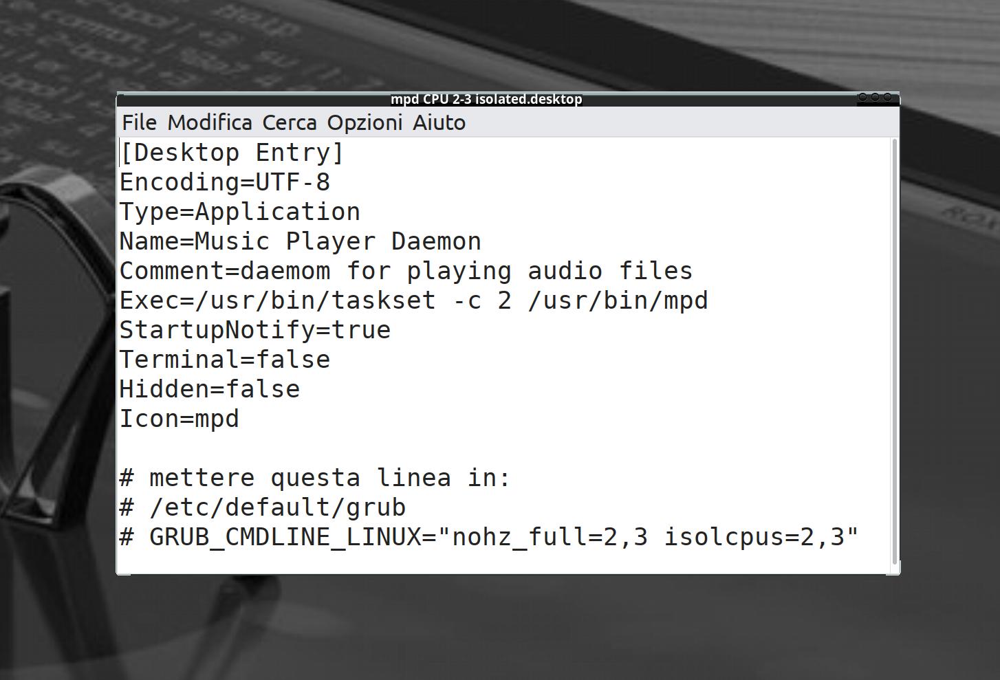

For smooth real time audio it is necessary to zero out random jitter. Disable and circumvent CPU-threading for system and streamer.
If two threads correspond to a physical CPU, the CPU noise will also be separated. There would be two CPU situations for this configuration:
1. CPU SIX Core technology from ~10 years ago should be 3 physical CPUs; 2 can be dedicated to MPD daemon and 3 sacrificed;
2. 12-thread CPU technology from ~5 years ago with 6 physical CPUs declared (suspected mono CPU); 2 can be dedicated to MPD daemon and 3 dedicated to JACK daemon.
MPD makes much more sense to use just with ALSA for perfect, natural streaming. It would also make sense to lock CPU3 threading for the Linux/Liquorix module of USB-Host. When MPD and Jack are never used at the same time, they can both be locked to CPU2.
Would any system engineer have an idea and advice on how to implement the USB module lock?
