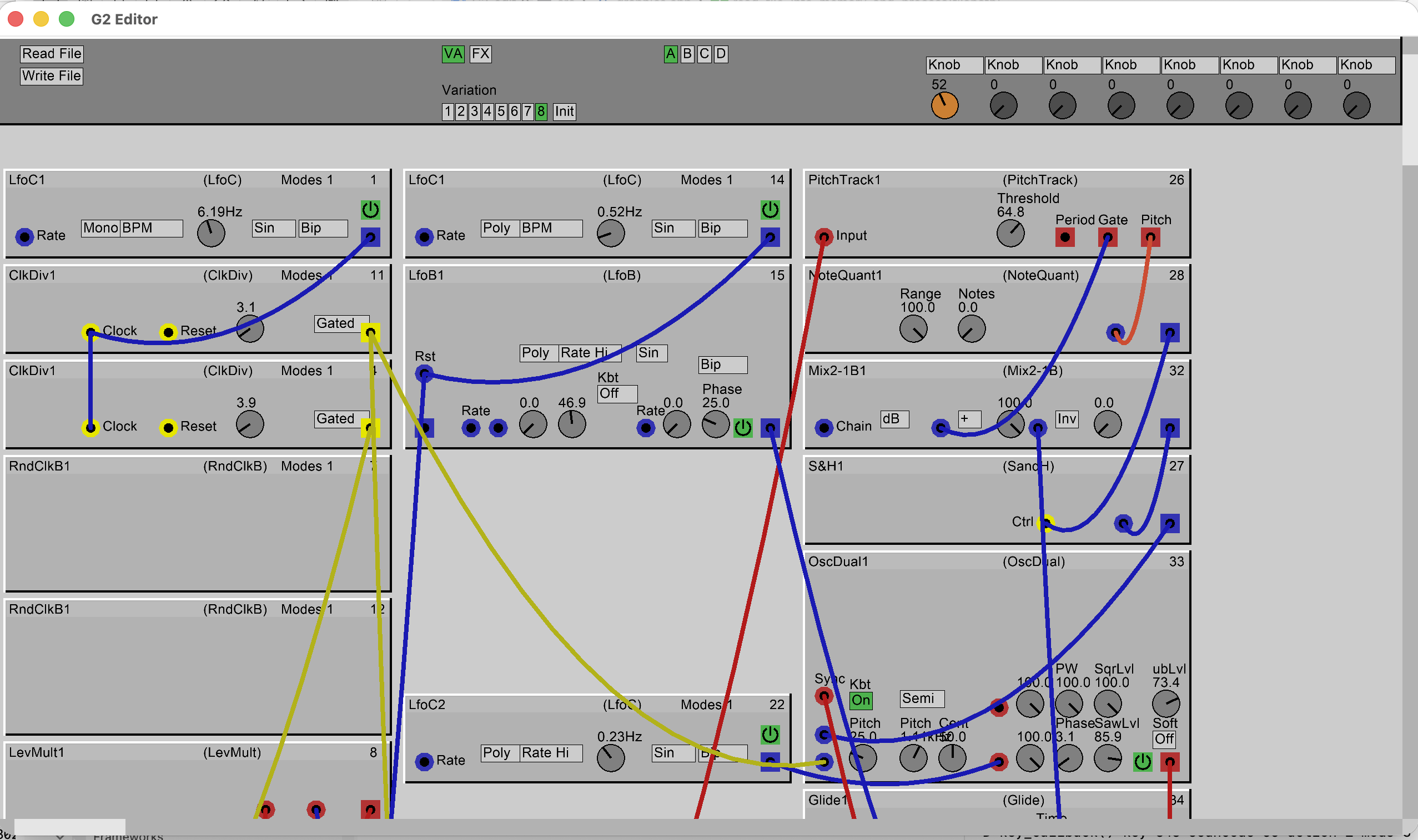

Oh, cool ..
1) thye G2 still works and
2) it loads my latest noodle there into the editor and
3) i can switch variations and
4) some knobs work
5) when the G2 hickups - as on cable edits - when i turn it off and on again it is neatly picked up -- great Exclamation
So. not much luck yet on clicking cables yet.

I've credited Bruno with some of the protocol reverse engineering, but I think I might have corrected a few bits and pieces. 'C' is easier for me to follow, since I've been working with it for 40+ years! Also being in 'C', it's a short step to C++, which I hope is more easily translated to other languages than from Pascal/Delphi. ...or the underlying mechanisms could stay as C/C++, and GUI could be done in a different language.
Otherwise, it's not a port of the other editor. I pretty-much started from scratch, using my own 'C' framework. It's what you might call vibe-coding, but with a fair bit of 'C' experience behind it. I used Wireshark to look at some of the protocol bits and pieces Bruno didn't seem to cover. I put a fair bit of work into the graphics side of things. Really wanted to have a zoom feature for the modules in there, so that was designed-in early.
Cabling should work - at least on the implemented modules btw.
'C' or C++ programmers welcome to help out! As you can see, as a proof-of-concept, all the fundamentals are there.
Right-click also brings up menus in various scenarios.

tried a couple of cables .. just clicking on one alters the sound my patch .. so it works in the sense that it does ... something Wink but I did not try to investigate what goes wrong.
I can not test it now .. but there is no support for multiple G2s I guess?

Cables are drag from one connector to another. Just clicking on one should do nothing. Click on a connector and drag to another…? I only have 1 G2 to develop with, so haven’t looked at multiple units.
You could always give us a patch you’re working on, for me and the other developer to look at?

Yeah, and before you drag you need to click .. and that is enough to make the sound change - I will look into this later - not now ..
I had planned to first have a look at the code in the coming week .. so that I do not need to take a synth with me but just a laptop.
Anyway, later more and no worries or guilt feelings or quick help or fixes .. give me some time please .. it has been (a) decade(s) since I looked into the G2 or the nords in general .. and I was just telling what I noticed.

Cables shouldn’t affect the sound if the linkages aren’t changed btw.
