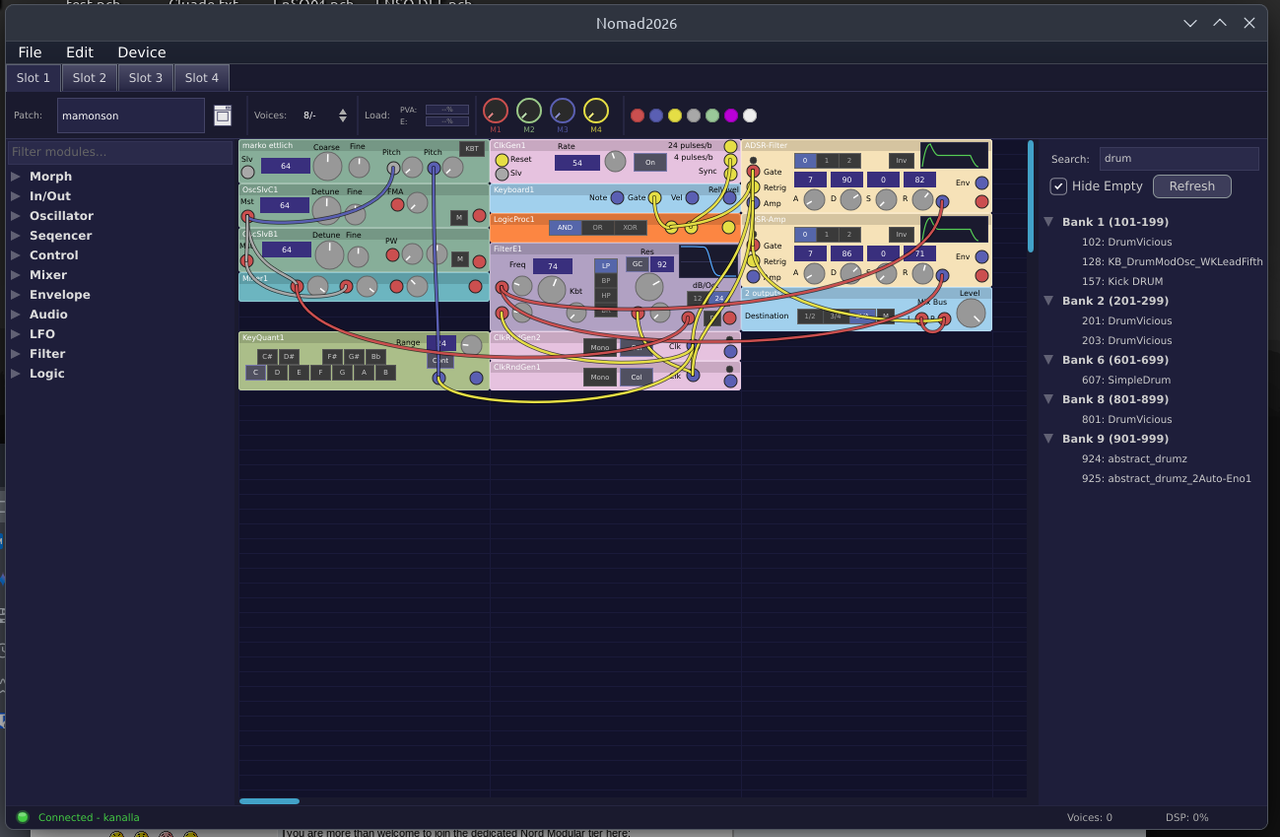

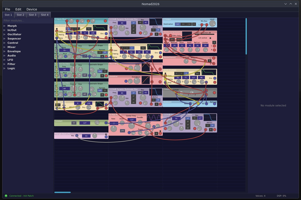

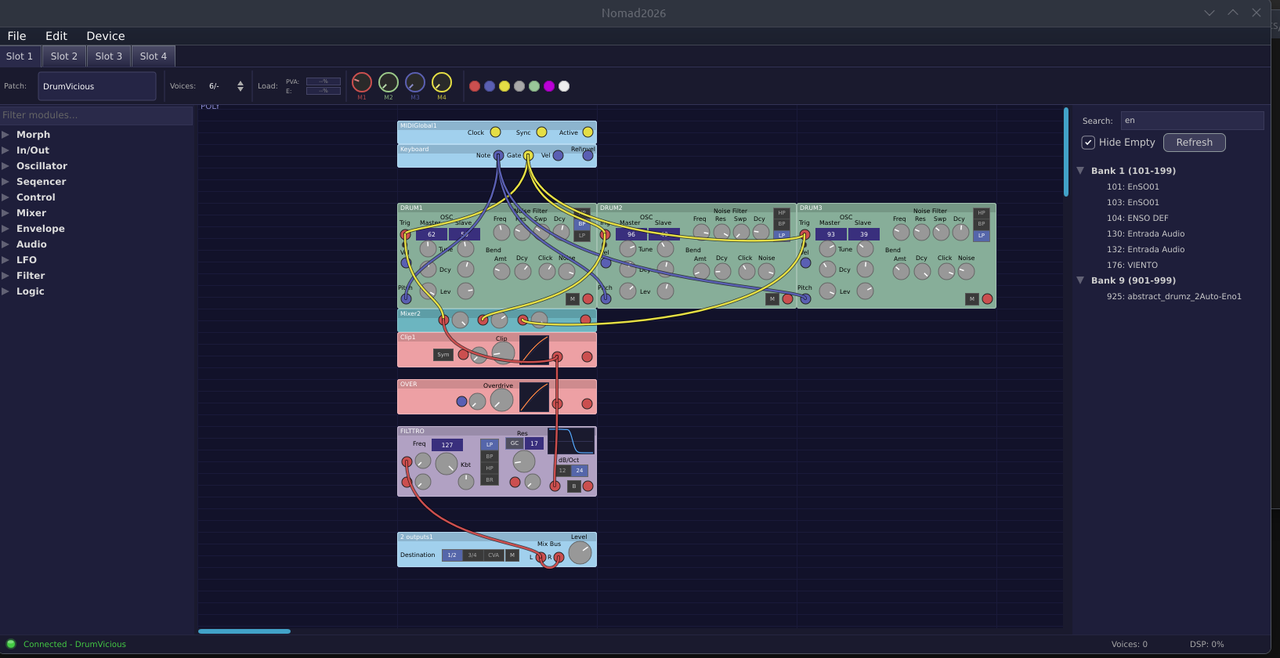

I know this forum has been the absolute heart of the Nord Modular community for decades, so I wanted to officially share a project I've been working hard on: I am developing a brand new, universal editor for the classic Nord Modular G1.
As many of us know, keeping the original editor or the old Java-based Nomad running on modern operating systems has become a massive headache. To solve this, I am rebuilding the editor from scratch using the JUCE (C++) framework. The goal is to have a fast, native application that runs seamlessly on Windows, macOS, and Linux—no Java required!
🛠️ Current Progress (What is working right now):
Developing this alone is a massive undertaking, but the core engine is alive:
The editor successfully connects to the synth and parses the SysEx protocol.
It accurately reads and renders patches, modules, and cables on the canvas.
I recently finished coding the Patch Browser. It now queries the synth, loads all 9 banks (891 patches) in about 3-4 seconds, and features a real-time search filter.
You can double-click a patch in the browser, and it loads directly into the hardware!
(You can see some screenshots/GIFs attached to this post!)
