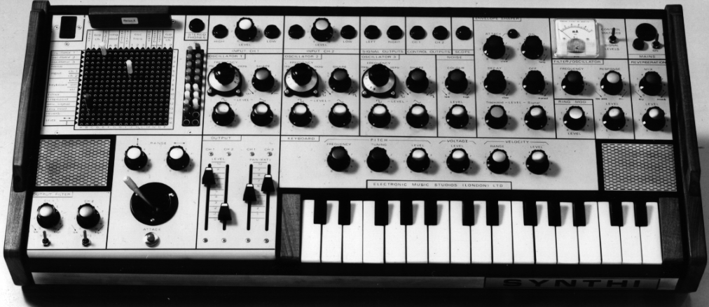

greaseenvelope wrote:
BTW: History lesson people. Del Dettmar was the EMS AKS jockey in Hawkwind. DikMik's setup was always really simple: EMS audio generator, wah pedals, phasers, distortions, spring reverb, and echoplex.
Oh pure joy- my perfect keyboard rig :D
would someone be so kind to send in an mp3 of this G2 patch? would make this aging 38 year old hippy very happy!!!!
ps- here's a nice take on the vcs3;
