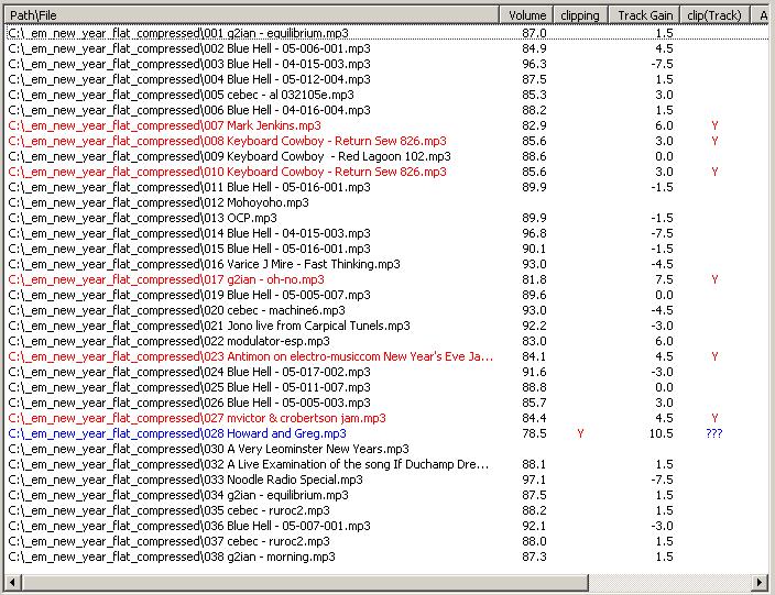

Another related question.
There seem to be errors in the mp3's I have with regard to missing frames and incorrectly adminstrated file lengths, frame counts probably. It seemed to me FooBar could maybe clean that up, anyone who ever tried that ?
A screen shot (really there is humour in that one :-), and it aslo figured out this :
2006-01-02 00:37:18 Error while analyzing: C:\_em_new_year_flat_compressed\012 Mohoyoho.mp3 is an MPEG Layer I file, not a layer III file
If you think this is incorrect, you can try enabling the No check for Layer I or II option
2006-01-02 00:44:38 Error while analyzing: C:\_em_new_year_flat_compressed\030 A Very Leominster New Years.mp3 is an MPEG Layer I file, not a layer III file
.. tadum .. tada ..

Using FooBar to fix mp3 headers seems to solve some problems. This might turn into full blown mp3 restauration course. Damnit why me :-)
Howard's track is still troublesome, this damned VBR thing again I guess, it's about the third time today that one pulled me a leg.
