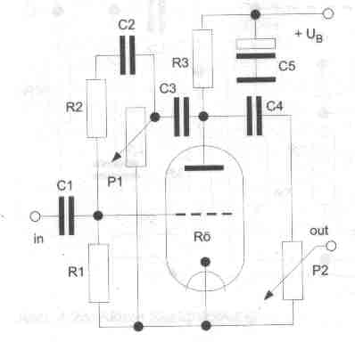

I post u a shematic i discovered in a book. Its a parametric eq working with half a ecc83 (12ax7) tube. That means you can build 2 of those out of one tube and keep things modular as we like it. (paralel/seriell/feedback2-1/1-2/ stuff like that)
The parts (in the book) are
R1 10m
R2,3 100k
P1,2 100k
C1,4 22nf
C2,3 470p-5n
C5 10uf/350v
First of all: for r2 wich is the feedback resistor we want to use a pot. The book gives a warning that this thing can oscillate at some settings. Exellent!
Next we want cv controll. P1 (i think it determines the freq?) is a variable resistor that can be changed by a ldr or fet. here we go.
This calls for some experimentation and tweaking. Great thing is that this is a low part project so its gonna be fun!

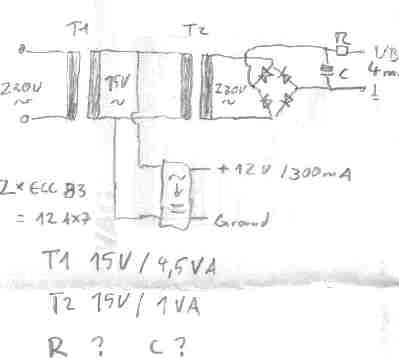

Well, ready to go exept for one thing: a power suply is needed. The one in the posing will work for 2 ecc83. thats 4 eq stages or 2 stages and a booster. Each tube needs 12v*0,15A for the heating and here comes my problem- about 230-270v dc for operation. the good thing: only 4ma (or even less) are needed for two tubes.
As you can see in the shematic 2 transformers are used. the first one provides 15v and it must be strong enough to be transfered to 12vdc/300ma and to power the second transformer thats connected in opposite direction giving 230v (in europe). If you want to try this do not try to transform to more than what you put into the first transformer- the book says so!!!!!!!!!!!
Here come my questions:
230v can be dangerous. at 4ma it should not be dangerous.
How can i protect this ps that it can give no more than say 5ma, even if its shortcut or touched by my unlucky hand? A fuse will do i guess, but it takes some time to blow. can i just limit the current with a resistor?
I still need fuses. where should i place them?
What are good values for r and c in the shematic?

If the ps is limited to say 5 or 6 ma its enough for 2-4 tubes and should not be dangerous. What i don´t know is how to technically limit the current coming from the ps to make it safe. I touched a broken power cable once and i don´t want to repeat that experience...

yes a resistor limits the current [and dissipates it as heat] check this for an 'active' current limiting with MOSFET, acts faster than a fuse!
http://www.geocities.com/tjacodesign/300vsup/300vsup.html
