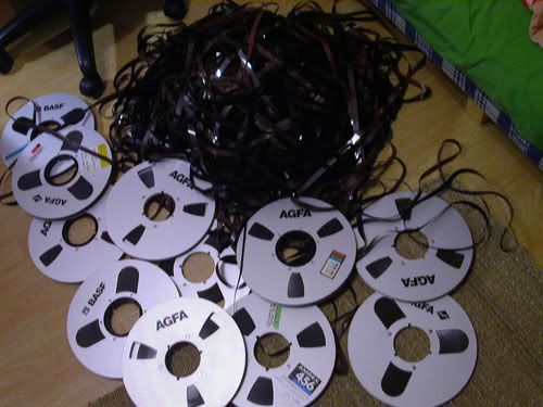

hi there - i found a few reels of PEM 469 and PEM 468
and measured their resistance:
PEM 468 has 1M ohm /10cm (approx)
PEM 469 has 700K ohm /50cm (approx)
so i figured that this could be a good material to be used in ribboncontroller.
so here is the offer - you send me your address and i send you some meters of tape.
