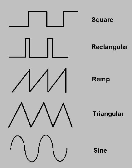

neo644 wrote:
could somebody show me which one is which? i'm kinda mixed up here. i would really apreciate if somebody could show me some graphs.
It should be something like shown in the picture...
I hope this helps...
ladislao

neo644
Joined: Aug 18, 2005
Posts: 43
Location: Argentina
PostPosted: Tue May 02, 2006 7:44 am    Post subject: Reply with quote  Mark this post and the followings unread
hey thanks alot!
just to be shure that i have it okey, would it be like this:
Square == Square
Angular == Rectangular
Ramp == Ramp
Tri == Triangular
Saw == Sine
and i assume the difference between the square and the rectangular si that the rectangular is pwm?

neo644 wrote:
1) Square == Square
2) Angular == Rectangular
3) Ramp == Ramp
4) Tri == Triangular
5) Saw == Sine
I would say:
1) yes.
2) yes, but I'm not sure...
3) yes.
4) yes.
5) no. I would say that a "saw waveform" is ramp or a triangular wave, but I don't know which one is the correct one... and maybe there is another option: a ramp waveform can be shaped in two different ways (see the picture), so it is possible that one is called "ramp" and the other is called "saw"... but I think I'm gving more confusion than help...
anyone else to clear it out?
yes, I think so...
that was my very best... Surprised
ladislao
 Filesize:  7.01 KB
 Viewed:  7516 Time(s)

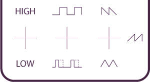

so, here we have it, my LFO switches layout.
i was thinking, how would i use the square/rectangular ? because the other switch doesn't have an "off" position. does this switch, the square/rect overides the other one?
LFO switches layout
 Filesize:  4.68 KB
 Viewed:  7505 Time(s)
Pehr
Joined: Aug 14, 2005
Posts: 1307
Location: Björkvik, Sweden
PostPosted: Tue May 02, 2006 10:52 am    Post subject: Reply with quote  Mark this post and the followings unread
Isn't it: angular == ramp/saw/tri?
So Its either the square or one of the ramp/saw/tri-waveforms.
At least thats how mine works... But the angular-switch must be set to tri to have the square going...

Pehr
Posts: 1307
PostPosted: Tue May 02, 2006 10:57 am    Post subject: Reply with quote  Mark this post and the followings unread
"angular" must come from "angle", which supports my theory "angular == ramp/saw/tri"

neo644
Posts: 43
Location: Argentina
PostPosted: Tue May 02, 2006 5:32 pm    Post subject: Reply with quote  Mark this post and the followings unread
yes, that totally makes sense.
plus, if your sound lab works like that, then there no argument jeje
i'll have to change the layout then
