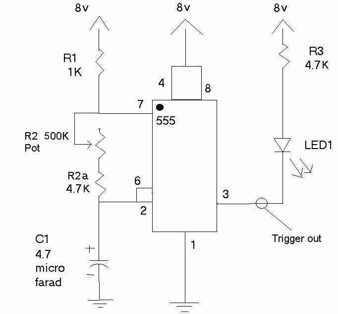

I'm a newbie looking to add a pitch vibrato to my bent Casio SK1 via a vactrol resistor. I need a simple LED flasher circuit that can flash from 1 flash/second up to about 20/second. All the 555 circuits i've seen only seem to flash slow (up to 2/second). Does any one know of one?

You should be able to get a cap value on a 555 circuit to get a faster flash rate on a 555 (in this case, if you're running off of battery, I'd suggest a 7555, which has a mere fraction of the current draw a 555 has).

have you tried 555 timer lite?. freeware that calculates the component values for desired timers using 555 and 556.
here is example whit 6volts (use only 4 AA batteries) and 20Hz (20times/second)
you can tweak the values until you get what you wanted.

Go to my website here:
http://www.mikmo.dk/cblfo.html
There's a 555 based LFO, compleate with VERO board and real PCB layout.
To get the timing you want just experiment with the potentiometer value and the timing capacitor.

Just finished building the circuit, I got a 7555 as you suggested, it's working really great!!
Just for those wanting a similar thing to me, if you look at the screenshot that Daniel kindly provided above, he showed an example 555 circuit with some values for R1, R2 and C1, to give an oscillation value of 20Hz.
I used the program to fiddle some more values, and came up with:
For a LFO range of 0.3 - 30Hz (an ideal range for your standard synth LFO) the values are:
R1 = 1k
VR2 = 500k
R2a = 4.7K
R3 = 4.7k
C1 = 4.7uF
See the attachment schematic - (a modified Mikmo circuit)
These values give a duty cycle of the LED of about 50% over the entire 0.3 - 30Hz range, which is also important for a synth LFO.
Cheers, Graham
