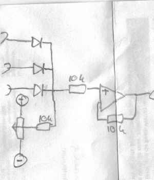

PostPosted: Mon Aug 28, 2006 7:21 am    Post subject: Reply with quote  Mark this post and the followings unread
I tried the peak. Nice. works well. But what i don´t like about it is that only pos voltages are processed.
Anybody know of a shematic for something like the A-172 by doepfer?
It´s also a minmax module, but with no clipping. So you get the min or max out of several signals, no matter how they are polarized.
Would like to have one of those...

Posts: 24676
PostPosted: Mon Aug 28, 2006 7:50 am    Post subject: Reply with quote  Mark this post and the followings unread
The way it is connected now makes the diode connected to ground a 5th input connected to a fixed voltage of 0 V, so that will be the lowest max you'll ever see,
You could try to connect that 5th diode to -12 volt, don't know though if it will go down all the way to -12 V then.
For the Minimum circuit you could do a similar thing - tieing the 5th diode to a higher voltage than +6 V in this case.

PostPosted: Mon Aug 28, 2006 11:47 am    Post subject: Reply with quote  Mark this post and the followings unread
With the diode going to -12 i could leave it out just the same.
Well, after some trying this came out. It´s working great. Don´t ask me why, i´m asking you...
The pot could be labled threshold. If set below the input signal you get the function i described. Making it higher the bottom of the output is cut off, till it disapears. For a min function the diodes have to be reversed. What suprised me is that the output stays a bipolar signal around 0v. I had exspected some kind of offset from the voltage applied through the pot.
For a min/max module my logic tells me that the inputs need to be buffered (parallel to the circuit shown) and sent to diodes facing the opposite direction.
Then either two sepperate threshold pots could be used, or just one, setting the splitpoint.
With Audio it makes no difference anyhow, min and max sound quite the same. For cv of course this is a cool function.
I´m just thinking: Maybe the inputs should be buffered in any case. Otherwise a threshold voltage set to high (in case of the max module) could creep back the cable and affect what´s before the diode.
Say, in a case like: LFO mods filter, the max module is used so that in it´s upper swing it mods something else as well.

Posts: 24676
PostPosted: Mon Aug 28, 2006 1:15 pm    Post subject: Reply with quote  Mark this post and the followings unread
zipzap wrote:
WMaybe the inputs should be buffered in any case. Otherwise a threshold voltage set to high (in case of the max module) could creep back the cable and affect what´s before the diode.
Not really, the diodes will prevent that. There is some asymmetry though, the output that currently has th maximum value will send some current into the circuit, but when another one goes higher that one will supply the current, so the first one will see less load and the voltage might raise a bit. In you circuit the load will never be worse than 10 k (the resistor ggoing to the treshold pot), so it will not be a big problem.
Why the output would stay around zero volts with the treshold being set to a negative value is beyond me - maybe you have something connected to an input that has its output around zero (and is dc coupled as well) ?
Anyway, you were right to leave the 5th diode out, and and I like your cicuit better than the original.
