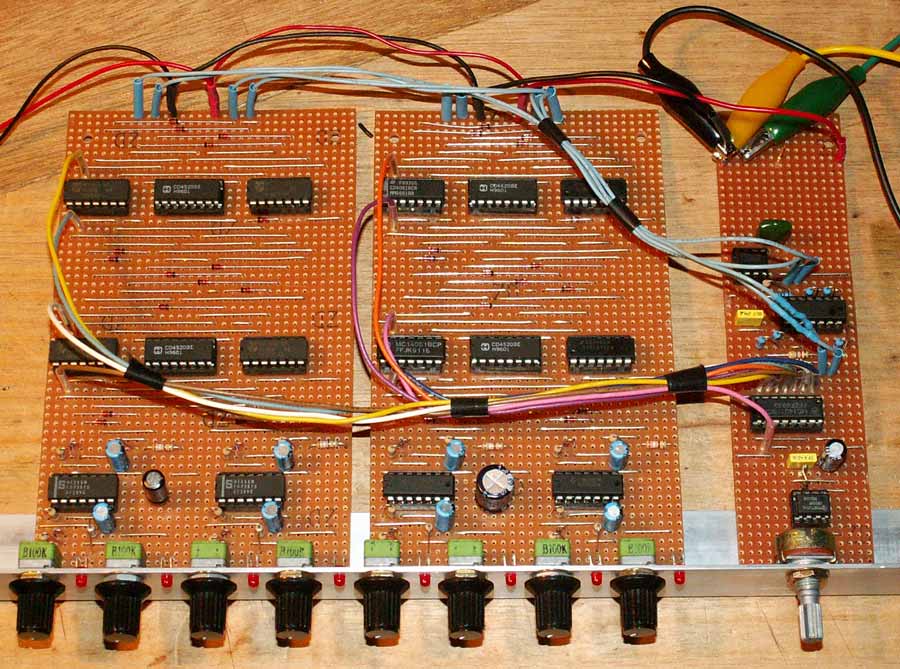

Here's the latest pic and wave of the super-sub. It's still not as I want it to be, and it does use an awful lot of chips for what it does, but it already has good WSB potential.
Hey Jan, I've noticed the spikey wave form is back (have a look at the mp3 in Soundforge etc.) and I was wondering if, now that I have, 556 clocks feeding 4520 counters which are ANDed with the 4017 outputs via 4081s and sent to the 4066 inputs, should I have pull down resistors anywhere else?
Fixing the bit lines has decreased the amount of sudden steps in the wave, but it does mean that the steps which do occur are as bad as they can be (ie 1111 -> 0000) I've worked out a way that you could drop back to 3bit and use the fourth as an auto reverse bit (XORs) but adding anymore chips would just be getting to silly! Wouldn't it?
Could I run the 4017 straight off a square wave out of the SoundLab? It's musicality would immediately go up a few notches if could just patch it in as a sub oscillator. That's why I decided to call it a Super-Sub.
One of it's features/annoyances is the sudden shifts in amplitude. This could maybe be tamed with a little compressor like Scott has been experimenting with lately. Yet the shifts in harmonic content are the whole point, so maybe that's just part of the uncontrolled modulation effect.
The next thing will be to make each sample's mod clock internal/stopped/external. And I've thought of a rotary switch for each sample so you can dial up different mod clocks to each sample. External mod clock /2,3,4......10 is another possibility.
Anybody who has any ideas about how to improve this thing feel free to throw them around!

PostPosted: Tue Apr 25, 2006 12:39 pm    Post subject: Reply with quote  Mark this post and the followings unread
You lost me Very Happy
I did read your request for help on drawing up the schematics, so I wont expect too much, but could you maybe give some scetch as what it is like now ?
The sound example is almost like there is mains hum in it ? Also there is not only the peaks, but I don't get the arcs in the waves either.
Nice pic you posted elswhere btw, the bathing one I mean.
PostPosted: Tue Apr 25, 2006 4:48 pm    Post subject: Reply with quote  Mark this post and the followings unread
On the original the 4017 was feeding the 4066 directly, yet you suggested pull down resistors, and they helped stabilise it heaps. Now there are a number of gates in between those stages, and I wondered whether I need pull downs between any of them.
When the output of any of the gates isn't high it is definately low (ie: there aren't any "floaters") but that was the case with the 4017->4066 and the resistors helped pulled them down quicker.
Maybe once I get a rough schem to you, you'll start to see where it could be better. I'll have a go at that next.

Here's the .sch file of the main board so far.
It seems very simple, but most of it happens on the mod boards. (which I'm starting on now)
