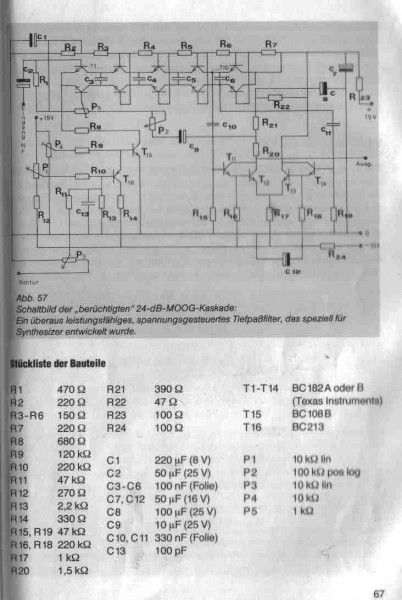

PostPosted: Fri Apr 21, 2006 3:30 am    Post subject: Reply with quote  Mark this post and the followings unread
Question 2:
In the shematic down there, can i just add more cv-ins via resistors to T16 (hard to read, it´s the one most bottom-left)?
Or should i use an summing OPamp?
thanks guys
 Filesize:  40.17 KB
 Viewed:  367 Time(s)
PostPosted: Fri Apr 21, 2006 5:59 am    Post subject: Reply with quote  Mark this post and the followings unread
I'm fairly sure that, to a point, you can just add CVs through resistors to T16. Have a look at the MFOS site and see how Ray adds CVs.
The VCF needs to see voltages which are relative to the 0V they were generated relative to. So you should have a ground connection between the sequencer and the VCF. If you got the ground through the PSU/Power Outlet chain then you would be building ground loops. The digital/audio ground is a per/unit concept designed to give the digital ground a faster short than through the analogue ground, so that the latter doesn't get contaminated. The ground to external units should come from the "star point" which is the junction between digital and analogue ground near the PSU. This sounds kind of weird, I know, because the first thought most people have is that if they are shorted together then there shouldn't be any difference between them. But it is based on the resistance of the actual ground connections (every wire has resistance) and the decoupling of different sections of the circuit, which gives the ground connection the ability to attenuate the high frequency transients on the digital ground. But only if they "see" the digital ground's smoothing caps first. i.e. if there was a faster way to ground through an analogue circuit on the same ground line, then these transients would be redirected through them. Thereby contaminating them with digital "spikes".
Does that make sense?
It's a bit esoteric, I know, but once you get your head around it, it makes sense.
