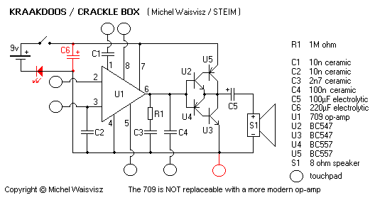

hey,
just placed my order for a kraakdos...
i would really like to build one and modify it for sonifying chemical reactions... problem is this is my first electronic project... Embarassed
looking at the schematic from johan boberg's site (see below) i do not understand: Question
capacitors C1&C2 are 10 n_F_?
is C3 2 n_F (what does 2n7 mean?)
what are the u-labeled components?
how would you add a line out and volume control? (howard?)
for building circuits there are so-called laboratory boards available, where you clip-fasten components and make connections via patch cords. what do you think of those?
best regards
eike

2n7 is shorthand for 2.7nF
6u8 - 6.8uF
4K7 - 4.7Kohms
1M5 - 1.5Mohms
etc.
It's just a quick and accurate method which doesn't rely on a decimal point.

thanks for clarifying!
hm, what about the U2 etc-BC thingies...? Embarassed
best regards
eike

U is a generic descriptor prefix for semi-conductors. In a schematic like this it covers ICs and transistors. Sometimes they are separated out into Txx for transistors and ICxx for ICs. Sometimes they are all covered by another general prefix such as Q. Descriptors are specific to the drawing and have nothing to do with the actual part number. The BCxxx (part number) transistors are a series of small signal transistors. I think the same types are made by a number of manufacturers. The history, markings, makes, case styles and functions of all transistors could now easily fill an encyclopedia, so don't expect to know anything which you haven't actually used. ICs would fill another encyclopedia. It's a big field, and one which is learned very slowly.
