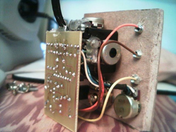

PostPosted: Sun May 28, 2006 5:55 am    Post subject: Reply with quote  Mark this post and the followings unread
nothing new really, just a shot of the finished joystick module in a temporary pressboard panel.. works perfectly Very Happy , and will make testing of other modules as they're built really easy because the outputs are pretty precise. my pushbutton gate is a wee bit bouncy though.
