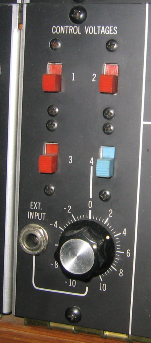

"Inverted" makes me think AC, and I thought CV was supposed to be in the 0-10V range. Are negative voltages OK? Maybe this would be a negative voltage mixed with the positive voltage given by the module's knob position, but the entire voltage range would be clamped at zero? I guess it depends on what is being controlled. I've never heard of a negative frequency!
Now, I have noticed that my Octave Kitten can take +/-30V to it's CV inputs without flinching. I know it was risky for me to discover that.... but the bench oscillators (Heathkit and Wavetek) that I've been using to modulate it have two outputs: 2V pk-pk and 20V pk-pk. They also have DC offset on the outputs, so I can offset by +/-20V and then have a 10V peak riding on top of that DC. With that great a range to control the oscillators, I can go practically from DC to light! Well, at least from ultra low fractional Hz to well beyond my range of hearing. I figured that this keyboard was just particularly robust and I would have to put these OSCs away when I got other modular gear, just to be safe.
The first thing that comes to mind to implement that technique would be to tie either end of a potentiometer to the + and - inputs of an opamp, and then connect the wiper to the CV input. That way I'd sweep the input voltage between non-inverting and inverting inputs. I'd have to scratch my head for a little bit to figure out how to handle gain in something like that, though. Maybe a second non-inverting amp for gain and just use that first one for polarity/attenuation. Hmm...

PostPosted: Tue May 09, 2006 12:34 pm    Post subject: Reply with quote  Mark this post and the followings unread
It could be interpreted as the wave form being played backwards, and such implementations do in fact exist.
A decent synth should be able to handle negative control voltages, it's essential I think to be able to do subtraction.

Oscillator (LFO & VCO) outputs are generally -5 to +5. Use a LFO for vibrato and you want the pitch deviation centred around the note you are playing.
The invertible attenuator is cool but I use inverted CV’s relatively infrequently so would be happy with a couple on a dedicated CV mixer module. The circuit is not that difficult (two opamps?) but requires trimmers so the ‘zero cv’ setting is top dead centre. The pot should also have a detent at the centre location to make turning off the CV easy.
This is what I was thinking of. Here's a pic of my Moog. In checking, it only has one of these inverting attenuators - hard wired to the filter cutoff.

hey there is one on the front end of scott's mutant vcf too! cool
