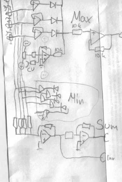

And here is the deluxe version. untested. opamps are cheap...
Inputs go to voltage dividers first. That´s a must for the minmax anyway.
Than they are buffered twice in parallel, once for the min, once for the max. I´ve made the threshold voltage controlled, have to check it out, maybe that´s cool. A switch could link the threshold of the two modules to make it superflexible.
And last, in the spirit of our discussion on flexible multitask multipurpose modules, the inputs are summed.
So this module will output the mix of 4 signals, their maximum, their minimum, and it can do vc clipping of the last two.
The clipping can also turn it into a kind of vca/crossfader when one signal is below audiorate, the others above. The slow signal will change volume( can turn it domn completly) and sound.
Still i wonder why with the max module i built the output stays nicely around 0v with threshold at min, since it´s then connected to -12v.

zipzap wrote:
WMaybe the inputs should be buffered in any case. Otherwise a threshold voltage set to high (in case of the max module) could creep back the cable and affect what´s before the diode.
Not really, the diodes will prevent that. There is some asymmetry though, the output that currently has th maximum value will send some current into the circuit, but when another one goes higher that one will supply the current, so the first one will see less load and the voltage might raise a bit. In you circuit the load will never be worse than 10 k (the resistor ggoing to the treshold pot), so it will not be a big problem.
Why the output would stay around zero volts with the treshold being set to a negative value is beyond me - maybe you have something connected to an input that has its output around zero (and is dc coupled as well) ?
Anyway, you were right to leave the 5th diode out, and and I like your cicuit better than the original.
The link posted by 211 is a much more "perfect" circuit of course. having no diode drops and no real asymetry in load and no asymetry in the speed with which it fiollows the input signals either - but it costs of course.

Scott Stites
Joined: Dec 23, 2005
Posts: 4127
Location: Mount Hope, KS USA
Audio files: 96
PostPosted: Mon Aug 28, 2006 2:34 pm    Post subject: Reply with quote  Mark this post and the followings unread
Hey Zip Zap,
I used a Peak/Trough function in the mixer I expounded on so much in the Heavy Metal With XORs thread:
http://www.electro-music.com/forum/topic-11070-25.html
I, too, ran into pitfalls between the concept and actual implementation of the circuit. I used Ken Stone's Analog Logic circuit as the basis for my implementation.
Like you, I too wanted the voltage dividers on the inputs - in fact, the Peak/Trough outputs were to be additional outputs of the mixer (which they turned out to be).
Problem with using voltage dividers I did not anticipate: With no input, your voltage divider will still put out a signal as far as a Peak/Trough circuit is concerned. That signal is 0V.
Haven't checked your schematic out thoroughly yet, but in my situation, when I first tried the circuit - worked fine. One bipolar signal input would send the signal through unaltered. Two bipolar signal inputs would return the min or the max. Great! I added the pots. Now, just one signal input would give only the top half of the signal (for peak) and the trough output was the bottom half the signal. Light bulb over head moment - ground is a higher potential than -V and a lower potential than +V. The voltage divider connection to ground was giving me that ground, whether I wanted it or not.
My solution probably will not work in your case if you're using banana jacks. I used stereo switched jacks. For the Peak connection, I had the jacks switch in -V on the input, so that any reasonable signal would always be above it. For the trough, I switched in +V, again, higher than any expected input. Plugging in the jacks grounded the + and -V input with the stereo ring coming in contact with the ground plane of the mono plug and allowed the circuit to use the input signal, for each input. Works like a charm. I just have to be sure not to use stereo plugs Very Happy
Cheerio,
Scott
Posts: 24571
Audio files: 306
PostPosted: Mon Aug 28, 2006 3:03 pm    Post subject: Reply with quote  Mark this post and the followings unread
Oh yes, the mixer means trouble, it connects all unused inputs to virtual ground. In that light ... the buffering input opamps might not be such a good idea either - they will float wherever their input wants to float.
Simple things can be quite tricky sometimes ...
