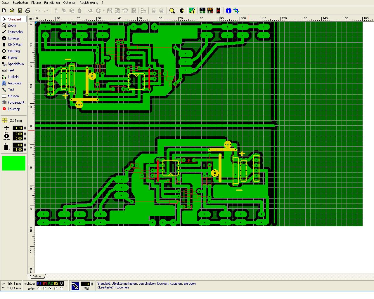

i have drawn a little pcb layout with Print mounted sockets and pot for Eurorack format. ( would also fit into a frac custom panel )
But it is without the CV input.
is that necessary ?
if anybody is interested for that _untested_ layout and _without_ the Cv input,
i can post it.
It is made with sprint layout 5 for which a read only version is free available at abacom
i will draw it with the CV input later.
On the actual layout there was no space to integrate it for fast
( the goal was the printmounting for the pot and the sockets because of fast building and much less errors )
ahh, it has 2 out sockets and one is with bypass switch ( that should also fit for a printmount switch )
ohh, and it has power connecters for Motm, Dotcom and doepfer.

PostPosted: Mon Dec 03, 2007 4:13 pm    Post subject: Reply with quote  Mark this post and the followings unread
ok, comments are in the file window
as sayed: absolutely untested.
Print it first out and check the circuit AND the spacings.
I will give it another look later ( maybe in January )
I'm into other projects now, and my frined who is etching for me has no time now.
this draw was just a spontaneous action Wink
screenshot of my drawing you find in the RAR file

My drawing is absolutely untested.
Also the spacing for the Cliff minijacks, and the spacing for the print switch for bypassing.
the link to the free viewer software is above

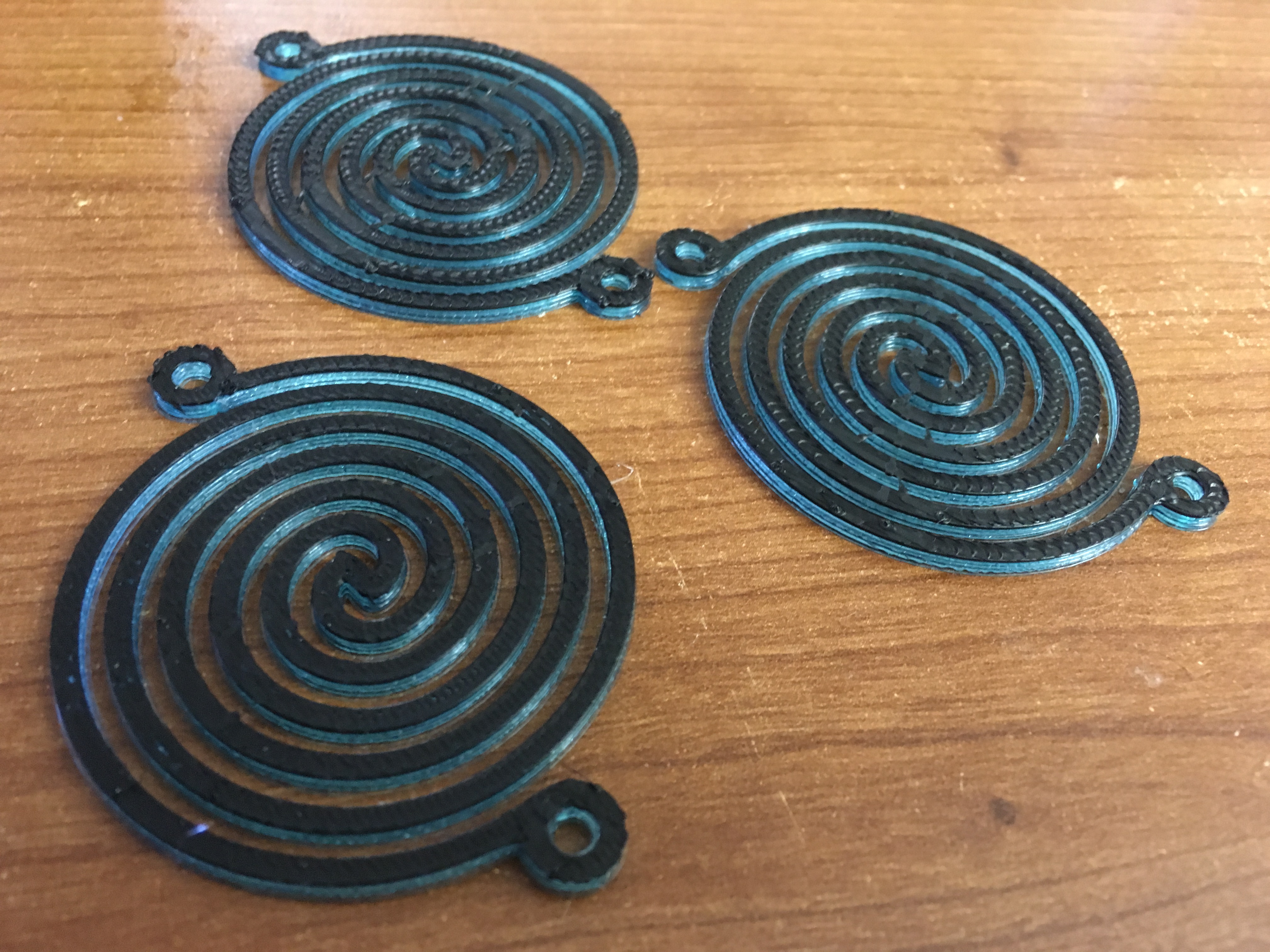

PostPosted: Wed Jul 06, 2016 3:11 pm    Post subject: Reply with quote  Mark this post and the followings unread
In the attached photo I am showing three "finger potentiometers", suitable for panel designs, that are a bit of a misnomer as they are in fact variable resistors not potentiometers so really I need a better name. Anyway here is how they work:
Each finger pot has an underlying spiral of a colorful (in this case aqua translucent) insulating material. On top of this is 3D printed an electrically conducting layer that makes for 10 kOHm or higher resistance in the coils. Both ends of the dual spiral design have a circular electrical contact suitable for 3mm hardware or similar. With washers and spacers, even a metal panel can be used. The mechanical and electrical contact is made at these end points.
Once situated firmly in a panel, the operator can vary the electrical resistance between the terminals by pushing on the center of the spiral, squeezing the sides of the spiral, or some other deformation on the spiral. The goal is to short the layers and then slide along the shorted layers or short more layers, etc. to create a different resistance.
I have also thought of using the zig-zag resistor symbol to physically make resistors this way, isn't that neat? Well anyway you get the idea. This circuit, using a single quad opamp and 3D printed resistors, and three audio jacks would make for a great demo item, don't you think?
Les
