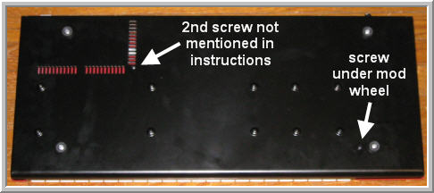

G2 bottom showing the second screw you need to remove to get the synth to open up
I received my G2 expansion board today and installed it. The serial number for the board is GA10099. The was a significant error in the instructions that caused me some problems. I hope by posting this we can save someone else grief.
On step 2, the instructions state: Remove the larger black screw on the bottom of the synth (underneath the Mod Wheel).
I did this, but was unable to pull up the lid. It turns out, you also have to remove another larger black screw as well. I have indicated this on the picture.
Other than the installation went well, except that it took me a minute to figure out how to orient the expansion board with respect to the internal components. That is because the serial number sticker was put on a differnt chip on my expansion board than is show in the photo in the instructions.
I now get 23 voices of polyphony when using the factory patch BriteTine which is in the Piano category. I'm not sure how many I got before.
