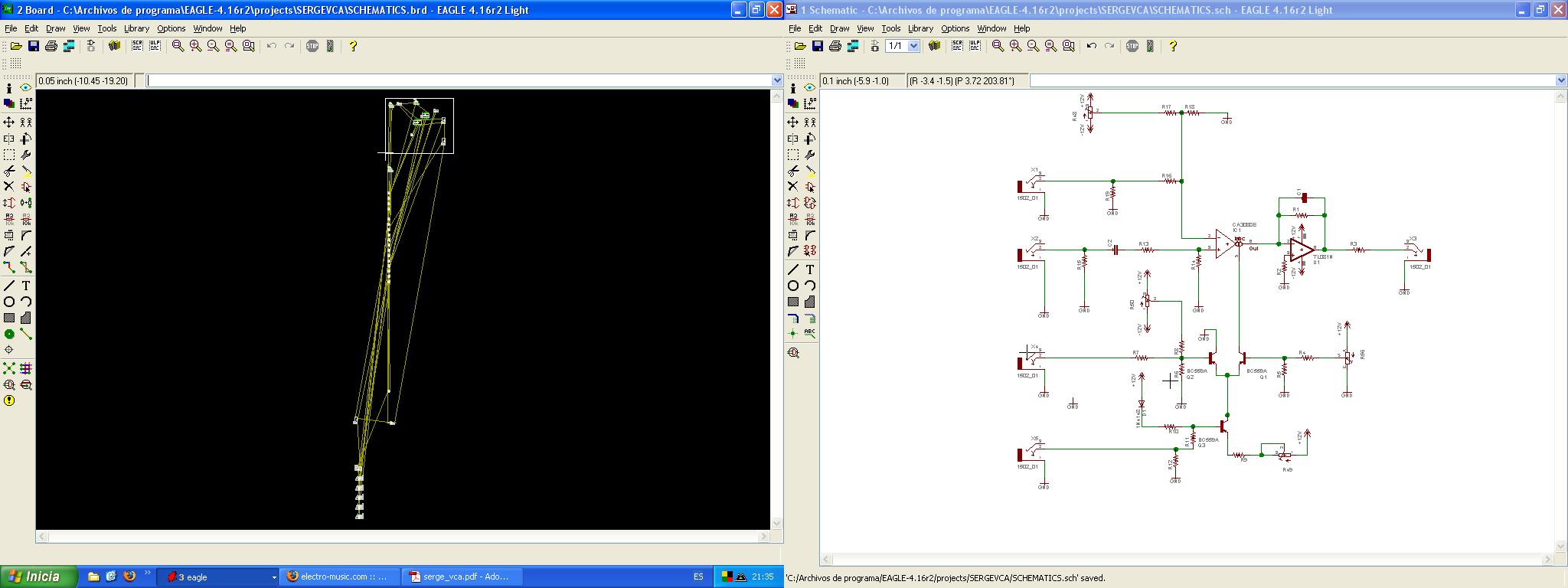

Well I just have did the schematics of serge VCA from Marjan Urekar. But when I swap to board layout the Pcb layout not is ready. Look at the picture.
When I click in "auto" It says that "the light eagle can't perform the requested action".
So What I need for from a schematics do an automatic PCB layout? Do I need the standard eagle? http://www.cadsoft.de/prices.htm . What do you do?

im afraid you cant auto layout the parts, auto is for autorouter meaning it will find the best possible route between parts for you. you need to place the parts first inside the white square area
The free version of eagle only allows you to put parts inside that white square
i got myself started out on this tutorial
http://myhome.spu.edu/bolding/EE4211/EagleTutorial4.htm
and this
http://vulcan.ece.ucsb.edu/ece189/tutorial1board.html
