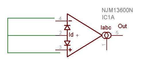

I'm trying to teach myself to use Eagle as everyone else seems to use it.
I have downloaded the synthdiy libary, and I'm trying to do a simple VCA circiut using a NJM13600N, but I cannot trace a connection to pin 3 but it will not snap to it, it either goes above or below.
does anyone know how I can get round this??

Sebo
Joined: Apr 27, 2007
Posts: 564
Location: Argentina
PostPosted: Wed Jan 30, 2008 8:47 am    Post subject: Reply with quote  Mark this post and the followings unread
Hi:
Check the grid settings, or disable it. I think that's could be the problem.
Where do you downlad sdiy library from?

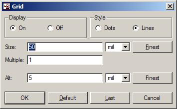

crazeydazey
Joined: Feb 15, 2007
Posts: 303
PostPosted: Wed Jan 30, 2008 9:09 am    Post subject: Reply with quote  Mark this post and the followings unread
thnx Sebo,
it was the grid setting...
I've changed it to match attached pic, and works a treat..
I can't remember where I got it from now, I think it was from a post on here somewhere..

bugbrand
Joined: Nov 27, 2005
Posts: 846
Location: Bristol, UK
PostPosted: Wed Jan 30, 2008 11:56 am    Post subject: Reply with quote  Mark this post and the followings unread
Ahhh, I found exactly the same problem when I started using the SynthDIY library! Many of the packages are on a funny grid (maybe mm rather than inch)
I like to keep the schematic on a standard grid (0.1") so I edited the library::
- Go to the control panel and expand the Libraries view
- scroll to the SynthDIY Library, right click it and select Open
- near the top left of the tool bars you'll see three little symbols for Device, Package and Symbol. First click the Device one and find the part you want to edit.
- select the Info tool (topish left) and find out what Symbol is being used for the device - with the NJM13600 (and LM13700 etc) you'll find that the main opamp part uses the Symbol OTA_WD_N . Also check what the buffer Symbol is (..OTA_BUF)
- right, now click the Symbol button on the toolbar and hunt out the OTA_WD_N symbol. This is the bit you edit, moving the pins around so that they're on your favourite grid -- I do this by switching between different grids and cross comparing until I've moved everything onto the 0.1" grid.
- do the same for OTA_BUF
- these changes will automatically be updated to the Devices that use that Symbol within the library (you can check back to the Device NJM13600 to see). Now save your changes, close the library and head back to the schematic.
- If you've already got your NJMs included in the schematic you'll need to update them - go to the top and open the Library menu and click Update All.
Hope that is just about understandable! Took me ages to discover how to clunk around with the libraries... But its definitely worth a poke in the long run.

Clack
Joined: Aug 08, 2005
Posts: 438
PostPosted: Wed Jan 30, 2008 2:54 pm    Post subject: Reply with quote  Mark this post and the followings unread
its on a 0.635mm grid ( 0.025" ) which is pretty fine

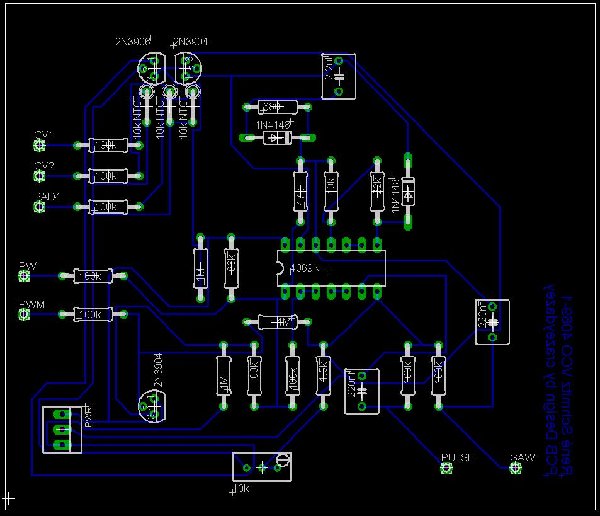

PostPosted: Fri Feb 01, 2008 6:16 am    Post subject: Reply with quote  Mark this post and the followings unread
here is my first PCB done with eagle...
it's the rene schmitz VCO 4069-1.
please have a look and let me know what you think..
 Filesize:  91.32 KB
 Viewed:  206 Time(s)
etaoin
Joined: Jun 30, 2005
Posts: 761
Location: Utrecht, NL
PostPosted: Fri Feb 01, 2008 8:00 am    Post subject: Reply with quote  Mark this post and the followings unread
You seem to be missing power decoupling, for one.
Was this done with the autorouter? There are some odd routing decisions, especially around the power connector. I would never put traces through that myself, but what do I know.
I'd also opt for slightly wider traces especially if you're going to etch this yourself. Filling up the empty space will also save you a lot of etching fluids.

crazeydazey
Posts: 303
PostPosted: Fri Feb 01, 2008 8:10 am    Post subject: Reply with quote  Mark this post and the followings unread
I guess I could put decoupling on, I just copied it from http://www.uni-bonn.de/~uzs159/index.html. I've also realised I haven't put anyware to attach gnd etc to pots and jacks.
Also I've just noticed there is no gate on this VCO.. How do you trigger it??
I was going to make it as a simple VCO but I've confused myself now..
yeah I used the autorouter, I'm not clever enough to do the routing myself just yet.. still a noob. Sad

Clack
Posts: 438
PostPosted: Sat Feb 02, 2008 4:12 am    Post subject: Reply with quote  Mark this post and the followings unread
electronic peasant has a good intro on decoupling
http://www.electronicpeasant.com/circuits/decouple.txt
Always put it in first - it saves a lot of hassle - people like rene may not put it in the schematic as its assumed you know to do it. I recommended to breadboard things first , many things don't work straight from the scematic
I would also reccomend using larger tracks and pads - eagles defaults are incredibly small for press and peel - a 0.8 drill will almost obliterate all the copper in a small pad. Another thing is that thinner tracks tend to be more fragile - if you have a transistor say , and your a bit rough with it after soldering it in - it will probably rip up the tracks if too thin ( this is if your using cheapo PCB boards like me though )
You also have to think about how close pads are to the tracks as solder tends to jump to across as there isn't a soldermask. if you run 2 tracks too close to each other for long enough they will probably interfere - i try to keep things 2-3 mil apart
Another thing you'll probably come across soon is analogue ground and digital ground in schematics - here is a little post that helped me understand
http://www.epanorama.net/wwwboard/messages/16215.html
I also think ( this is my preference ) that it is better to put in a jumper wire than make a board 1cm wider or taller . you can do this whilst drawing a bottom layer track select top layer at the top of the screen draw the top layer then press bottom layer and draw it to the destination it will automatically add pads.
A good idea is to set the power up before anything else, some people like to line all the chips up and then put the power lines down the centre of them all - then put decoupling caps for each chip inbetween
hope that helps

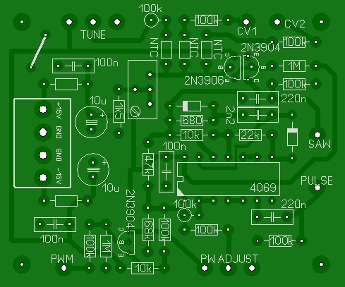

etaoin
Posts: 761
PostPosted: Fri Feb 15, 2008 7:42 am    Post subject: Reply with quote  Mark this post and the followings unread
crazeydazey wrote:
I'm a noob with a lot to learn so I would love to see other peoples work around this...
This is what I was working on earlier. It is still unchecked and there's a nasty wire I needed to connect the ground plane, which I still want to get rid of.
4069 VCO preliminary PCB design

crazeydazey
Posts: 303
PostPosted: Fri Feb 15, 2008 8:18 am    Post subject: Reply with quote  Mark this post and the followings unread
Very Happy Very Happy Very Happy luv it..
if you check it and it's fine, I think this is the beauty I'm gonna try building.
I'll get some Print and peel and some etching stuff... (this will be a first too, I've not tried making my own PCBs yet.)
