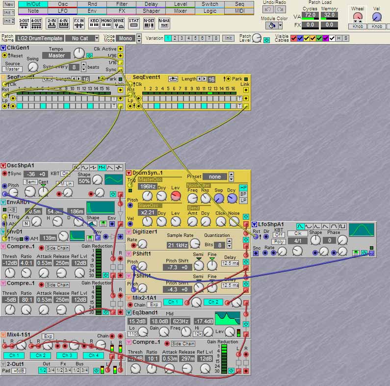

I don't know if this is a bug or not, but the digitizer seems to introduce something in here that then drives the pitch shifters.
hit run at 132BPM, then hit stop. then notice the rumble. It is definitely introduced by the digitizer, but this does not sound right to me.
The funny thing is if you move the druym synth level knob (the morphed one), below a certain level, there is no rumble but if you go beyond midway, rumble when clock stopped.
Your thoughts? Can you reproduce it? It happens in both the G2 demo and real thing.
/Dasz

Hmm, you dont need the digitizer ... the problem seems to be the the drum synth actally, it's not completely shutting off it seems but it needs the pitch shifter and a lot of amplification to make that audible .. when you toggle the mute button of the drum synth the effect comes and goes ... when you add a noise gate after the drum synth the problem is solved. Erm, I tried this in the demo Wink

thanks, Jan. I am not crazy Wink
