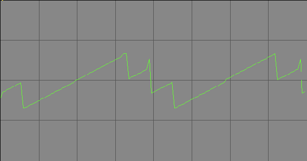

I've been interested in this module for awhile and can't find any sound samples or panel layouts etc.
I don't think I quite grasp the "8 stages" to the module.
I have however done some tests with the modulo object in max (%~) and it can surely generate some interesting waveforms.
Any comments on this peculiar module?
sine modulo a fixed value
 Filesize:  7.04 KB
 Viewed:  391 Time(s)
 Filesize:  7.27 KB
 Viewed:  399 Time(s)
saw modulo a fixed value
 Filesize:  6.57 KB
 Viewed:  359 Time(s)

It looks like it is similar to what you've been playing with. The 8 stages means it can put up to 8 of those steps in a single slope. Your diagrams are only showing around 3 steps.
