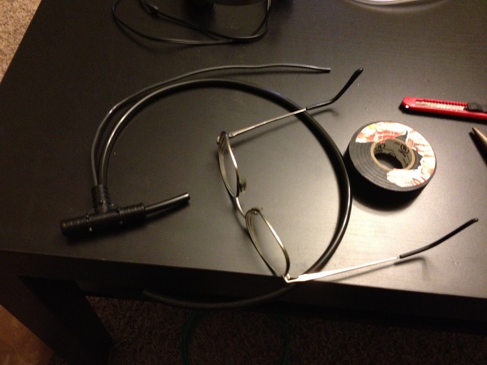

Breath controlled Martenot demo video...
http://www.youtube.com/watch?v=ZY3FwFswrAc
Still a work in progress, but along enough for some fun playing on it... breath controlling the volume/filter brightness and pitch on a ring/pulley controller like the martenot.

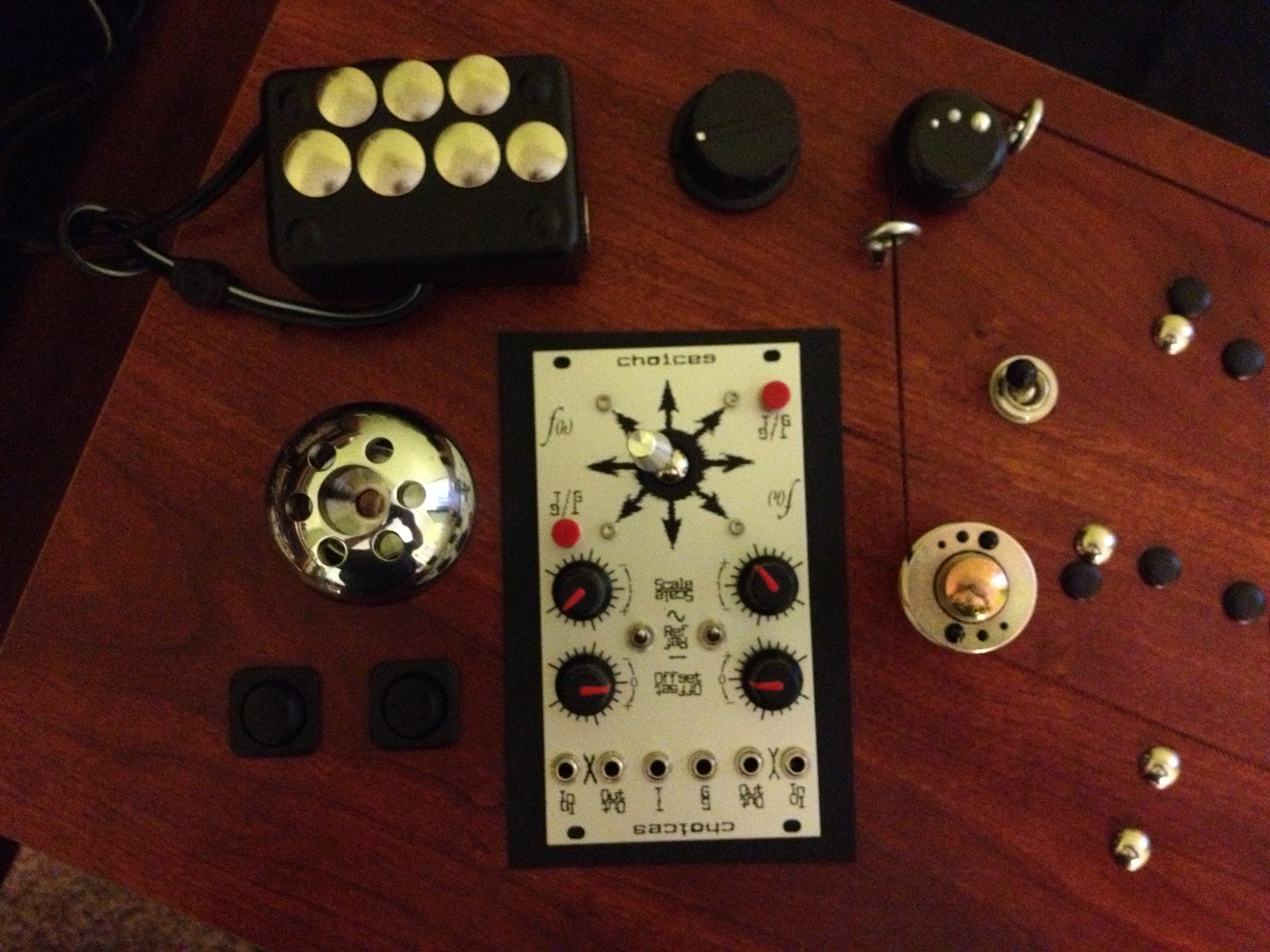

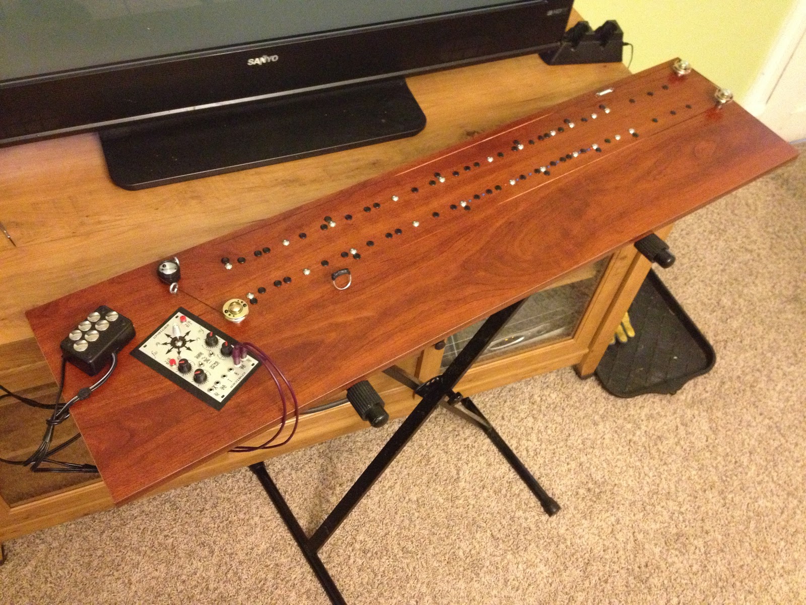

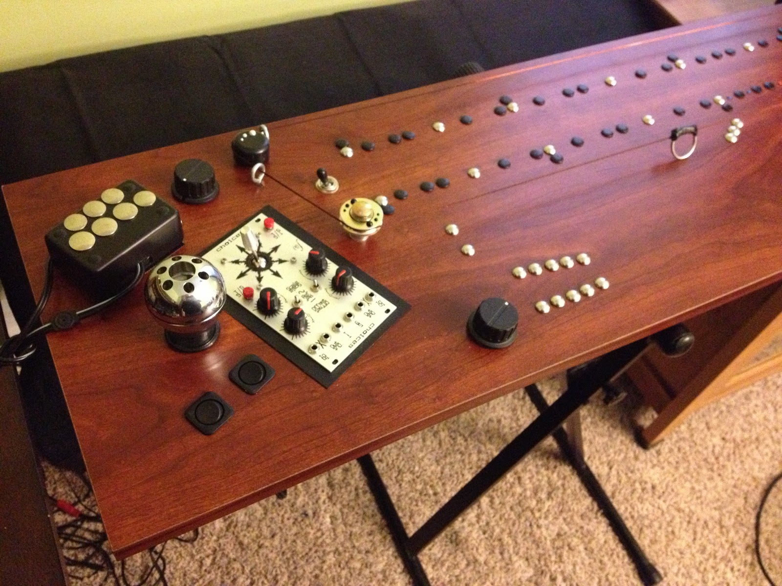

My Breath/Martenot style instrument is nearly done. Video demos may happen pretty soon. Practicing tons.
The following is quoted from my site, ThePinesofMars.com...
"...."Choices" joystick module into my Breath Ring and Breath Ribbon controllers. They both actually use the same trill box, which attaches with industrial strength velcro quite effectively, and the same Choices module, which set's into a rectangular hole and stays put nicely. Both easy to switch over. I'll have some video demos up of them both like this soon.
Placement makes it comfortable to do the trill keys with the fingers while nudging around the joystick with the thumb.
There will be many uses for the joystick but the one I'm excited to get working is running a Grendel Formant Filter, which will real time allow for smooth vowel transitions... singing aliens etc.
Update... a few days later finished putting on the visual/tactile note references on the Breath Ring. The finger glides right down the middle of the mirror image arrangement of these. Nice and smoothly or lowered slightly to feel the notes. "
And newer hardware added in the last few days... touch sensitive octave buttons for arpeggios (in 2 patterns) and some other stuff... everything there has a job to do, if only occasionally in the music.
And a shot of the Ribbon instrument, which is pretty much finished... though soon I'm removing the black half pearl tactile references.

My instrument is so close to finished. Tonight I put together a breath controller mount to some good headphones, so I'm no longer just putting a tube in my mouth for the articulation. Plays really comfortably and used about $5 bucks of gardening parts from Home Depot. Gonna make another that doesn't have headphones on it. Also plan to cut off the extending end of the T joint that is superfluous. The boom support is 12 gauge solid wire. And it looks so evil scientist-hip that I'm seriously considering taking up smoking.

So close to done. All this started seeing Dana's DIY info and photos on this thread, and I didn't think I could get there but so glad I tried. Used tons of his ideas in this.
These days Dana is working hard on his own instrument in some truly amazing, successful directions very different from my own. Good stuff is coming...
