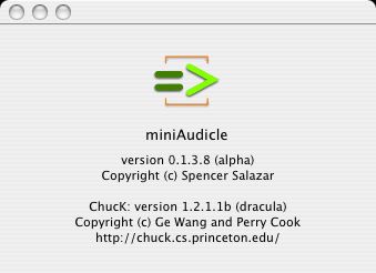

Howard, do you have the latest version of the miniAudicle? The image below shows the pop-up window I get when I select "About miniAudicle" from the miniAudicle menu. You can download the latest version of the Mac miniAudicle here:
http://audicle.cs.princeton.edu/mini/mac/
MAUI is a very new feature, so you may not have it.

PostPosted: Sun Jul 13, 2008 6:38 pm    Post subject: Reply with quote  Mark this post and the followings unread
I have that version too. Windows, not Mac though.

PostPosted: Sun Jul 13, 2008 7:01 pm    Post subject: Reply with quote  Mark this post and the followings unread
Oh, Windows. That's the problem. Unfortunately MAUI continues to remain unavailable on Linux and Windows, much to the frustration of us all. I really want my electro-music.com ChucKist friends to check out my soft synth and guitar/drums song creation software but they simply cannot run it at this time. MAUI cross-platform compatibility is promised in the next release, however the weeks of waiting have become months now and still we wait.
Instead, I can code up a keyboard and/or mouse interface for you, Howard. Would you like the number keys to set the volume from 0 to 9 or perhaps the square bracket keys to step the volume up and down, with the backslash key as a mute? That latter interface would mimic the Apple built-in audio controls nicely. Just tell me what you'd like and I'll code it up for you.
Hmmm... now that I think of it, if you were typing say a forum message that needed a bracket or a backslash, your volume would change as you type it. I don't know if I can do control-bracket or whatever. Anyway, tell me your thoughts and I'll code it for us all to enjoy.
