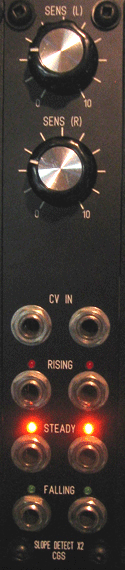

I love the Slope Detector's, I want two more.
 Filesize:  47.83 KB

I use it to trigger all sorts of things (eg's, clock's, vca's, gated lfo's etc)... I definitely don't have a standard usage for it.....
The signal I activate it with changes alot but one common way I use it is if I have a sequencer clock running from an lfo I will feed another wave from the same lfo it the cv standards....

all the time, different sensitivity makes them switch at slightly different times
