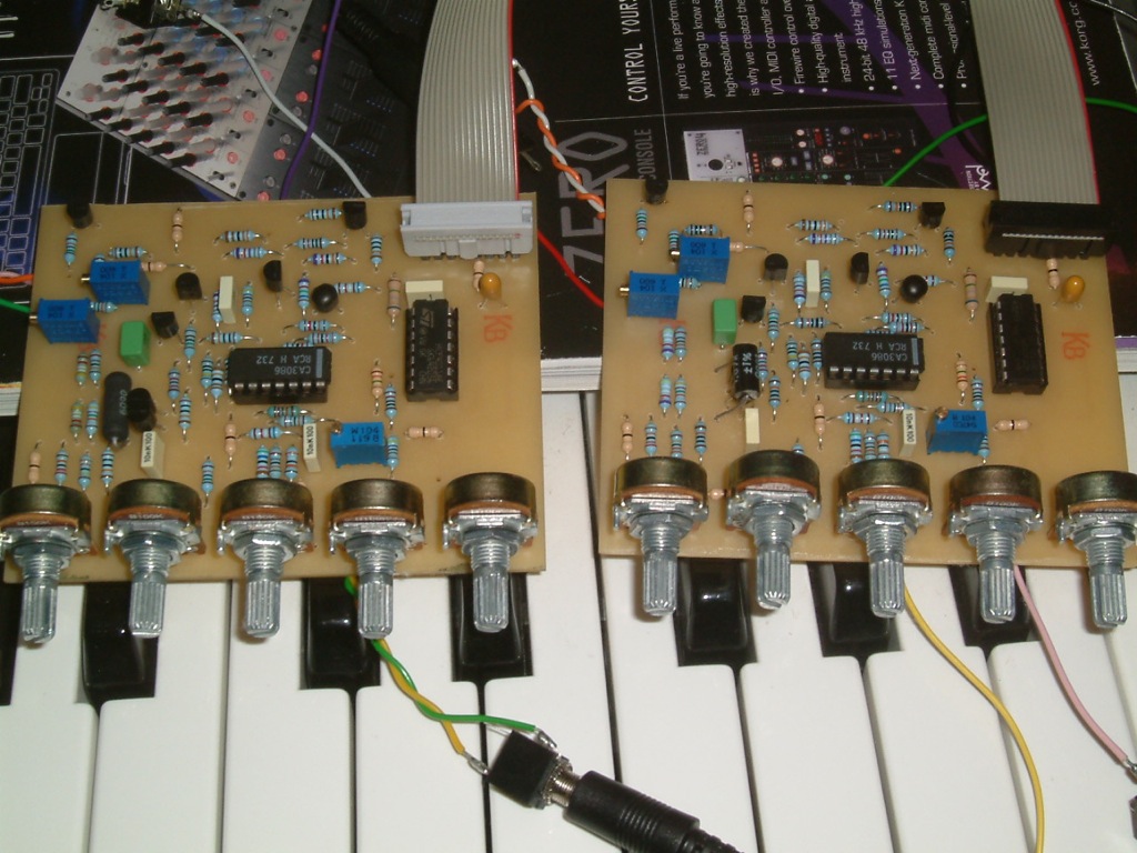

PostPosted: Fri Sep 05, 2008 12:33 pm    Post subject: Reply with quote  Mark this post and the followings unread
For got the pic... Duh!

ericcoleridge
Joined: Jan 16, 2007
Posts: 889
PostPosted: Fri Sep 05, 2008 12:50 pm    Post subject: Reply with quote  Mark this post and the followings unread
Wow!! These are so right on! They sound amazing. I can't wait to try them out now.
What are these? They're just single VCO versions of the dual VCO you posted originally?

Broadwave
Joined: Feb 16, 2007
Posts: 347
Location: Manchester UK
Audio files: 6
PostPosted: Fri Sep 05, 2008 4:03 pm    Post subject: Reply with quote  Mark this post and the followings unread
These are separate VCO's, no ring mod (can be easily modified though). The dual board that I posted earlier is for my Oddy clone project Smile
Andy.

Broadwave
Posts: 347
Audio files: 6
PostPosted: Sat Sep 06, 2008 1:37 am    Post subject: Reply with quote  Mark this post and the followings unread
To be honest, I had no idea that Tim Servo was also working on these VCO's (as we say in England - you wait all day for a bus, then two come along at once).
I've owned several Oddy's in my time (as well as a 2600), and always regretted selling them, which is why I'm so passionate about recreating one.
I'm surprised that they've been ignored for so long, and it wasn't until recently that I had the confidence to do anything like this - I only picked up a soldering iron for the first time last year, but thanks to this forum I've learned a great deal Smile
There is something "special" about the Oddy VCO/RM combination that I've never been able to recreate. The sync on other VCO's tended to be very weak, and no amount of tinkering seemed to improve things. The Oddy Ring Mod, isn't a true Balance Modulator, it's just a couple of CMOS gates used in an "exclusive or" set-up - so you can also use it for processing gates/lfo's etc.
I'll be posting info on the 4023 VCF (White Face Oddy, 12db) and the 4035 (their infamous Moog VCF) soon, maybe today if I get the time.
The 2N5910, *can* be replaced with a 2N3906 - I've tried this and it works, although it does seem to draw a bit more current. The main problem I have is the 1.87K Tempco - I'm looking into this... I've seen something around where a guy used 2 SMT tempcos, but I can't remember where, so I'll be Googling for the next few hours Smile
Andy.

Broadwave
Posts: 347
Audio files: 6
PostPosted: Thu Oct 16, 2008 3:52 pm    Post subject: Reply with quote  Mark this post and the followings unread
Did this work out for you Andy?
Unfortunately no... I found the solder joint between the SMD's too fragile (even though I encased them in epoxy), just way too fiddly.
2 x 1K Tempco's in series work and track fine, and that's what I'm using now.

PostPosted: Fri Oct 17, 2008 9:22 am    Post subject: Reply with quote  Mark this post and the followings unread
Hi Andy,
A few questions:
1) What are the critical/timing caps in this circuit - just the 680pfs? Any others that should be polystyrene? Would you say that 1000pf works better than 680pf?
2) EDIT: Think I found it - it was a 2N5172, which you have replaced with 2N3906, right? Wasn't finding a corresponding one for the other oscillator because this one is part of the ring mod circuit. What is the unlabeled transistor in your layout - the one right beneath the 330K resistor and above the left-hand/VCO 1 PW Adjust trimmer? Odd, because I can't seem to find this in the Arp schematics and don't see a corresponding one on your board for VCO 2.
3) How would you properly calibrate the 3 trimmers for each VCO?
4) 2K Tempcos (instead of the 1.87Ks) from Bridechamber would work fine for each oscillator circuit without changing any other component values in the circuit?
5) EDIT: Never mind - confused this with the other project mentioned here. I see this board does have the ring mod circuit. You mention there's no ring mod on this board but there is a ring mod output pad. How could you mod this board to get ring modulation out of this pad?
6) EDIT: Found the schematic and it looks like all 3 would be B100K, right? Still wondering why you have 5 instead of 6, though. What value and taper type would you suggest for each of the pots? Also, I see 5 pots on your board in the photo you posted, but it seems there should be 6 - 3 (Coarse, Fine and Manual PW) for each oscillator. On this note, if I wanted to add an attenuator for the FM input, what value and taper would you suggest for that?
7) Finally (thanks for your patience), the Osc 1 Audio/LF switch switches the module between operating as an audio oscillator versus an LFO, right?
Thank you!!
Broadwave
Posts: 347
Audio files: 6
PostPosted: Fri Oct 17, 2008 10:27 am    Post subject: Reply with quote  Mark this post and the followings unread
numbertalk wrote:
Hi Andy,
A few questions:
Phew... Ok I'll see what I can answer...
1. Just the 680pf for timing (1000pf should be fine, although the osc frequency will just be a bit lower.
2. Ooops... that's a 2N3904
3. Put both coarse & fine controls to minimum and adjust the VCO Freq Trimmer to give 20Hz. Put both PW controls to minimum and adjust PW Trimmer for 50% pulse (Square wave). The scale trimmer is a bit more awkward - Play octaves on your keyboard, and adjust trimmer until you get an octave difference - I always set up another oscillator to play bottom C, tune the osc you're adjusting for minimum beat frequency, and play an octave higher... adjust the scale trimmer then play bottom C again... retune for zero beats and play an octave higher again... re adjust the trimmer (keep doing this until the osc is scaled correctly, can take some time though)
4. a 2K tempco should work fine, there's plenty of leeway in the scale adjustment to cover the difference.
5. Not sure what board you're talking about - The original Dual VCO details I posted has the Ring Mod built in.
