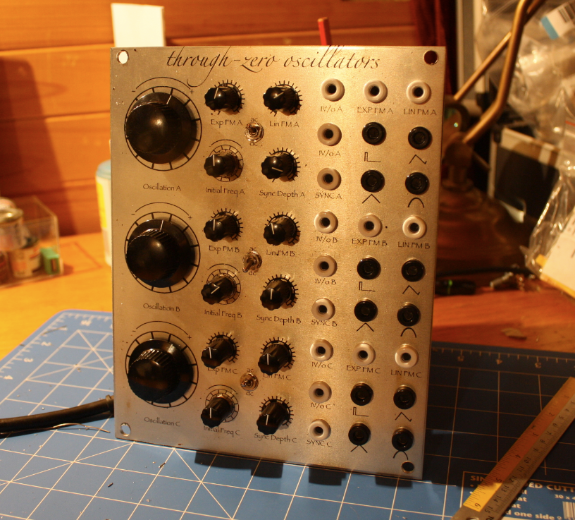

PostPosted: Wed Mar 10, 2010 6:12 pm    Post subject: Reply with quote  Mark this post and the followings unread
I'd like some feedback on this panel.
And never mind the pitch scaling around the large knobs - it's for the graphics - not usefull Wink
The Voltage Controlled Mod. Section is just a VCA connected to the lin. fm input.
frijitz
Joined: May 04, 2007
Posts: 1734
Location: NM USA
Audio files: 54
PostPosted: Wed Mar 10, 2010 7:07 pm    Post subject: Reply with quote  Mark this post and the followings unread
Very nice. Do you want to have both AC and DC coupling available for the Linear FM?
Ian

Joined: Feb 20, 2008
Posts: 414
Location: Stockholm
PostPosted: Thu Mar 11, 2010 12:04 am    Post subject: Reply with quote  Mark this post and the followings unread
frijitz wrote:
Ian
Thank you! Very Happy
What is the advantage of DC coupling the linear FM input? AC coupled will make it swing ±? Which is needed for that "original" FM sound?
