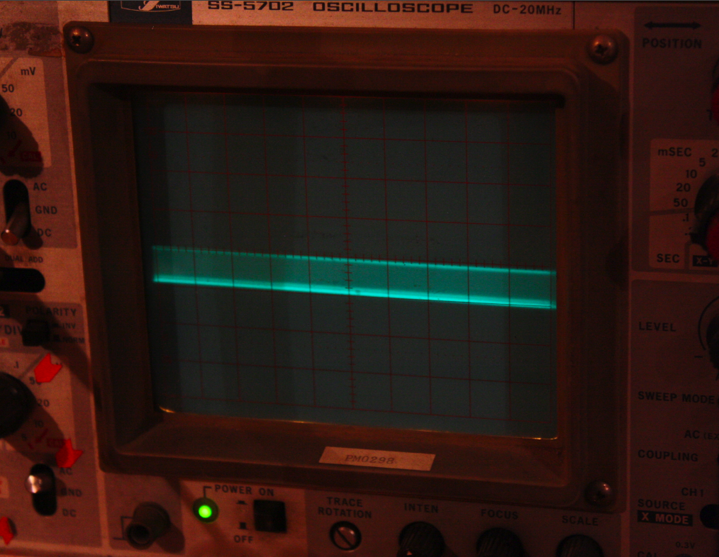

PostPosted: Wed Sep 08, 2010 4:08 am    Post subject: Reply with quote  Mark this post and the followings unread
getting back to this
d2-6 node is steady on -1.6v
lm311s are from same batch
i have some from another batch i can try and will do after posting this
When measuring A2 pin 6 there is no change when turning init or tune
here is a scope shot from that node
 Filesize:  1.22 MB
 Viewed:  544 Time(s)
problemchild
melbourne australia
Luka
Joined: Jun 29, 2007
Posts: 1003
Location: Melb.
PostPosted: Wed Sep 08, 2010 5:10 am    Post subject: Reply with quote  Mark this post and the followings unread
well as smart as i thought i was by using pin connectors on the transistors they were my downfall in this case. the bass of the connector was shorting pin 2 to pin 3 of A2 ie to ground.
i just de-soldered the area and put it back together and it is up and running
a good way to finish a frustrating day

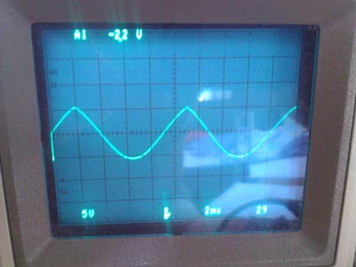

Just finished building my Teezer and fired it up.
At first glance everything seems to work fine.
When i started to calibrate the module i noticed that when the initial freq knob is turned full left or right the lowest freq i could tune in with the coarse knob is around 100hz.
Also when the coarse knob is turned fully down the VCO does not react to the signal from the V/OCT input anymore.
Please help Smile
Hmmm ... that's odd. As you reduce the coarse knob does the frequency get to 100Hz at some point and then stay there? (That would explain why the V/O input has no effect.)
Does the freq go to zero as you tune the Init pot through its midpoint.
Do the waveshapes look pretty OK?
Ian

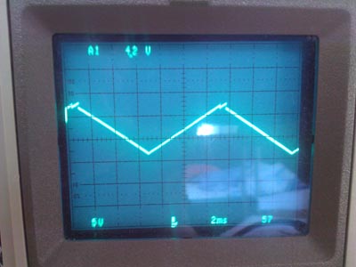

frijitz wrote:
Yes, that is exactly right.
Yes.
The Saw and Tri look pretty OK when the Init pot is turned left. When turned right it looks funny at the top.
The bottom half of the sine looks good. The upper half is more like a triangle.
Thank you!

frijitz
Joined: May 04, 2007
Posts: 1734
Location: NM USA
Audio files: 54
PostPosted: Tue Oct 04, 2011 10:09 am    Post subject: Reply with quote  Mark this post and the followings unread
OK, it looks like the waveshapes are OK, just out of adjustment.
The problem with the frequency range is probably in the expo converter section: A1a, A1b and the transistor pair. There must be a wiring error or a bad component or a solder bridge or something in there somewhere.
I can't say much beyond that. If you want to measure the voltage at the A1a output (pin 1) as the coarse pot is varied from end to end, that might be helpful.
Ian
