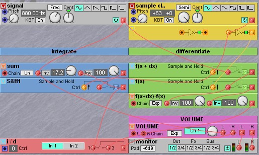

PostPosted: Mon Aug 23, 2004 4:47 pm    Post subject: Reply with quote  Mark this post and the followings unread
Now for differentiation, it is defined as:
Hmm we can't divide, but luckily we don't have to as we can't truly differentiate anyway (as it's a continues operation that we can't perform, we can only perform the difference operation, a time discrete variation) delta-x will be a small constant so we just have to amplify.
So what does it say, well we have to calculate the difference between a value at x and a value at x + delta-x. Then we have to divide by delta-x, which is a constant value so we can multiply by it's reciprocal.
So my original circuit idea was not quite right.
Ok a patch & a picture to illustrate, I'm not able to connect a scope (as my NM's are boxed into the radio thingy) but on theoretical grounds I believe the output signals should be phase shifted by 90 degrees with respect to each other.
The integrator should phase shift into the other direction than the differentiator does. The original signal is always on the left channel, the red switch selects either the i or the d signal for the right channel. I think I got amplifications and attenuations set to reasonable values, but it all depends upon the frequency.
Jan.
The web site the picture comes from is http://web.mit.edu/wwmath/calculus/differentiation/definition.html
An exaple for integration and differentiation

In discrete time sampled systems, the best we can do for differentiation is to take the difference between this sample and the previous one. The limit is fixed at one sample. Delta Y over Delta X, is just that simple.
Posts: 24475
Audio files: 297
PostPosted: Tue Aug 24, 2004 1:17 pm    Post subject: Reply with quote  Mark this post and the followings unread
mosc wrote:
Well, Jan. If you were integrating over infinite time, then you would be right, but in synthesizers we integrate over finite time.
? ... integration of an impulse over any finite or infinite period time containing the duration of the impulse will yield the area under the impulse as the result of that integration.
To not be able to integrate over infinite time is not a problem, as long as it is assumed that the signal to integrate was zero before the integration started the results will be correct. If it was not zero during that time a constant can be added or subtracted to compensate, in practice though it is reasonable to consider the signals to have been zero before the machine was switched on.
That we are dealing here with a time disctrete system is not really important, there will only be a very small error in the integration as long as the signals are reasonably smooth over the period of the system clock, which to me seems to be safe to assume.
