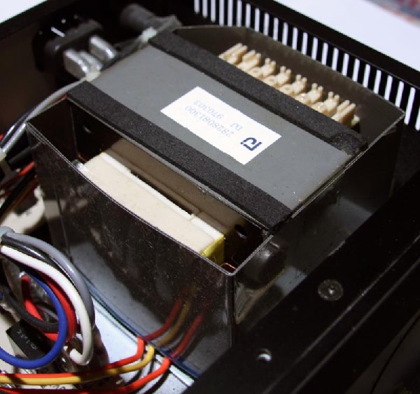

I just bought an amplifier from ebay, and the transformer is buzzing, I asked around a few forums if this was normal, and apparently it shouldn't buzz at all. I have a feeling the guy will not take this amplifier back, as the return policy says "The seller will not accept returns for this item.", and although the description said "Perfect working order" I doubt I'll be able to take it back as I paid cash on collection, so I can't raise a paypal dispute.
Therefore I'd like to know what my chances are of repairing this are, for as little cost as possible. When I power up, the buzz is loud then stabilizes, if I can put it to text it would look something like this... 'TZZzzzzzzzzzzzzz'
I've checked the earth continuity from the tip of the cable down to the chassis, and it is fine, If anyone knows a remedy, please let me know.

Transformer buzz is not that odd, and it will depend upon the construction ... likely things moved in transport casing it to buzz now where it didn't before. This is not necessarily a sign that something is broken BTW, but still it could be. In some devices the magnetic field of the transformer can interact with the steel of the case. You'd have to take a look to see what is causing the problem in your case. When the transformer is mounted with rubber dampers you might need to replace those, for instance. Or when you see something that is obviously broken you'd have to fix that. Maybe you could post some pics here.
Please remove the power before you open the amp! And when you need to reapply power while the amp is opened please take care to not touch anything that could be connected to a high voltage, when it's a tube amp high voltage could be anywhere, when its a transistor amp its likely to be only the mains connected stuff to watch out for.

Is the 'buzz' coming from the speakers - or is it actually coming from the transformer?
Loose windings in the transformer or de-lamination of the core could cause a buzz. You might be able to fix that by using some varnish on the windings.
If it's coming through the speakers it's probably bad power supply filter caps.

The transformer, hence the thread title - you can physically feel it vibrating Wink
The windings are not visible, there is an outer 'cage' welded to the transformer assembly, and the windings are wrapped in tape within this assembly. I will post a picture for clarification.
I was wondering if I could fill the whole assembly with rubber window sealant, or expanding foam (fire resistant, of course).

Ok, I managed to trickle some varnish into what I could see of the windings with a paint brush. However, no change to the buzz, I can still feel it vibrating too. Any other suggestions?
I presume from what I suggested in my previous post was not advisable, since nobody replied.
