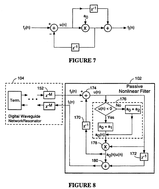

This regards patent 5703313 wherein is described a method of sound synthesis using a digital waveguide and a passive nonlinear filter at the reflection point.
I found this using Google's patent search at:
http://www.google.com/patents?id=6ZMnAAAAEBAJ&dq=digital+synth+waveguide+passive+nonlinear+filter
Since it's patented, it can't be used for profit, but nothing stops us from implementing the device ourselves for our own use. The patent description claims that in some way or other, this invention relates to physically modeling of gongs and cymbals. There is text regarding the "transfer of energy to higher frequencies" using this passive nonlinear filter (which is quite simple structurally).
Figure 1 shows a very simple setup with one wavegude and one filter, I like simple. I'd imagine that it doesn't do a cymbal, but it may still be interesting. Figure 2 shows what looks like a waveguide mesh.
I am strongly interested in this - has anyone else played with this?

As usual, I haven't had luck with this. I have the project modified to include the nonlinear allpass filter, but it doesn't work yet. Not sure why, so I will have to make a model using C which might be easier to troubleshoot. It's acting like the sign of the first summer is not changing so it selects only one of the two a0 parameters supplied. As such, there is no transfer of energy to higher frequencies. I also need to read, yet again, the patent description, especially paying attention to the "termination" of the waveguide system to see if there is an attentuator built in - because my system does not die out over time as a cymbal or gong would.
Also, the diagrams in the patent description show two delay lines used for the waveguide. The model I'm trying to implement is a single delay line waveguide a la the simplified Karplus-Strong model. Not sure if that's an issue because the model I have inverts the sign of the signal at the termination point. This is meant to halve the amount of RAM required to implement a digital waveguide for Karplus-Strong models. The inversion causes the waveform to flip over every half cycle (which I can see on the scope) and that sign inversion should cause the allpass filter to select between the two a0 values I'm supplying.
So I will do the C simulation (which will make a sound file) and see what happens. If that works, it should give me some insight on what the hell is happening here.

I just got the C version working - and I found the problem and noticed another characteristic that I hadn't considered.
The problem was that I read the filter's block diagram and didn't see a minus sign for the leftmost summer (see diagram). I also hadn't considered that the output amplitude could exceed unity, so I will have to limit the amplitude of the excitation input to prevent the output from a "peaking" condition.
Next is to go back to the Verilog and try it again.
While writing the C version didn't actually fix it - it forced me to look at the block diagram of the filter again which is when I discovered the minus sign I had missed before.

The C model so far seems to be doing what it should. The patent's description of the nonlinear passive allpass filter points out that the total energy is preserved even as energy is converted from lower frequencies to higher frequencies. Without any sort of attenuation in the waveguide's loop, the system will resonate (theoretically) forever.
There is also no detail that I can find regarding the "TERM." component which I assume means "terminator". The sound of what I get from the C model is anything but musically useful IMO. Currently, the "TERM." component in my C model is a unity gain sign inverting reflection point. I'm considering replacing that with a single pole lowpass IIR filter to force the system to lose energy as would be the case in any natural vibrating object.

It just occurred to me that my current excite method may be a problem. I'm using a square inpulse - lots of harmonics to start with. Perhaps something more band limited, even an exponentially decaying sinewave at the waveguide frequency. No matter what the input spectrum is, the filter will always try to move energy from lower freqs to higher freqs.
I tried a flat attenuator which mainly just makes the resonance die out.
I know I need to try a lowpass filter, with the nonlinear filter's output energy moving up spectrum, a lowpass will allow the system to have a somewhat controlled loss of energy. The higher the frequency energy generated, the more it will dissapate. I'd have to assume that it might take getting parameters "just right" for this to be useful.

Usually it works best to excite with a short impulse, or a noise burst, then the wave guide should be allowed to build its tone from that.

Yeah, that's certainly true for a standard K-S string model, but this experiment has a nonlinear allpass filter that causes a redistribution of energy from low frequencies to higher frequencies. My current model doesn't yet have a lowpass filter.
Since the system had only a flat spectrum attentuator, it's spectrum keeps going higher. Surely that's giving me a Nyquist headache at least.
In a K-S system, there's a lowpass filter which causes the resonation to "lock" to a lower harmonic, usually #1 and become more and more sinusoidal at that frequency. That's why I'm going to add a lowpass to this.

After adding the single pole IIR lowpass filter, I get something more expected. It seems to resonate like a string except that there is a more metallic timbre, like a bell and I can hear that the resonator is favoring harmonics of the waveguide. As I open the lowpass filter bandwidth up, a higher harmonic (or likely a set of higher harmonics) is obvious.
I'm attaching a sample wave file from the C model with both filters.
EDIT ADD: I have deleted the old sample because I noticed that it had what I would call alias artifacts especially in the first part of the sample. I believe this is because the excitation impulse was a simple rectangular impulse with no band limiting. Since the nonlinear passive allpass filter will transmute energy from lower frequencies to higher frequencies, it should make aliasing worse, especially if signals start out with harmonics that are already at high frequencies.
The new sample uses a triangular impulse which does not appear to present the alias artifact problem, but it still demonstrates this waveguide system nicely. I hear a strong 3rd harmonic as well as other upper harmonics that seem to resonate much longer than with a plain K-S system.
Ultimately, I think that this method of generating sounds is rather problematic. The idea of using a nonlinear allpass filter to move energy from lower frequencies to higher frequencies seems counterproductive in a system that should have a bandwidth limited at the Nyquist frequency. Once a harmonic or partial has attempted to pass Nyquist, it is automatically wrapped back below Nyquist and usually presents itself as something undesirable. In the case of a nonlinear allpass filter, there is a constant movement of energy upward in frequency, so the chances of attempting to pass Nyquist are great. The bell-like character of this particular system is more apparent as the lowpass filter's bandwidth is extended, but that also allows the nonlinear allpass filter to present frequencies that could attempt to pass Nyquist. The sample presented in the attachment uses a sample rate of 512 Khz and even at such a high rate, alias artifacts can still be apparent. Only very conservative settings of the lowpass IIR filter seem to mitigate that at the expense of the "brightness" desired.
A better approach to enhancing harmonic content might be to use a 2 or 4 pole resonant IIR filter because there is no movement of energy to higher frequencies. The resonant peak provided by the filter can be used to enhance particular harmonics, but it must be tuned correctly to do so.
